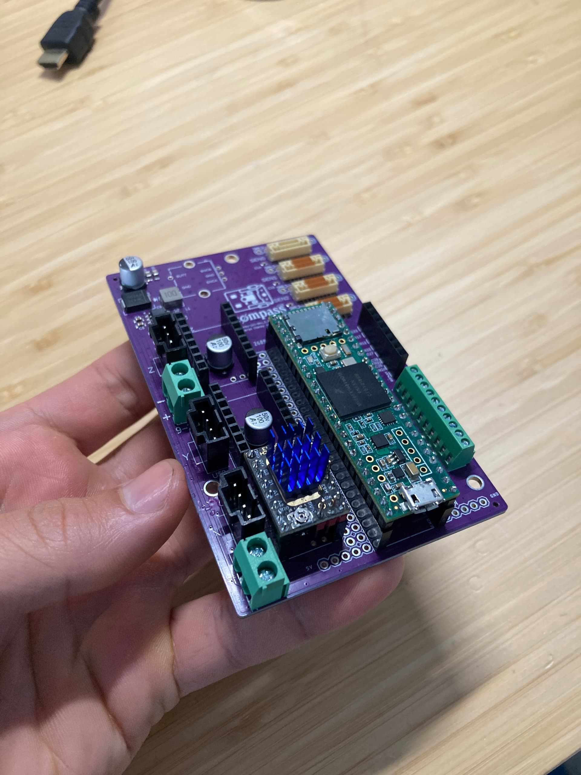

I want to adjust this PCB so that I can get all the through hole parts wave-soldered. The only issue with the current design is that I am using components to represent the footprints of the Teensy and the TMC2209 boards. That’s nice so that I easily move the layout around without worrying about messing up the footprint. But, when it comes to manufacturing, now I can’t assign headers to these rows.
Anyone know of a sneaky way to make a component with sub-components? For example a Teensy component that has two 24x1 female header sub-components that load into the BOM and PnP automatically. Or do I just have to make use individual header components and make sure they stay in the correct position on the layout?
I’m using Fusion electronics which may be limited… Definitely considering moving to another software for the next iteration.
It’s obviously not essential—just curious to see if there’s a better way to do it :slight_smile:

Ah, so your issue is that you’ve only got a single logical component but fundamentally it’s 2x sub components? With my CM I’d just send a note explaining it and they’d adjust it on their end. Alternatively you can sometimes play games with marking some components non-BOM so they don’t get populated and others as mechanical so they don’t have a PCB presence. That’s a bit ugly. Another option would be to do them manually.
How I’ve done it in the past is to make a non-BOM ‘alignment’ component where there are markers for the pins/pads on a mechanical layer and whatever extra silkscreen I needed. I think import the actual parts and place them using the targets from the alignment component. It’s a bit more manual but within Altium I can just choose to either make a component group or union which keeps them fixed in location relative to one another.
From what I’ve seen, EasyEDA is good but it’s still fundamentally quite a basic tool. KiCAD seems to have a lot more of the features that would be found in higher end packages so that’s where I’d be going if I were looking for an alternative to Altium.
Fundamentally, though, if your BOM has the right components on it and there are obvious footprints, these boards will be hand stuffed so chances are it’ll just work out.

This sounds like the way to go for me.
