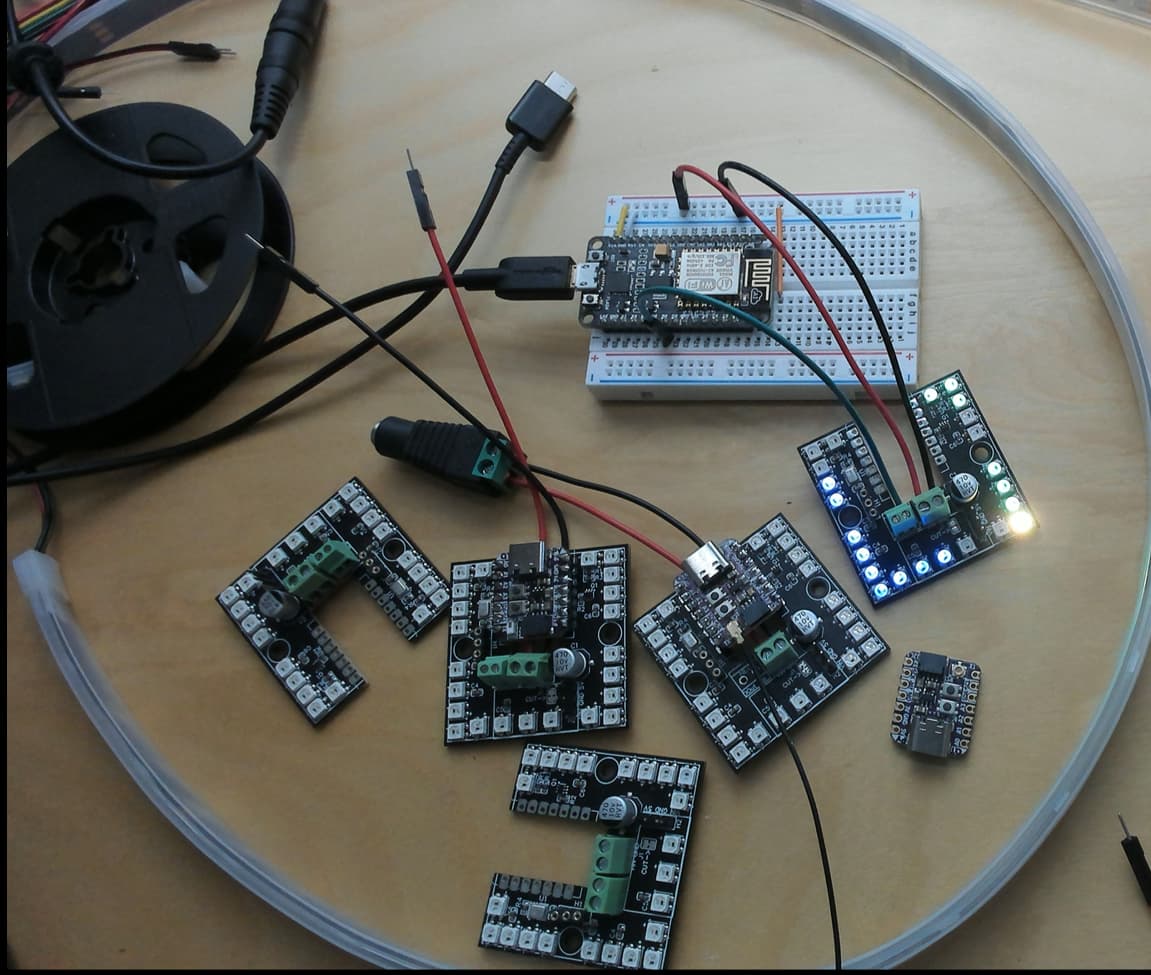

Is it a good or bad idea to use multilayer GND pads, to 1) connect to ground plane, and 2) also be a ground pad for SMD LEDs? Wondering whether I’m risking poor connection, and whether solder could wick into the multilayer pad’s hole? See pic, left out copper pour so easier to visualize.
Also, this is my first custom PCB board, so general constructive ridicule is also much appreciated!
Am using EasyEDA to update my dimension constrained 2 layer PCB that’s crammed full of WS2812B-MINI 3535 RGB LEDs. Cramming as many LEDs as I can around the perimeter.
This v2 revision has 0.6mm or larger traces where possible. Reason is my v1 boards (assembled by JLCPCB via their SMD service) used 0.254mm signal traces, but they don’t work… Observing flickering, and non responsive LEDs, fault location(s) varies from board to board. Many LEDs have non functioning R or G or B colors, or don’t light up at all but still transmit data to the next LED, maybe… Don’t have eyes or microscope powerful enough to inspect LED’s internal wiring. However, applying manual pressure at different points onto some misbehaving LEDs can momentarily cause them to function. This makes me suspicious of the LED quality. Currently using WorldSemi WS2812B-MINI 3535. I’d try SK6812 but jlcpcb/lcsc don’t have stock for needed size. Contemplating redesigning board with 5050, but layout will be trickier because I can’t change overall board dimension, has to fit in an existing housing.

Your question could maybe be stated “Can I get away with a regular non-filled via under an smd device, vs paying for via in pad processing?”:
It’s generally not a good practice. Besides solder wicking in, flux and other materials will off gas if it is not filled properly. The result could be hard to predict. Maybe there is still room to be had somewhere without going to 5050? Maybe going to 3-layer is warranted here?
LOL @ running 0.254 traces everywhere. You definitely aren’t the only one… I did the exact same thing on the first project I sent in to a board house, and it had traces carrying ~2A max. It worked, but not the best (this was an analog fan controller). Getting all the gerber files sorted can be a pita at first.
I haven’t ever seen the vias in the pads like that. I have seen vias be a tiny bit proud of the surface, but not on professional boards.
The ground fill should let you put the via almost anywhere, right?

jlcpcbsupport acknowledged they can fab multilayer pads, but will increase risk of assembly failure. So, avoid if possible.
Short: Use jlcpcb’s “Standard PCBA” assembly option with 240 reflow temp when using WS2812B LEDs. Explicitly check datasheet reflow temps being used by assembly service.

Just realized jlcpcb PCB assembly service, by default is “Economic PCBA”. That service lists the reflow temperature as 255.
However WS2812B datasheet reflow peak is 240 :man_facepalming: So, guessing many of the LEDs were overly cooked.
Fortunately jlcpcb assembly have a “Standard PCBA” that you can optionally select with reflow temp of 240. So, will explicitly use that next time…

Reflow temperature isn’t the only problem. Relatively cheap $30 USB microscope is revealing, and more useful than expected.
But of course, only the 1st of 23 LEDs in the chain is missing an internal GND pad :man_shrugging:
