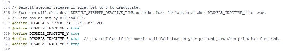

You can try adding M84, but are you sure there is nothing you can do to cut down that time? Does your step over need to be so fine? Also a small test might prove the 18 hour estimate is way off. Sorry, thinking off the cuff here. If you have to use the code as is, I would cut it into multiple jobs/files and add a homing sequence in there. Good question, I have never tried this sort of thing. I don’t have that kind of patience.
[attachment file=“KD disable.JPG”]
This sounds interesting. How would I do that? Literally hack 1/5 of the gcode, making sure to retain the start and finish gcode and away I go? That could work if I can’t get the stepper to hold (and would save me in a power failure - but we don’t have those much at all).
Your stepover question is valid…with a .6mm bit what on earth do I need 15% stepover for? If I’m 18 hours at 15% I should be around 8 at 45%. I’m gonna try that right now.
Re: the disable screenshot (thanks for that by the way)
Should I also set the DISABLE_INACTIVE_Z to false just to be sure?
Well, I’m still gonna give the infinite pause a try but changing the stopover to 45% knocked it down to under 5 hours! Gah!

0, and false would be what I would try.

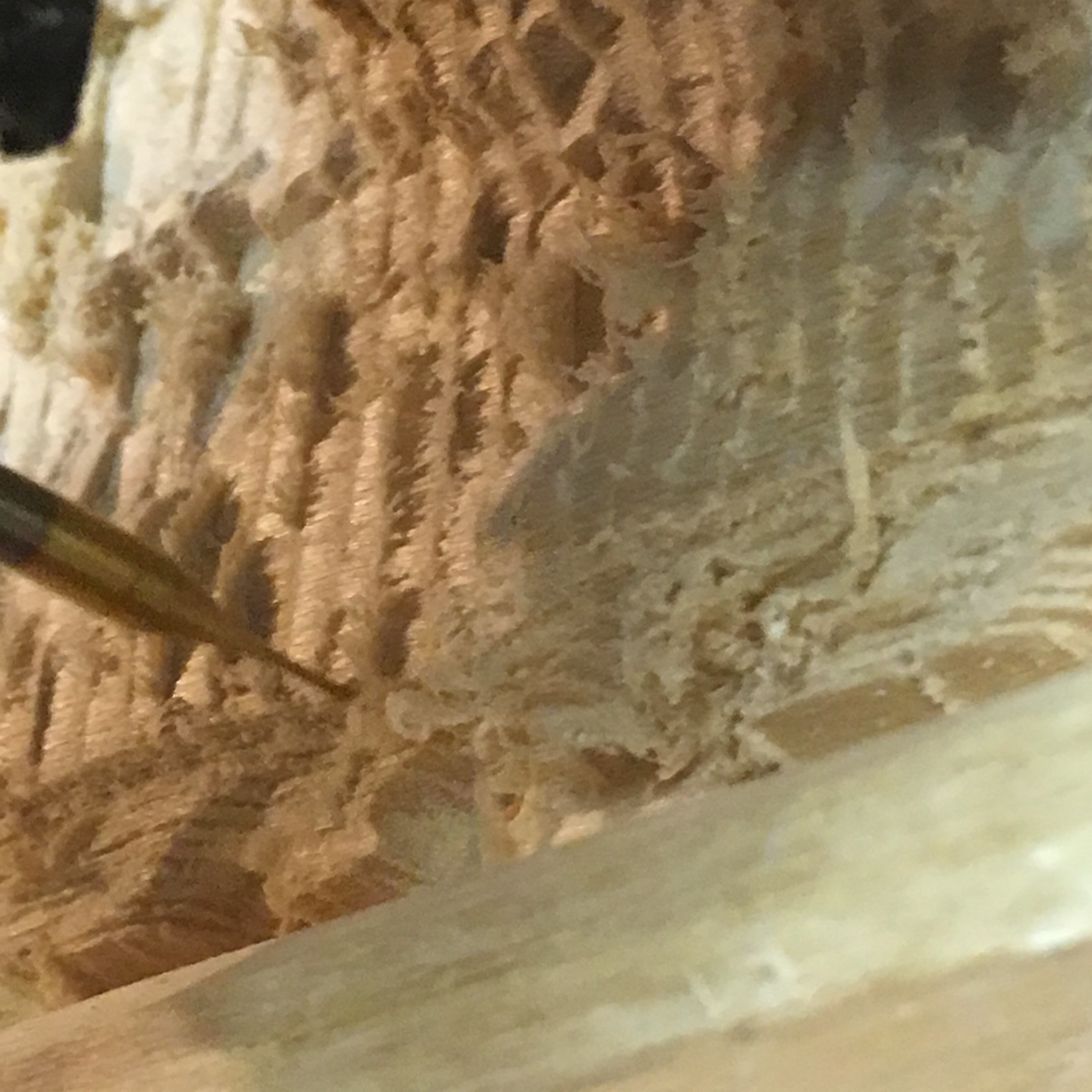

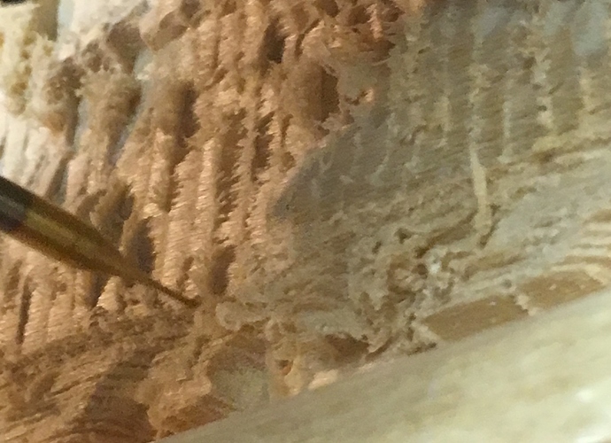

And that’s the clincher. It isn’t dense which is too bad. This is basswood. And it’s not a ball end which would help too. You can see the lines forming. However - very excited at what the next 5 ish hours will bring!
I can’t believe these teeny cutters don’t snap. [attachment file=98394]
Ah! Hahahaha. Guess what broke when that was uploading…
I’m doing a semi-finish pass now with .2mm allowance to get the real knobby stuff off using a 1.5mm flat. Then I’ll try slowing down the federates on the .6mm bit and running off the .2mm allowance left behind. The semi finish pass estimated at 1h 20 min. A worthwhile step I think.
