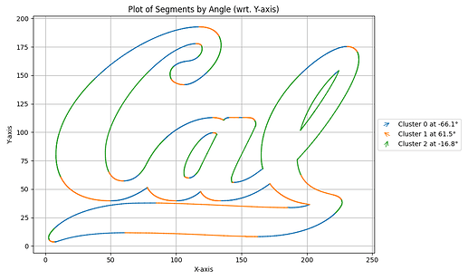

There is another layer of complexity added to this path planning when taking into account the current design of Compass, which only has two axes of correction. This means that the third axis is controlled completely by the user, making complex cuts a little more tough - though not impossible - to perform. The problem boils down to the router being limited to a certain angular range of points in front it. If you imagine wanting to cut a straight vertical line, that is no problem: as the user moves it forward, the motors don’t have to move the tool at all. If you want to cut a line that is tilted, though, the motor has to move faster to keep the tool on track. As you keep tilting that line more and more, the motors reach a point where they can no longer react fast enough. This makes it so that the device essentially has this ~90º FoV in front of it where it can cut:

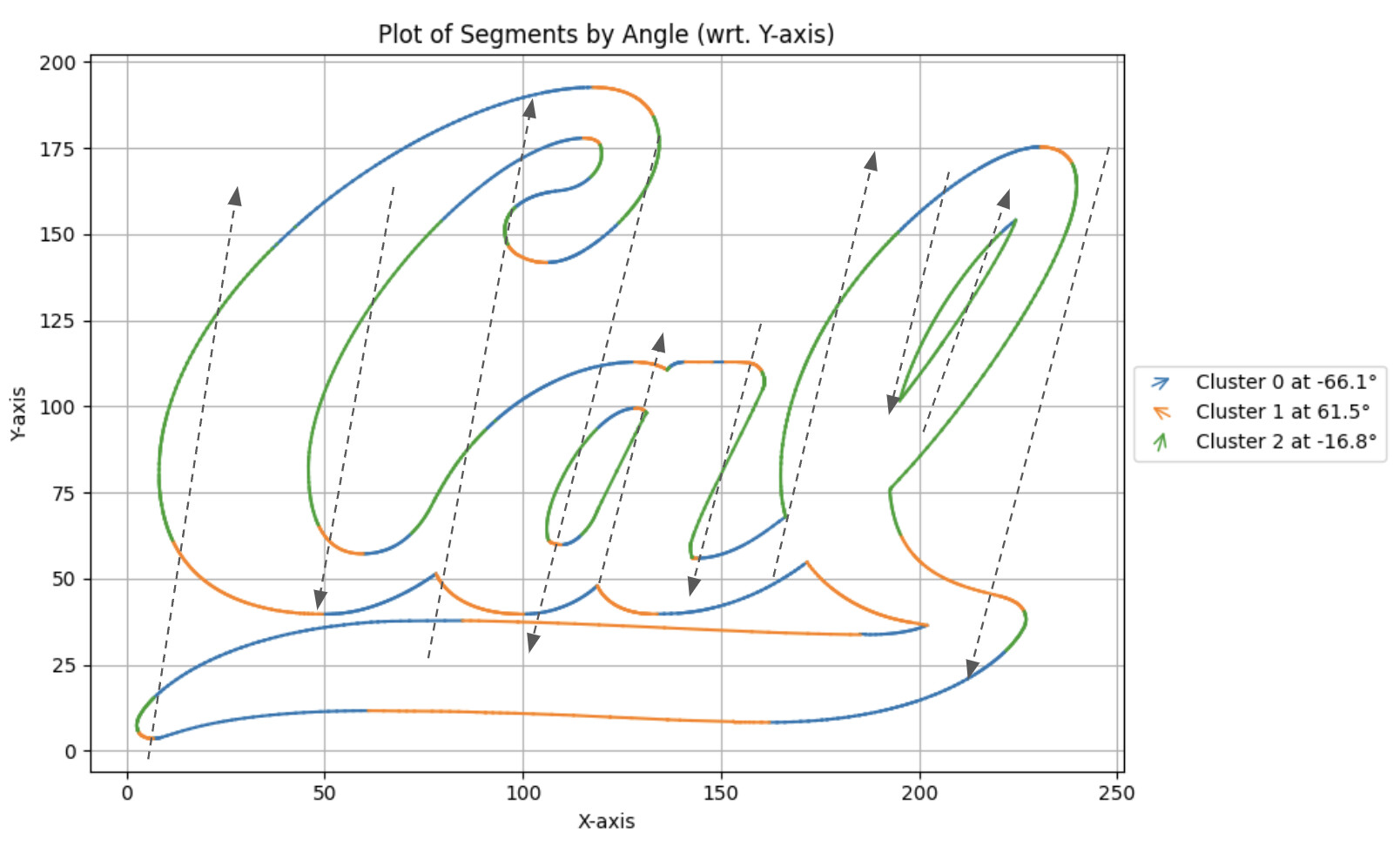

The 90º number is a little arbitrary because it really depends on how fast you’re moving the router, but at a normal operating speed, that is a decent bound. This doesn’t mean that the router is just limited to straight lines, though. When cutting a circle, for example, you could continuously rotate the router as you move, keeping the correction axis perpendicular to the circle’s tangent as you go. You could also cut half of the circle by moving the router forwards and backwards, and then the other half by rotating the device by 90 degrees and moving the router forwards and backwards. This second approach can be generalized much more effectively to any arbitrary design. You can split up any design into a few angular zones that can be cut by the router using multiple back and forth passes.
I’m using an iterative k-means approach to group all the lines of a design into the minimum number of clusters possible. While this isn’t 100% perfect, it works pretty well. The next step is to split up each cluster into passes for the router. This is an example of what that might look like for cluster 2:

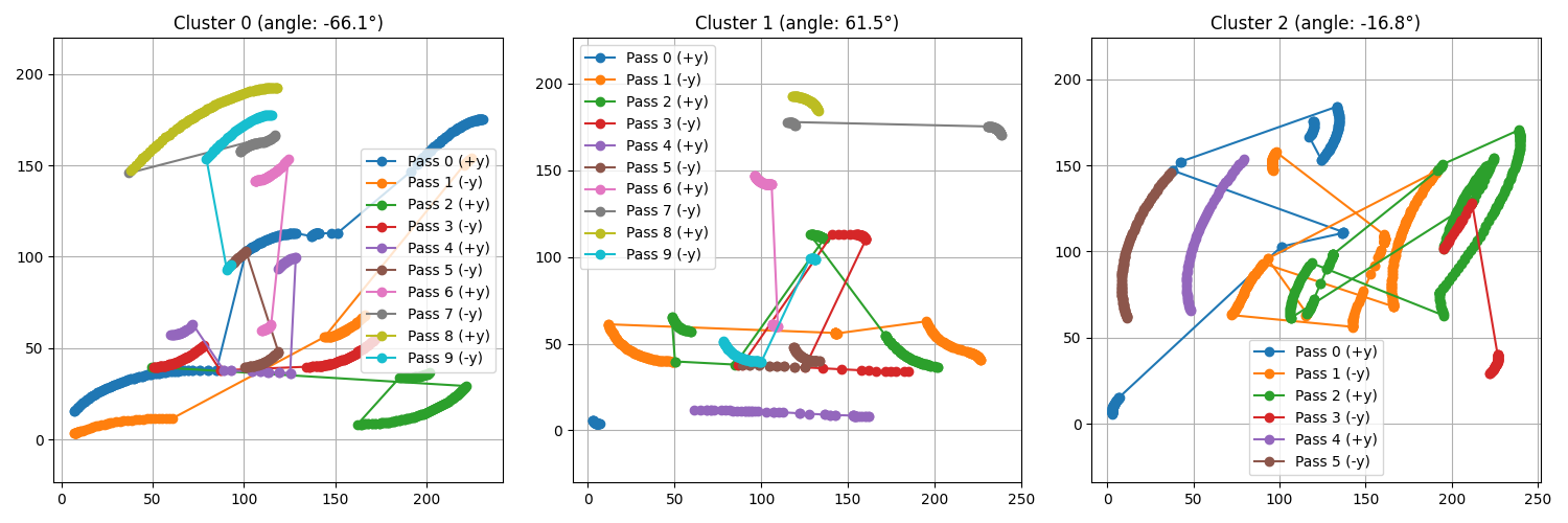

The tough part for me right now is automating that in software. I’m getting a bit of gobbledeygook at the moment:

It loos pretty good. But some of the things that are there that I think shouldn’t be are probably travel moves. You want to remove those first. You can determine what is a travel move in most gcode because the tool moves up to the clearance plane in Z. Some CAM even makes G0 only for travel and G1 only for cutting (most should support that, honestly).
Also, I think you are probably already doing this. But you should start by converting the gcode to line segments, not vertices. They look like points, but they are lines defined by the previous point. Except for arcs (G2/G3).

Yup, I am. Also I’ve just decided to use a post processor without arcs so I don’t have to deal with that hahah. I think some of the bugginess is coming from when I try to combine the lines back into points at the end to sort them into groups. It’s definitely a bit of a whacky approach. But it shouldn’t be too hard to clean up.
