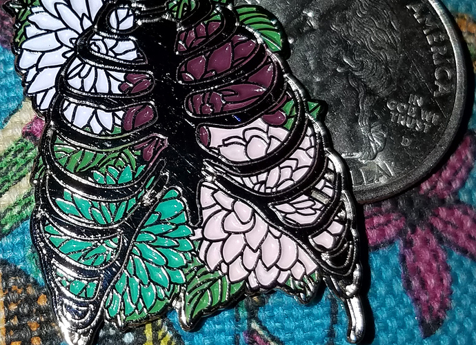

I come from a recent background in 3D printing and I’m just about done with the printed parts for the MPCNC. I hope to do very, very fine detail with it in materials like aluminum, PCB, and (hopefully) brass. I’m worried about the maximum resolution even after seeing some of the work done in the gallery section and the PCB threads. Here are my specific questions:

Lastly, am I worrying too much? Am I expecting too much? Here’s a picture of the kind of the highest level of work I hope to do:
[attachment file=58626]
Can I get some pics of your finest detail work in here? Post them up!

Most people are actually going for giant parts, not so much for detail. I think it could be possible, use stainless and build it small to make it easy. Make sure your spindle and endmill have low runout.
Super high detail with a laser and I just plotted a crazy high detail plot. If you use a nice vbit you could get real sharp lines.
To give you numbers I had to increase the arc resolution to .15mm per segment. Detail is possible and should be relatively easy, most just want giant aluminum parts (or at least they always ask about it)…

0.9 degree isn’t really needed, we currently have a theoretical resolution of 0.001mm or 0.0005mm depending on your step rate.

You are kind of chasing the wrong question or answer.
At great details it comes more down to physics and skill than electronics. Every decimal place of precision adds several zeros to the price tag. Carving at great detail (or all carving really) takes a lot of skill, as much as it does great hardware. That is a reason jewelers carve a wax ring and cast it instead of just carving out the ring, either way it still needs to be polished but the harder the material the harder the Gcode is to make.
