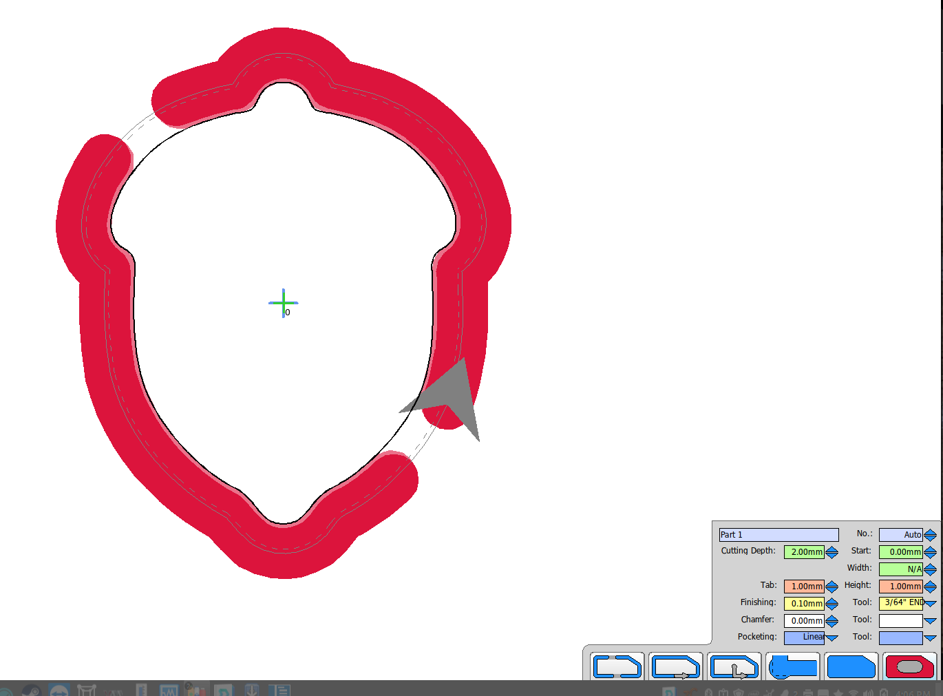

I started with inkscape using symmetrical paths. It Looks symmetrical in inkscape. The part cutout also looks pretty good in Estlcam. So it appears to be the cutting I think.

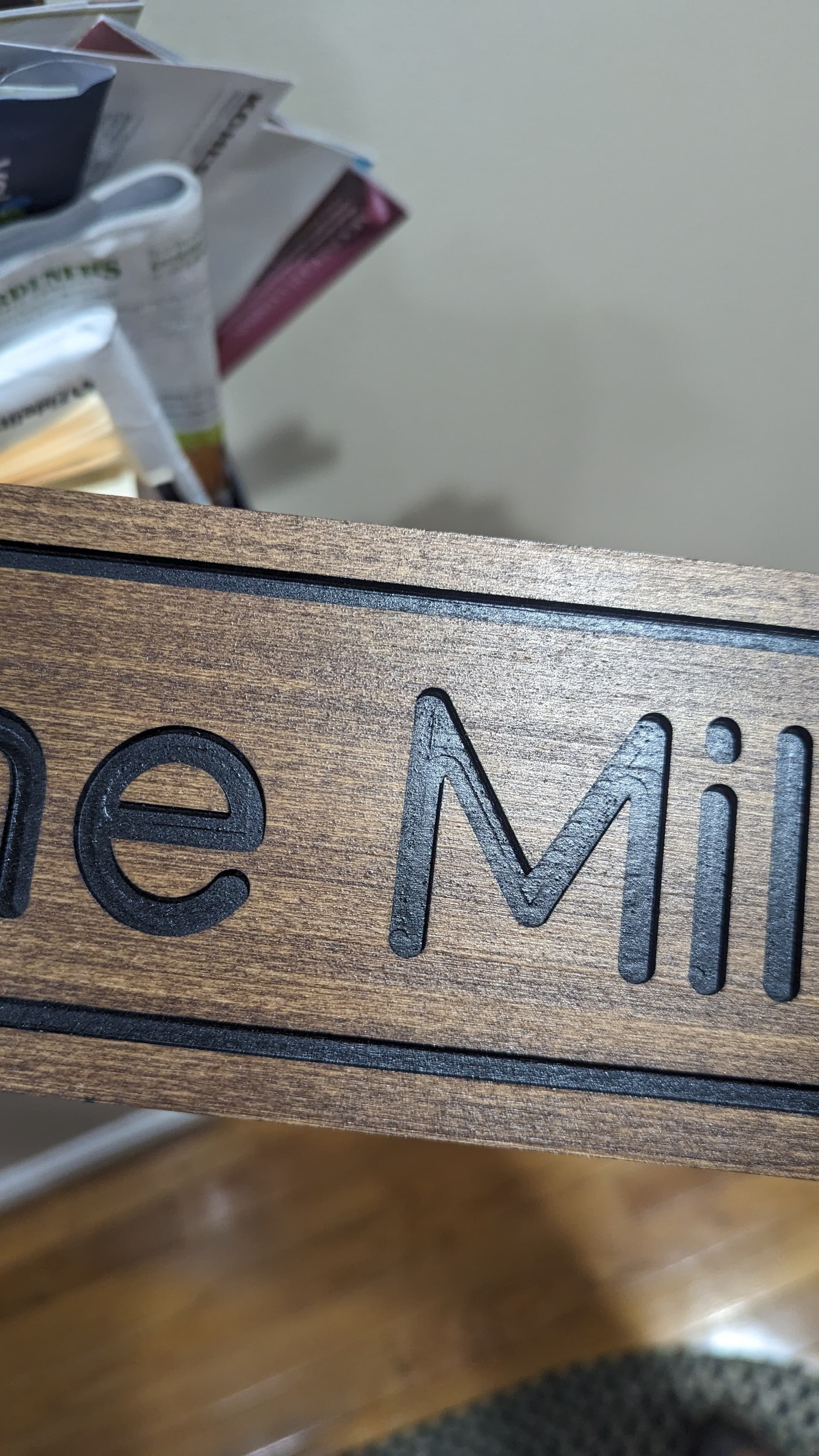

Other causes and tests? Could something out of true need tramming up? THings are cutting really well and letters look great. I have never done a leveling.

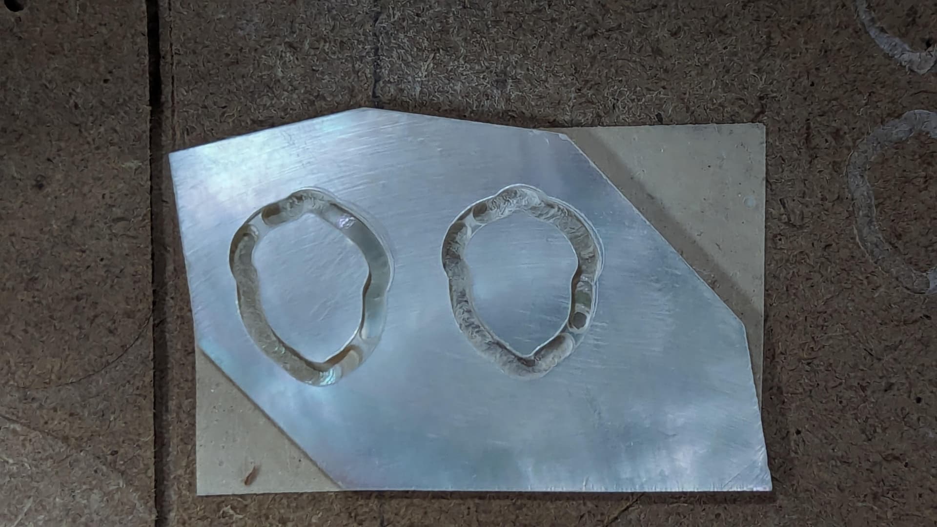

shows the pocket is much wider than the part cut, but you can see it is fairly symmetric part in this one.
here they a bit wider parts 0.5mm wider and not symmetric. Like they are smushed to the axis of the tabs.

I am doing conventional (I think, never changed it) cutting. It is going counter clockwise around the part (not bit spin). BTW I did measure the bit is about the true size. 3/64" but accuracy with calipers at this size is a bit iffy. I’d have to test again to answer what happens if I remove the finishing pass. Thats another test. But… the finishing pass is only 0.1 mm which leaves 0.2mm total thats a bit light for 0.5mm unless the bit IS off in diam.

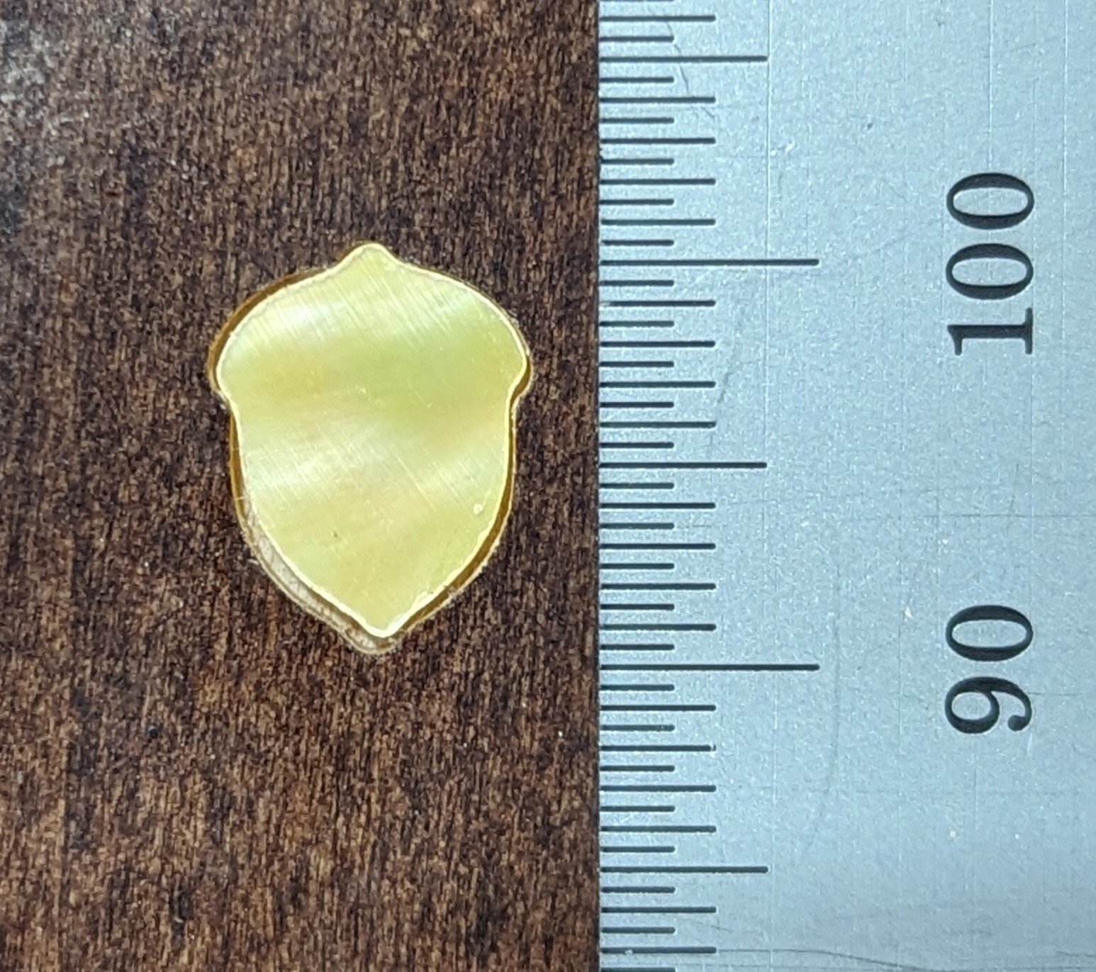

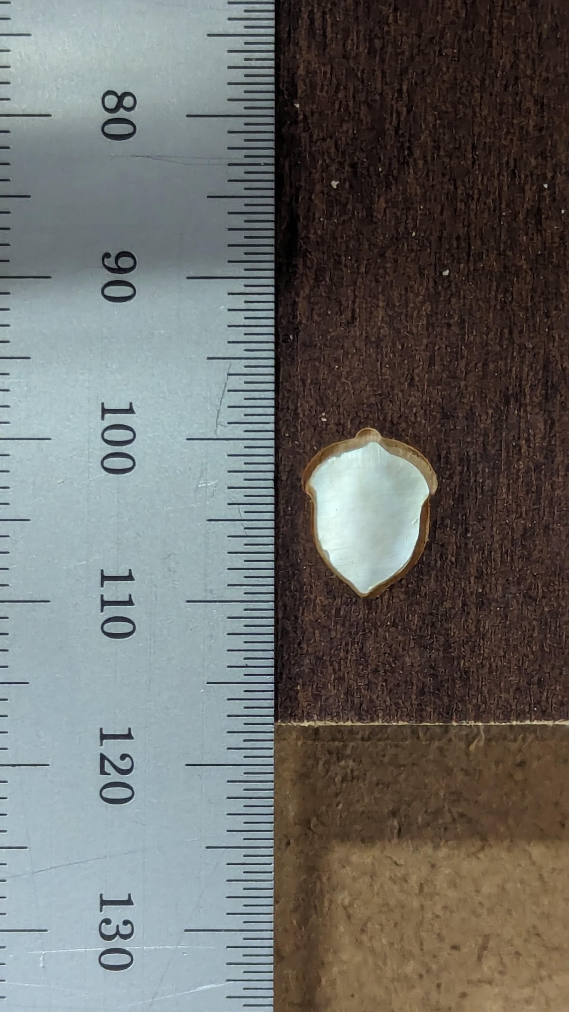

This shows the result with ruler in 1 mm and 0.5 mm increments after I filed off the tabs on the bottom of the acorn sides.

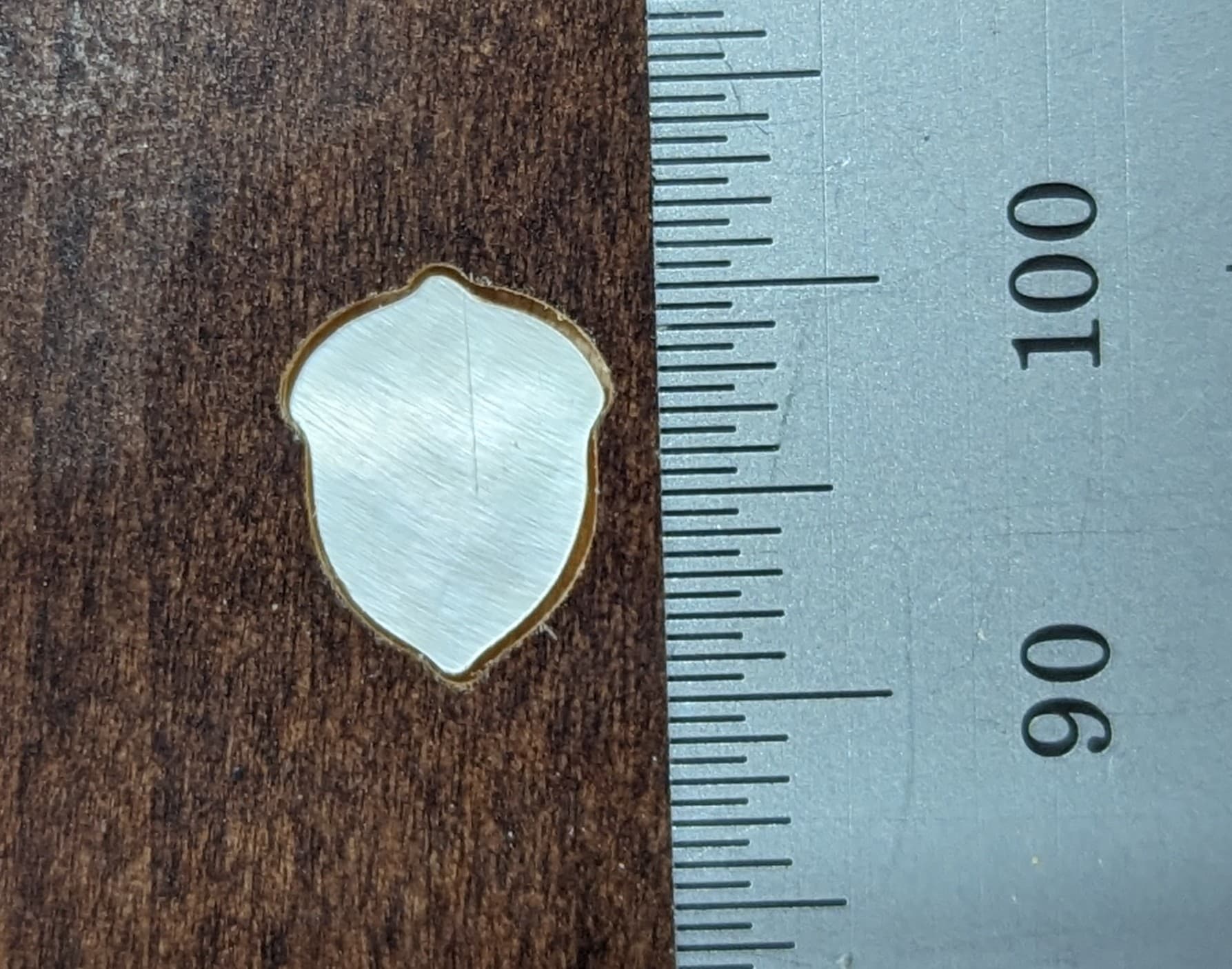

Flipped over to show the symmetry works pretty well now. I’ll have to keep an eye on this.
When I looked at this in the shop it looked awesome. It fits great to the naked eye (without glasses). But looking at it again here, it is still like maybe 0.7mm off total? I thought about it and figure it the bit entry it too small vs actual diameter, estlcam would make the pocket wider than expected. So I could make the bit meansurement entry a touch wider and see if it closes. I could see that maybe the the but could be as much as maybe 1.06mm max…055 inch (1.4 mm) → .06 (1.524mm). Thats only a difference of ~.124mm per side of cut so max ~.25mm. Which doesn’t look like enough. I don’t think mismeasured bit is enough to fully explain this.
