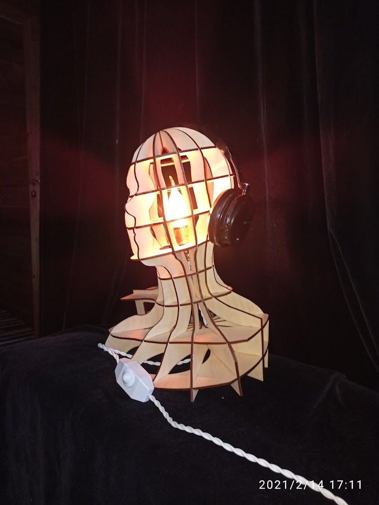

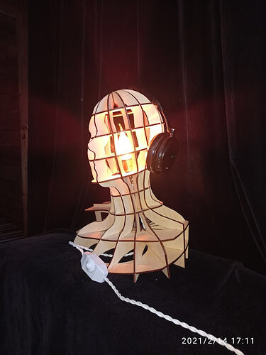

If you already have a 3D model, take a look at LuBan 3D. Its Stack function converts the model into layered slices, while Hash creates an interlocking rib-style structure.
I used the Hash function a few years ago to make lamps like the one in the photo. You can adjust the material thickness, spacing and overall size, then export the parts for CNC
