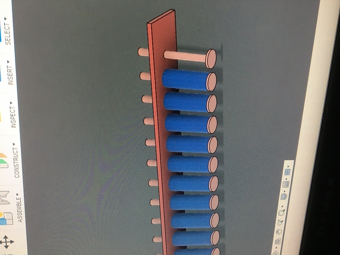

I drew this up quick with my coffee this morning. Not to scale or complete with details. It’s just to explain the concept obviously. No vacuum required.
The blue parts are a soft foam. The rods are retracted into the plate to compress the foam and grasp the cup. The design could benefit by having a taper on the end of the foam to guide them into the cups among other things.

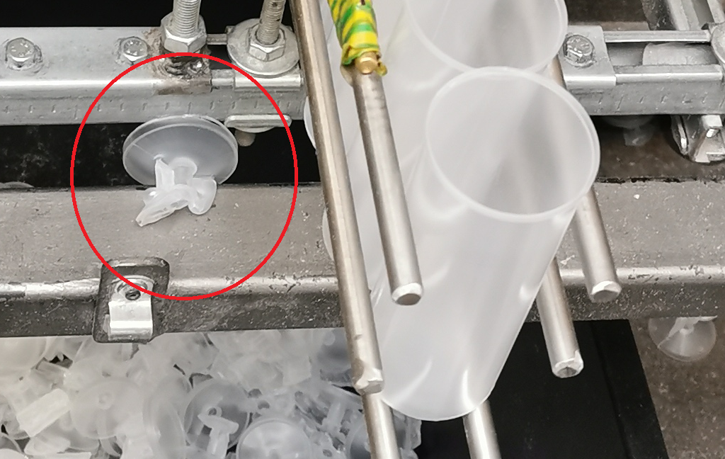

Can you describe in more detail the defects that you are trying to reject? Are you saying the cups are sometimes squashed at the top? From an earlier post it sounded like perhaps they can have holes in the sides which is also a reason to reject?
I think that would be a good idea for heavier stuff with a lower center of gravity. Here the cups are very lightweight, tall and narrow, they have a really high chance of tipping off.
Yep.
I’m not sure what do you mean by that?

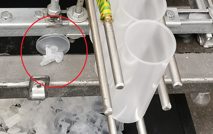

What would be a non opened cup and how would this happen?
I think they are saying that sometimes the lids stay attached, so if you had one cup with a lid, the cnc would just clobber them. So you would need to filter out the cups that still had lids first.
Ok, I guess it is that thing we can see on the picture here?
Well if that is the case I believe it is extremely easy to mechanically sort it out, that thing will be higher than the other cups so you just need some kind of thing that hits it and pushes the defective cup out of track. If the cups are ok they wont hit it and continue on their path, if they aren’t they’ll be removed. No need for any fancy stuff, a simple air cylinder or even some kind of triangle shaped thing can do that without any control circuitry. The metal guiding rods just need to be lowered at that point so that the defective cups fall over.

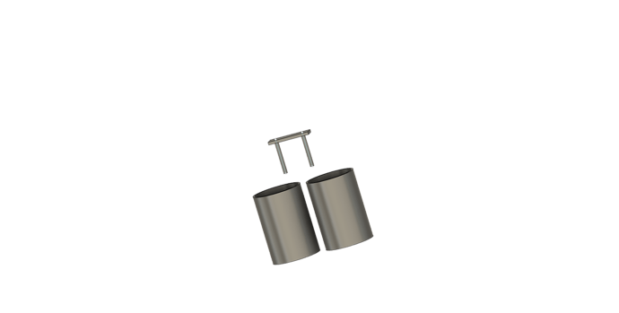

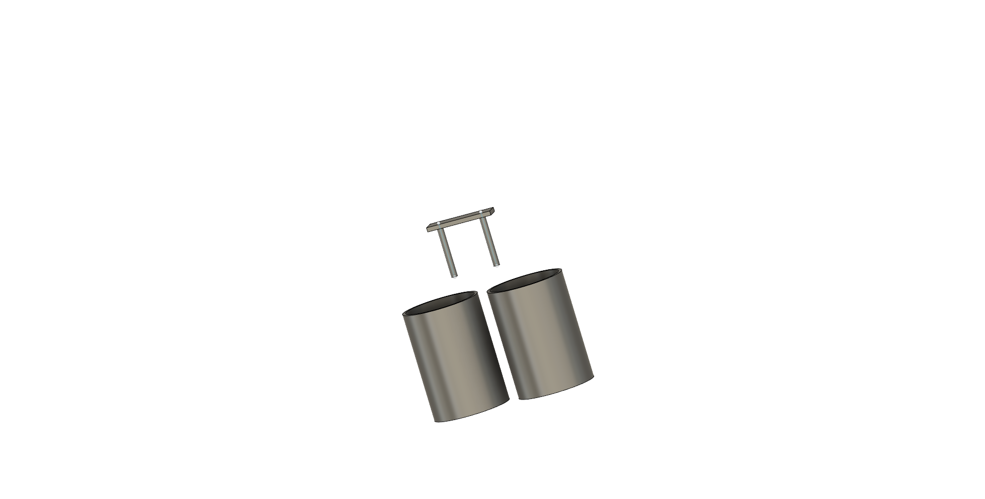

From my cursory look over thing here are my thoughts. Some sort of fingers to close around the vessels will need space on each side to open and close. I know vacuums are used in PnP machines, but considering the depth the vacuum nozzle would have to enter the vessel I think you would be better off with a mechanical toolhead.
You could possibly use some sort of straight gripped fingers that close on the adjacent walls of two vessels. I’ve attached an example of the image I have. The fingers insert into two adjacent vessels, and one finger closes to bring the walls of the vessels touching. This would have the benefit of not deforming the sides with too much pressure, and the containers would be touching when released.
EDIT: You could also probably synchronize all the “moving” fingers with a single motor.
