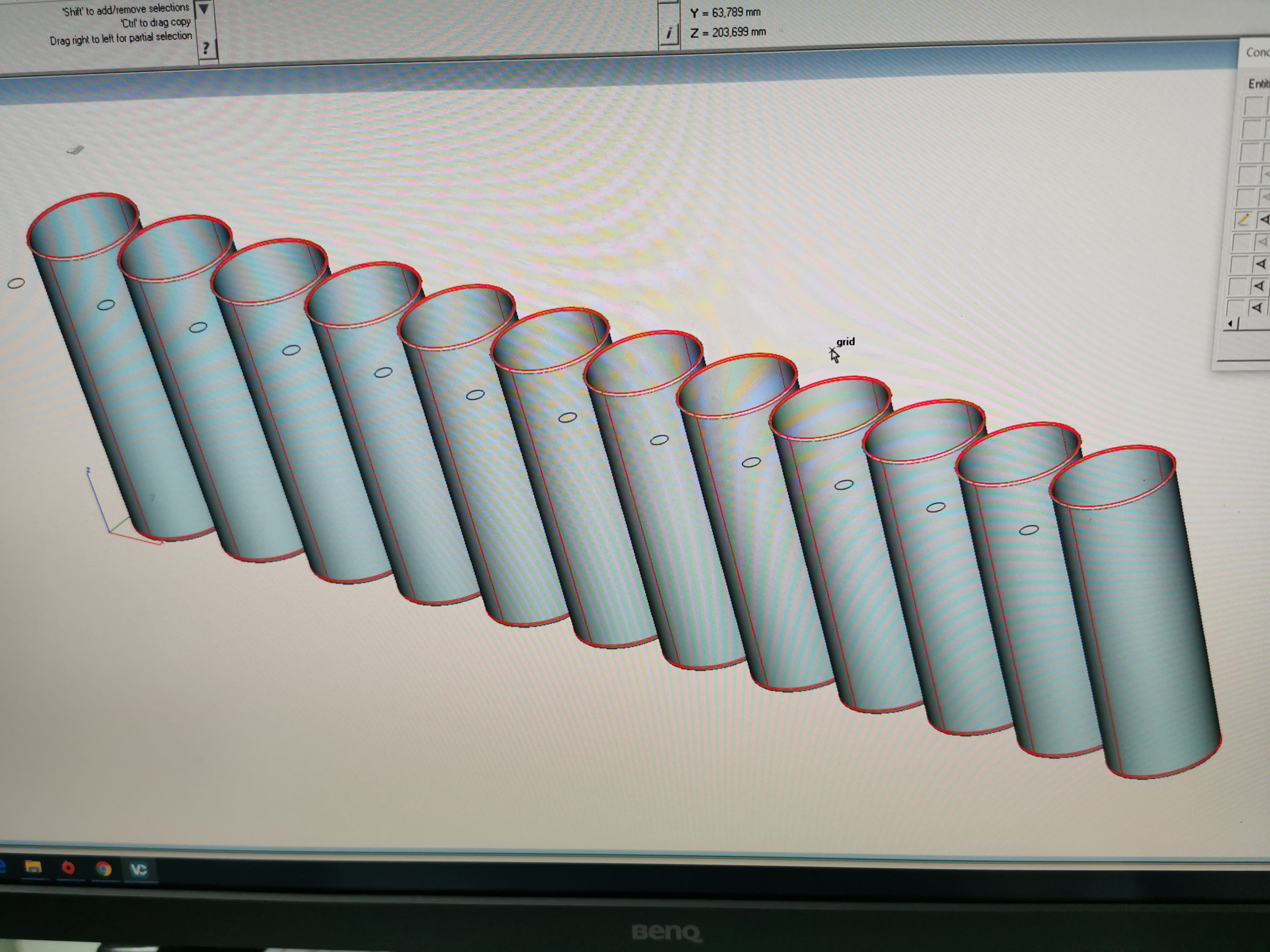

So this is a row of 12 cups {one of the cups we produce}. The target array for this one is 12-11-11-etc. This repeats to a total of 20 rows. The cycle time is about 12s for every two cups.
If this align with some spacing it’ll look like on the picture. (I didn’t draw the prolongations of these 6 bars that keep them in place.)

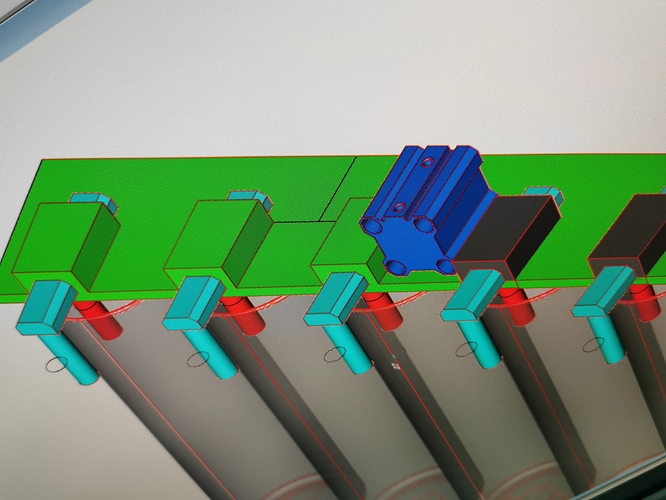

Because the surface provided (card board tray) is relatively uneven they need to picked and placed not pushed. I envision something like this.

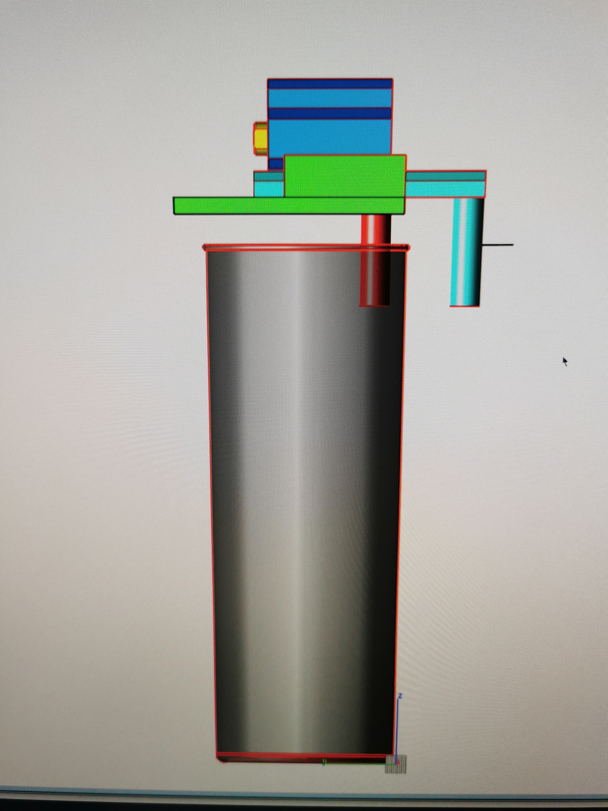

Mounted to the Z axis is a double carriage across 800mm (leaving only 100mm for x-travel but that is ok). This static bar is shown in green.
From this static bar there are protrusions into the cup shown in red.
Inserted in 3d-printed ASA guides are these fingers in cyan. In their default position there is a 20mm gap between the red protrusion.
To actually move these fingers I envision 2 pneumatic actuators in position 3/4 and 9/10 (so that each actuator moves a total of 6 fingers;3 on each side).
These actuators have a hall sensor feedback option and come in various configurations. I really just picked something out of the internet that had a 20mm stroke. The one shown here is obviously to big.
Then the actuator (mounted backwards on pic) extends it squeezes the cup in between the two fingers. The weight of the cup is 22gr, so even a slightly rubberized surface will be able to hold on to it.

That’s a lot of useless complexity, moving parts, mass (hence inertia) and expensive to manufacture parts compared to just succion cups.
Plus you have to account for the fact that the cups will tilt when you’ll pick them this way, so when you’ll release them the top of the cups will move back by a few millimeters so in the end they will not be touching the previous row, which will add a small distance that will add up at each new line until it will cause some more serious problems.
Just go with succion cups, what’s the point of making things complicated?
