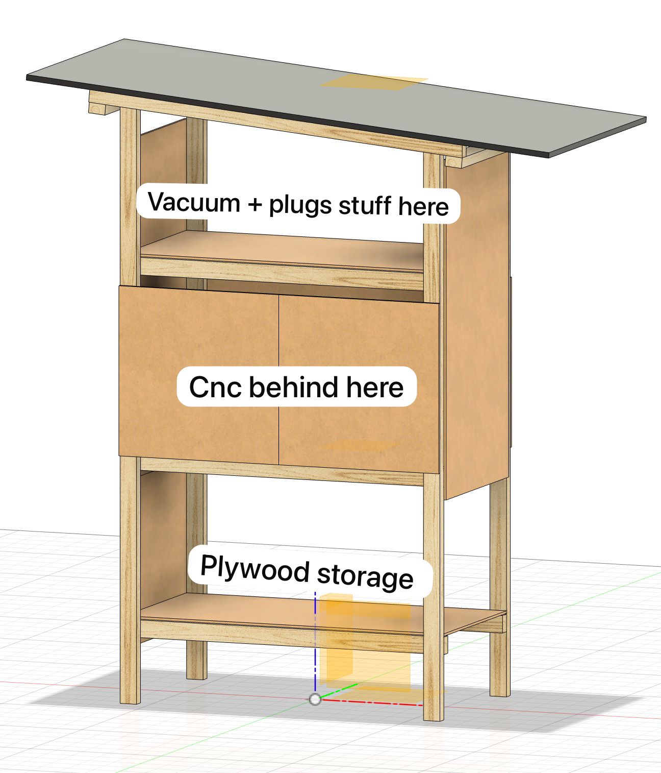

Outdoor Shed / Bustop Shelter for my MPCNC
I live in UK and don’t have a shed (renting). So going to build myself a wardrobe sized CNC shed.
  • I’ve kept it quite gappy to allow for airflow for condensation/drying
  • Left hand side is only side badly exposed to elements.
  • Trying to keep it cheap as is a temporary structure
  • Going to use 18mm OSB so hopefully dampen some sound
  • Will run power out to it via extension lead when using
  • Roof will be corrugated plastic thing. 95mm overhang minimum (longer on sides)
If you’ve got any tips or think I’ve missed something love to hear your thoughts. Been carrying it out into the garden recently and it’s not very fun.
If I were to make any changes I would put the vacuum lower. Gravity will assist debris and emptying it will be easier.
Looks like a good design overall. Maybe extend the front overhang to better keep the rain off yourself stood at the machine!
Would be most worried about water/condensation getting to the electronics, what is your plan enclosure wise?
And please make sure you have RCD (GFCI for the Americans) protection on the circuit you’re using to power it.
