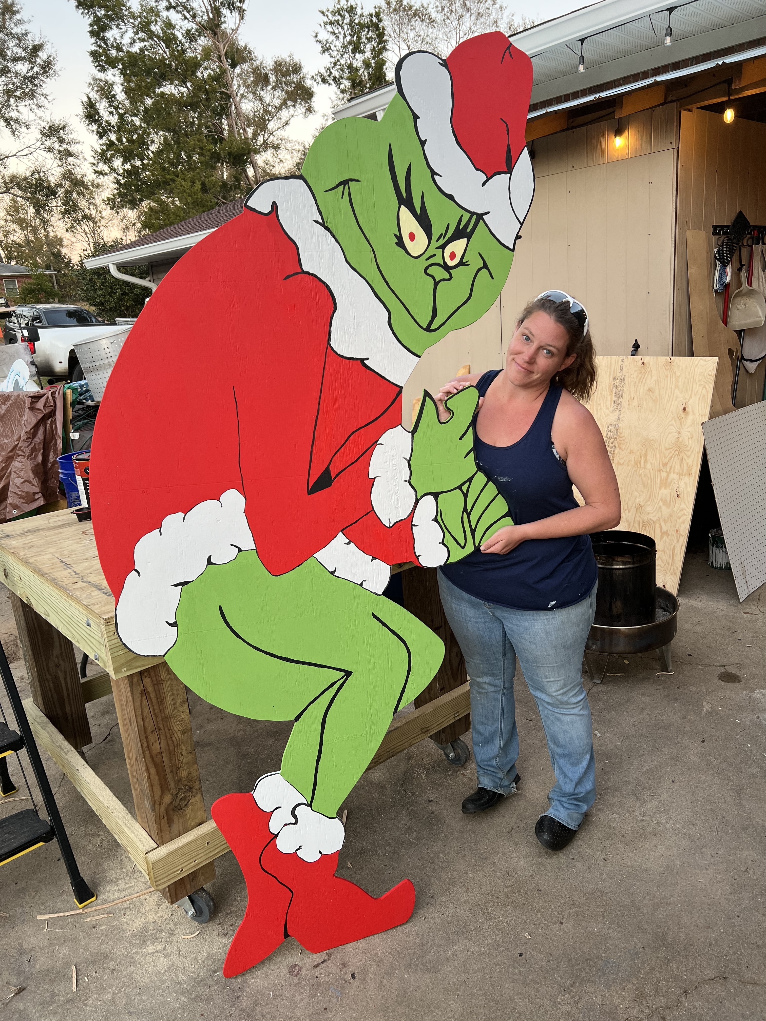

Last year I made this grinch for a friend of mine.
This year I’m thinking about making several and try to sell them to pay back some of this expensive cnc hobby lol.

The one I made previously is just leaned up against the house with Christmas lights extending from the roof to his hand to give the appearance of him stealing the lights.
The one in the picture is a little over 7’ tall. It was the absolute max I could get out of a 4’x8’ sheet of plywood. The ones I’m making this time I believe I’m going to limit at 6’ tall. So I will have 2’ of plywood left over I can make some sort of stand out of. Just not sure on what to make since there are so many variables in yards/landscaping ect.
