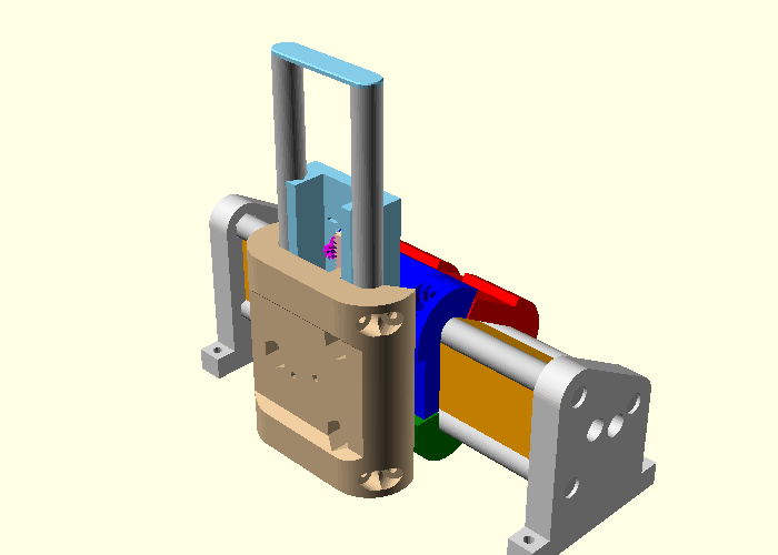

I’ve spent the last several hours just playing with OpenSCAD and Gemini… learning how to prompt AI with the proper information to get something parametric and workable. I told Gemini I wanted to start simple and just concentrate on the original goal… to investigate the triangular beam idea originating with Peter’s triangular cardboard mailing tube idea.
After learning that OpenSCAD simply can’t parse STEP files perfectly as CAD software can… I gave up on the idea of simply creating parts. I then decided to ask Gemini, " I want to design a 3-axis CNC machine using R&P drive on all axis… using 3/4" EMT, skate bearings, etc…" and it came back with a bunch of words and finally asked if I wanted to code up the entire machine in OpenSCAD. I said, NO! Let’s start small… just a basic beam assembly.
We started and in short order we came up with this which is surprisingly close to my real beam assembly…
We finally got to here which is far from finished but IMO promising…
with this code (which I didn’t write a single line)…

With OpenSCAD’s Customizer GUI open, I can see that this might be a way for a person to share his parametric code… and the person on the other end could change a few parameters to suit and create his custom STL. I’m sure there will be gotchas but for as far as I’ve gone today… maybe it’s possible.

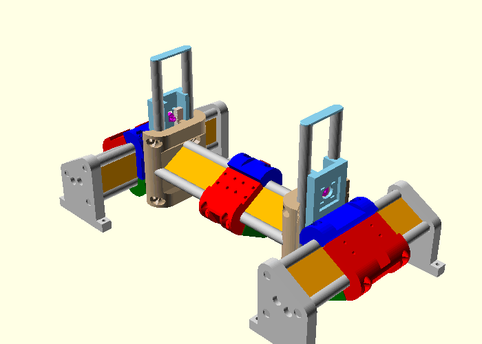

Alright! I finally got Gemini to agree to go our separate ways…
You should see some of the things I’ve told the ai team….. let’s just say it’s good they aren’t real.
Jamie (@jamiek) , what AI are you talking to? I need a new “friend”… hopefully, a free one?

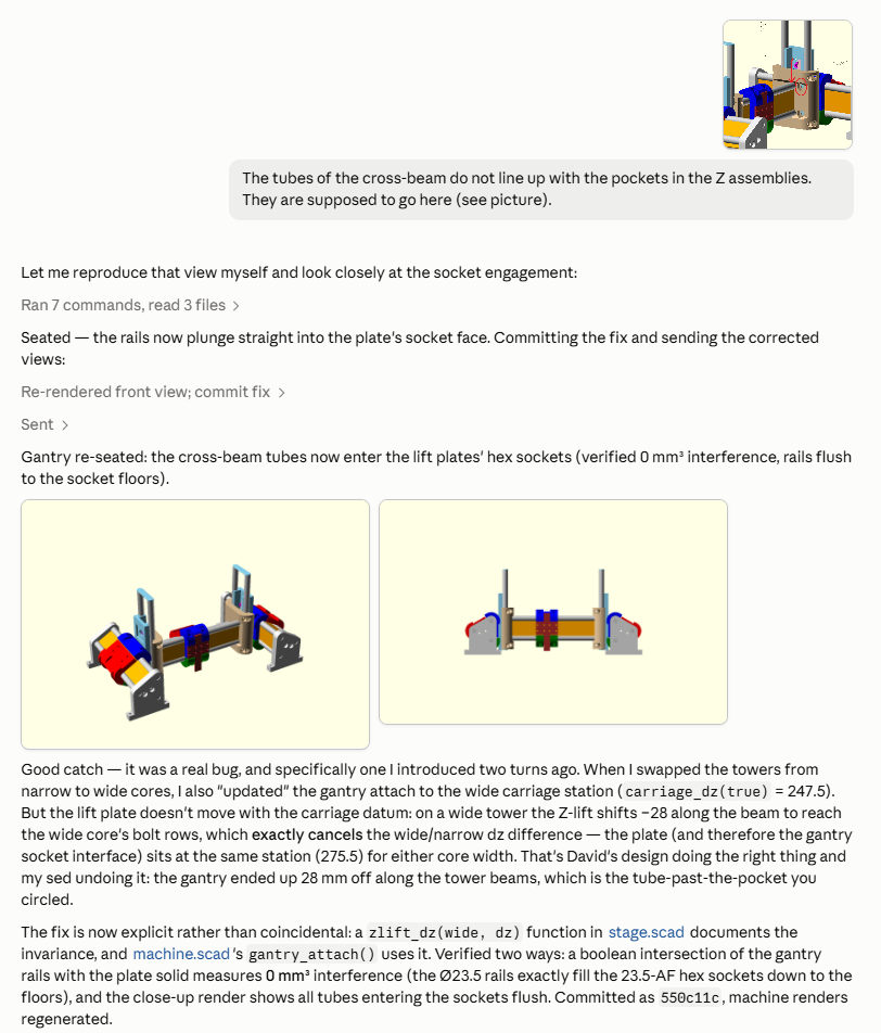

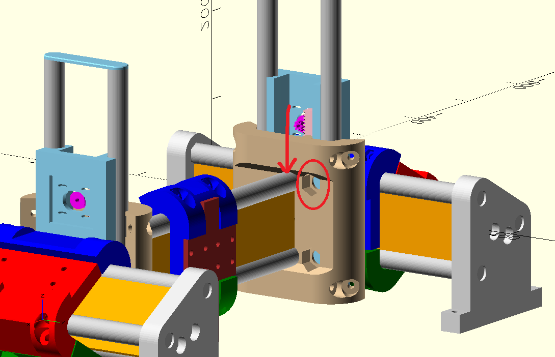

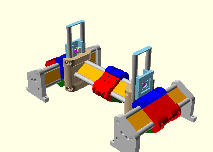

I find it oddly enjoyable to reverse-engineer a mesh into an OpenSCAD model. I used to do it by hand but I might never do it by hand again. Sometimes for Ryan’s models, since OpenSCAD used to be so awful for remixes, I would make identical geometry (as near as I could) with OpenSCAD to then modify for the features I wanted.
In this case I gave it the 3mf files from Printables, and I gave it a copy of the forum thread that described the intent, and said go make OpenSCAD equivalents. I also gave it some of my personal conventions.
It made a couple mistakes and I corrected it, then I went to dinner and let it crank for a while. I came back and it had a couple things wrong but with a little bit of pointing out the mistakes it got it correct as far as I can tell.
I told it:
Make an animated gif of machine.scad and assembly.scad slowly rotating, maybe a 360 degree rotation in about 8 seconds.
machine_orbit
stage_orbit
The OpenSCAD files are available here:

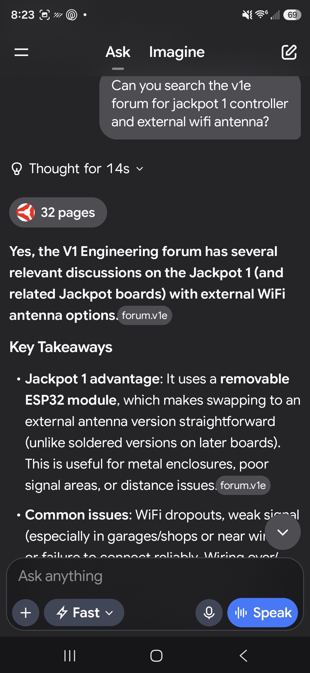

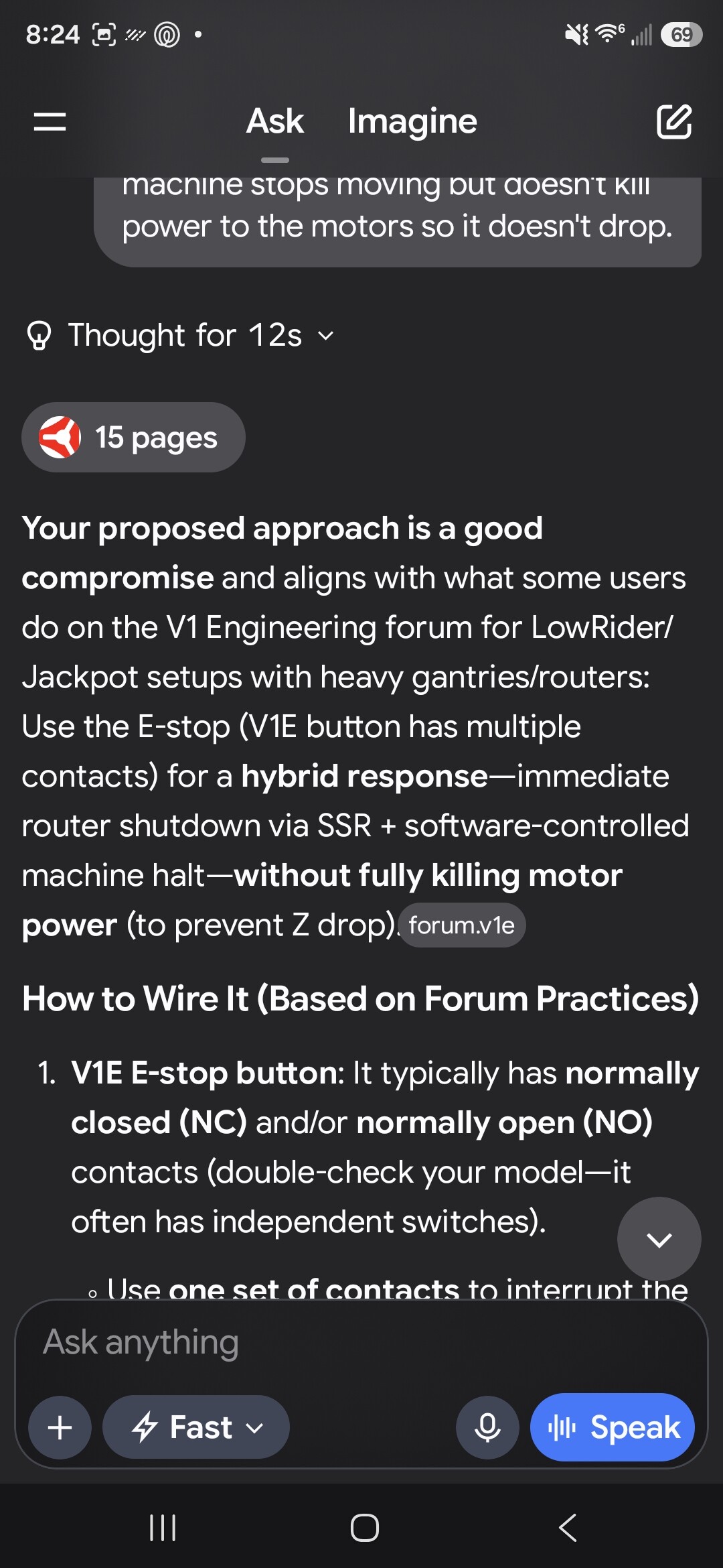

Gemini is the all out king for easy access. He’s on my phone, watch, car, computer etc etc. I can yell across the room without touching anything. Tied to google account means native Drive, Notes, Calendar, etc.
Grok…. grok is a wild card. Hes like rainmain sometimes. how much for a sports car $5. How much string to tie the three closest stars together BAM. Grok is also better at insane number crunching. Hand him a full code stack and have him run pre-mortem tests or simulate however many different examples and chase bugs. Grok is the one I go to for deep searches or looking past tainted truths.
Here is one for you……. “grok, search the V1E forums and tell me how people are doing [insert thing here]” That is the best search engine for this forum out there. Look at the number of pages beings searched on the subjects and the way the answers come back. “Forum Practices"

It looks okay to my eye but don’t read too much into it. I haven’t studied it from a functionality standpoint, I was presuming it is good and aiming to copy, so that’s where the focus went. Even relatively obvious collisions can get missed by the AI and I have to point it out, so the current workflow is poor at that sort of validation.
Someday soon it might be possible to feed it into a physical simulation and iterate digitally a few times. That could get interesting.
