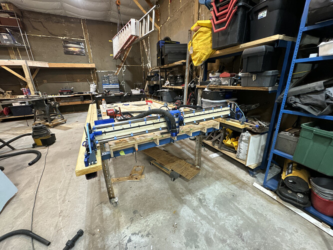

as far as the table i will upload a pic here in a sec if i don’t forget. i fabricated my table (rails with cross members ) from 2.5" & 2" mostly 1/4" wall square tube because it was the straightest thing i could find lying around…and actually cheaper than using all the plywood i bought for the purpose but even just tack welding mostly put a little tiny bit too much heat into the ends with the legs so the overhanging ends of the y rails warped about a 3/4 of a millimeter down on the bitter ends (boo hoo right… 0.75mm is just fine)… thankfully i’m barely ok enough at welding that my setup and workholding was decent and the ends warped symmetrically down the same amount on all 4 corners so i shimmed the 2x6s on either end with some soda can aluminum.
was thinking if i keep getting deeper into this cnc/3dp madness i might use this frame for a printNC after i cut a proper torsion box for the lowrider using what i just made
