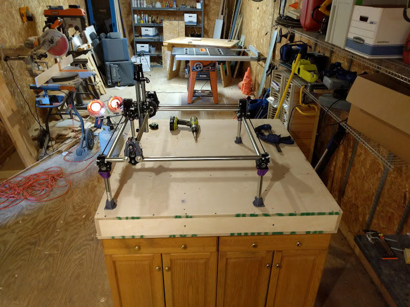

Found that the connector broke, must have been when it was doing pushups…
Got it in it’s new home in the barn!
Built a 4 foot square torsion box for the bed. It’s 4" deep, actually I guess it would be 5.5" deep with the top and bottom added. Happened to have a couple kitchen cabinets to attach it to in the barn. Eventually I want to expand it out a bit so I can fit a 4 foot square piece of wood under it for a table top I’m thinking about building.

As for that coupler the next one you put on there put it on so it touches the bearing in the z mount, kinda trapped in there, should relieve the vertical stresses on it.
Oh yeah, you wouldn’t want the handle side on top, because of the interference with the bit. So you’d have to have all that inside the bench… I’ll have to think about that. Maybe I can just keep or cut them short. Most of what I can think of to cut is 3/4" or smaller ply, thin plastic or aluminum plates, and maybe some dimensional 2"x4", which would be about 1.5" high, so I could get by most of the time with pretty short clamps.
