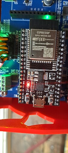

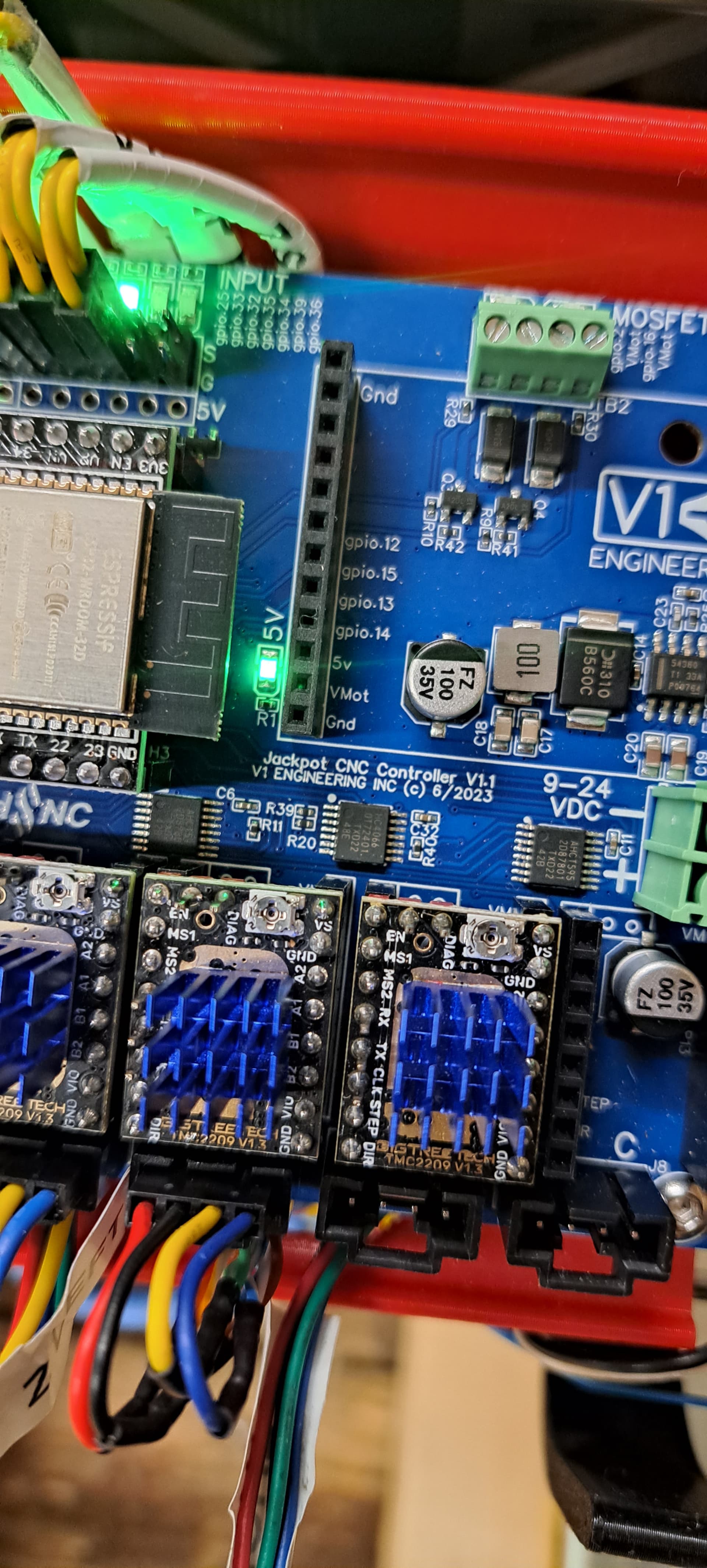

Can you put up a picture of your board and esp please.
When you boot can you run a $SS in the terminal and paste the results here (with the steppers plugged in).
We found at some point some of the boards boot wrong with the steppers plugged in. The new ones have a fix but if this is the cause we have options. Yours seems a little off previously they have all booted under powered (your pots might come into play here might be a backup boot system). To be safe you can turn all the pots down to make sure nothing melts.

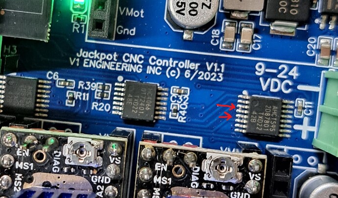

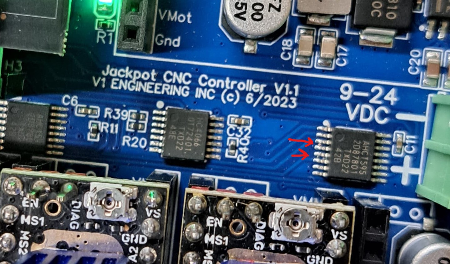

Something is going on with your Z2 driver.
Can you swap the first and last drivers, make sure all the pins are in and run it again?
Is this just dust or is something shorting these pins?
Yes. I will swap X and Z2 drivers and test. Should I turn the Pot all the way down on the troubled driver first?
Just to note that the trouble drive was originally plugged into Y2 and I swapped with Z2 for testing before making this thread. I will still run this test and pull the log file and edit this post.
On both boot runs it is showing Z2 error, so it is not the issue we know about. You either have a bad connection, bad driver, or that stuff in the pins.
I’ve cleaned out the specs on the IC. I’m going to swap X and Z2 driver and pull the log file. 1 min.

All tests passed so it must have been a missed pin or something. It should work now.
