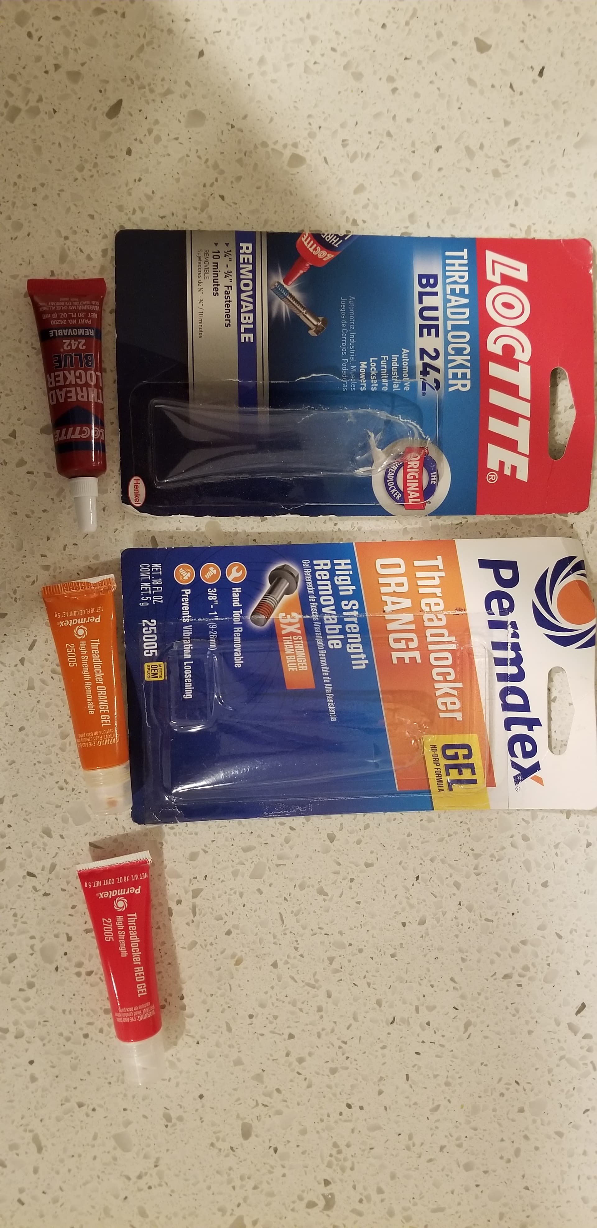

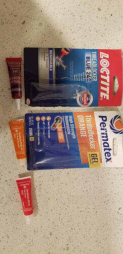

In the spirt of seeing confusion caused by grub screws vs set screws, I find myself compelled to point out another “technical term” clarification that has been weighing on my mind.
At the risk of being that guy, we are actually requesting people use threadlocker as the technical term to make our lives easier and less problem prone.
Loctite is probably the most widely known brand of threadlocker and therefore I do not want to be misunderstood, and thought to be correcting Bartman. Permatex is another popular brand in the states, with Orange as a third type/color.
With that said, Loctite as a brand, and a specification of “blue”, very well might be enough specification for our machines. But know going in that Loctite has different “formulas” of blue, and you supposedly you will not find any respectable RC helicopter pilot putting 242 on their helicopter blades. Everyone uses 243 for whatever reason. I personally don’t know the science behind the logic, just was warned my more than one veteran when I got my first heli, to use 243 and not 242. Red normally needs heat to break free, or an impact/torque tool that I’m pretty sure we don’t want to use on our machines, and I definitely don’t want to use around the pricey machined aluminum parts of the heli.
I took their advice because having sharp carbon fiber blades heading towards my head seems like something I want to prevent. :thinking:
I hope that helps people more, than causing more confusion.
Wait, you can’t be “that guy”. I’m already “that guy”!
As an alternative to the traditional blue/orange, loctite or other branded version of threadlocker, I have heard clear nail polish can work in a pinch as well.
243 is supposedly more oil tolerant, and doesn’t require as much preparation to remove any contaminants from the thread surface.
Appreciate this thread. Thought I had a screw loose over how much hate and berrating my Blue threadlocker 242 gets.
Didn’t know about 243, will try out. Thanks for the tip, cheers!
Have been wiping debris/oil off screws that need locking with paper towels before applying threadlocker.
Have been much happier since switching to use Permatex Medium orange gel for my V1E, and other builds.
I think that the 242 needs a VERY clean surface (think Isopropyl Alcohol) on both sets of threads. or so I have read somewhere.
