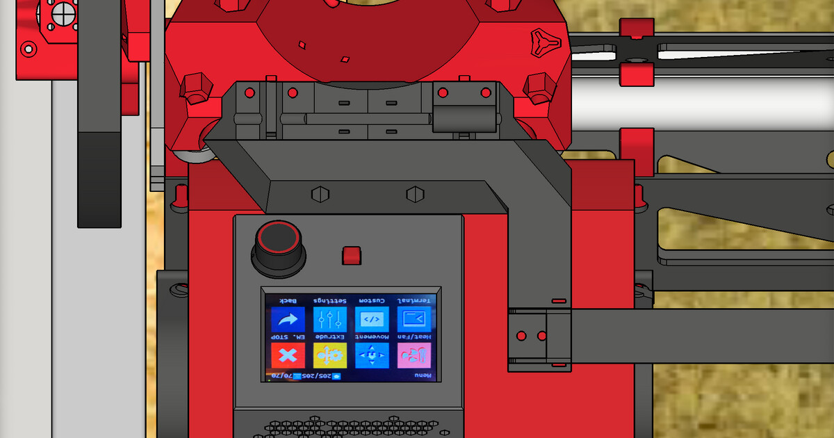

LR3 Cable chain mount - printed parts
I really like the LR3. It is a truly impressive design. My specific situation is such that I have needed to make a few minor tweaks to the plan.
The normal plan is for clever use of the vac hose — having it serve as the cable guide for the router’s power cord and X axis wiring. However, since my dust collection hose comes down from overhead, I’ve had to install a cable chain for guiding the power cord and X axis wiring. Since that is outside the normal plan, I had to design up a handful of printed parts to mount the cable chain. I now have my designed parts printed and installed. If anyone else would benefit from the designs and wants them, they are here:
Overview:
Looking down on the upper mount setup:
Birds eye view of the upper mount setup:
This little clamp-on piece holds the router cord secure so it does not bump against the side assembly when X axis is tight against home:
Close up of lower mount part:
@Neilp
See above. Since (I think) you said you are using a dust collection system, I’m not sure if the above would benefit you, but maybe. STL files are here:
