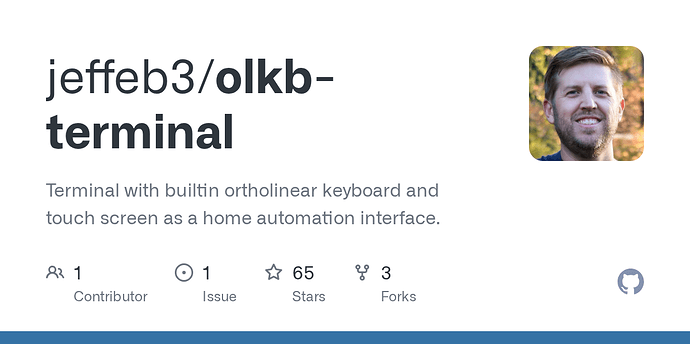

I’m making a github repo for it and I plan on sharing everything. If you can print 220mm, it is a relatively easy thing to print.

Edit: github:
