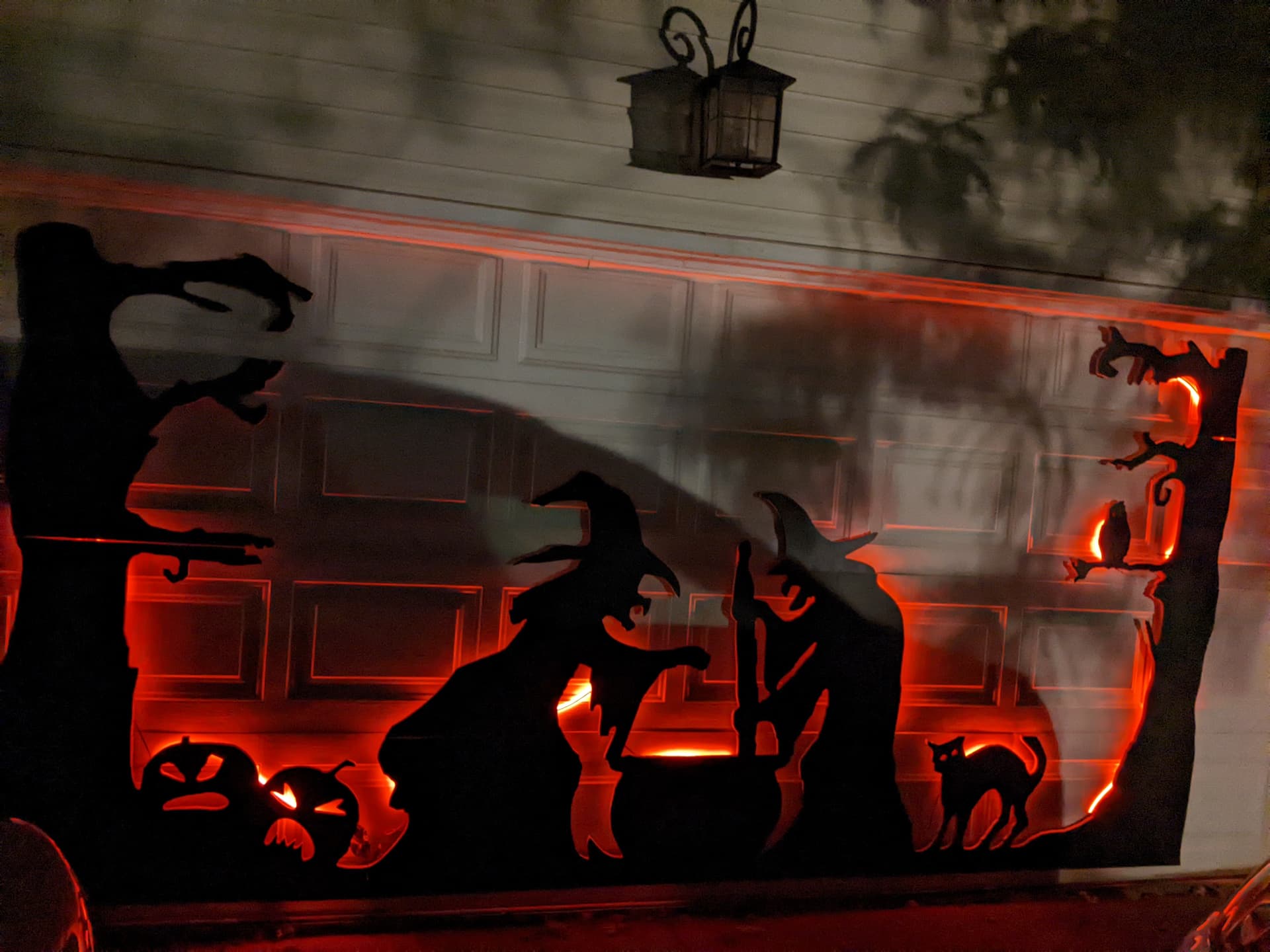

I would vote against doing laminated 1/4 backer with the xps on the cnc. For foam I cut full depth as fast as possible on the lowest Makita or cobalt rotation speed. For plywood, you can’t cut that fast and the bit will get hot if you do and then when the xps melts, you get to try and get it off the bit.
But you could cut the 1/4" plywood and then get a following bit and cut everything out of 1" or 1.5" xps because those are easy enough to find. Xps is pretty linearly priced for thickness. So you could laminate plywood plus xps plus xps to get the desired thickness.
I cut this out of 1/2" foam, but 1" or 1.5" or 2" foam cut similarly if your bit cut edge is long enough.

Looks great. The backer would only be needed on pieces that will be doors or flown… So I can always cut the backer as a 2nd job.
