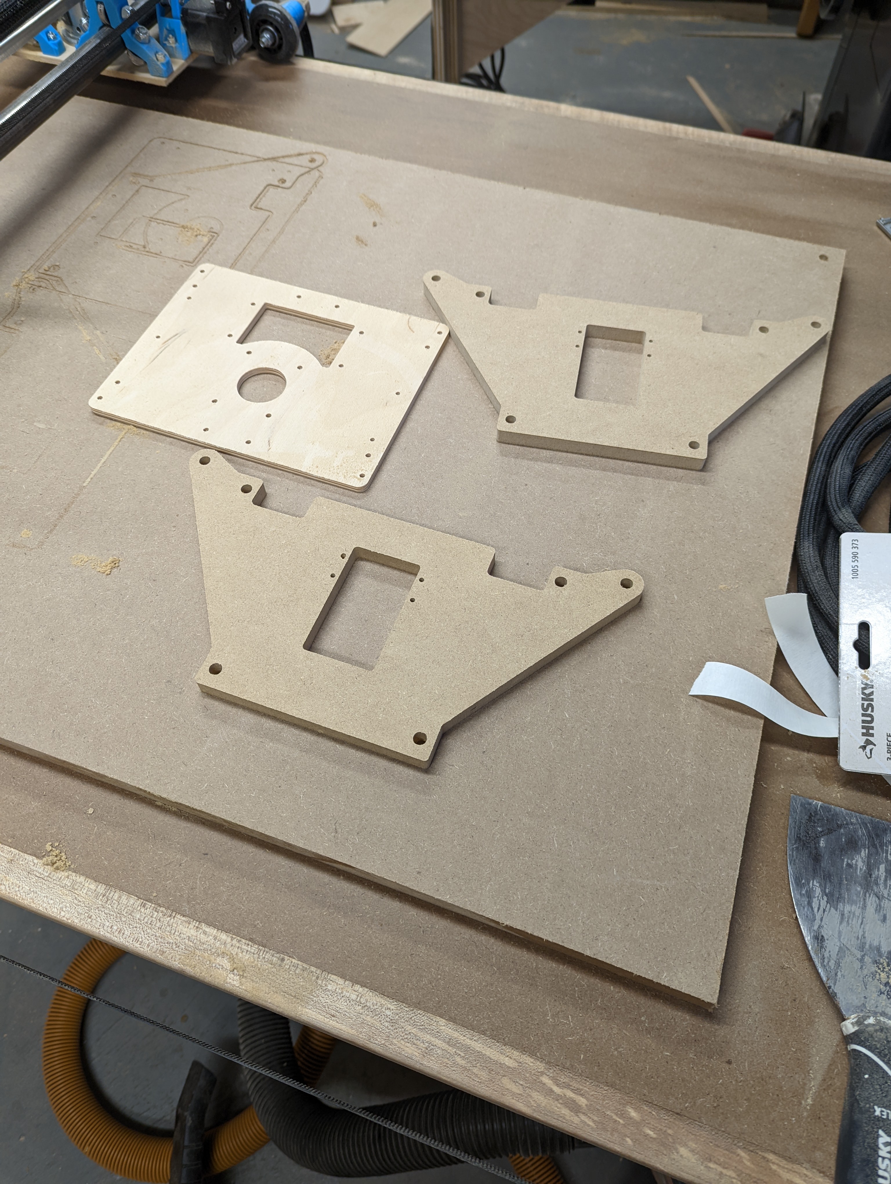

Since I need to flip the XZ mains (which means I need to disassemble practically everything) I decided to recut the flat parts since I have a working CNC.
Came out flawless, it’s perfectly square.

Cut out some new flat parts since I need to fix the xz mains, rattle canned them flat black. Got a JST and Dupont crimp kit coming and then I’ll do some hardcore cable management on the rebuild.
