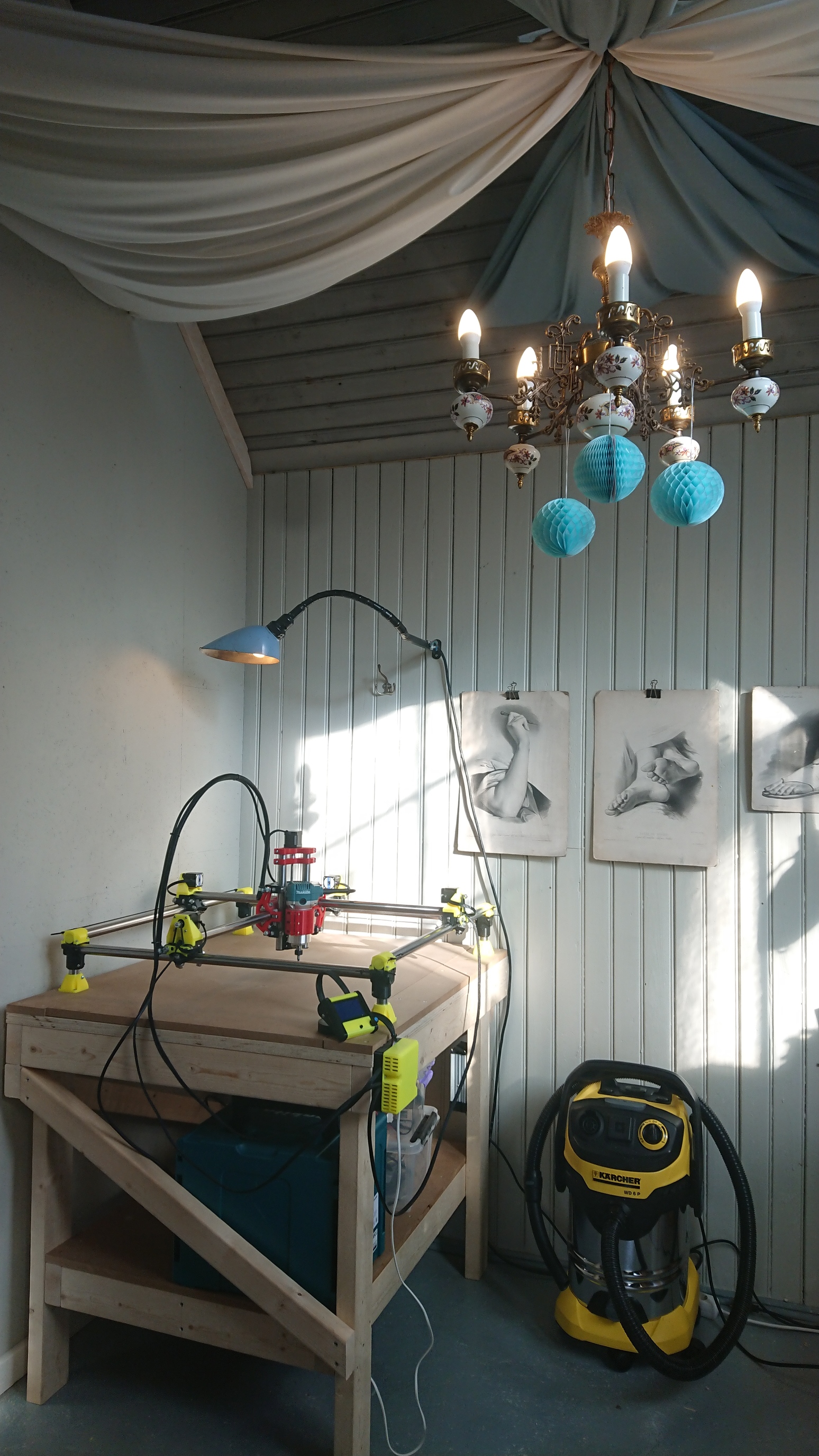

The picture above is me converting the pottery studio to a workshop, but keeping some of the artsy stuff, because why not!

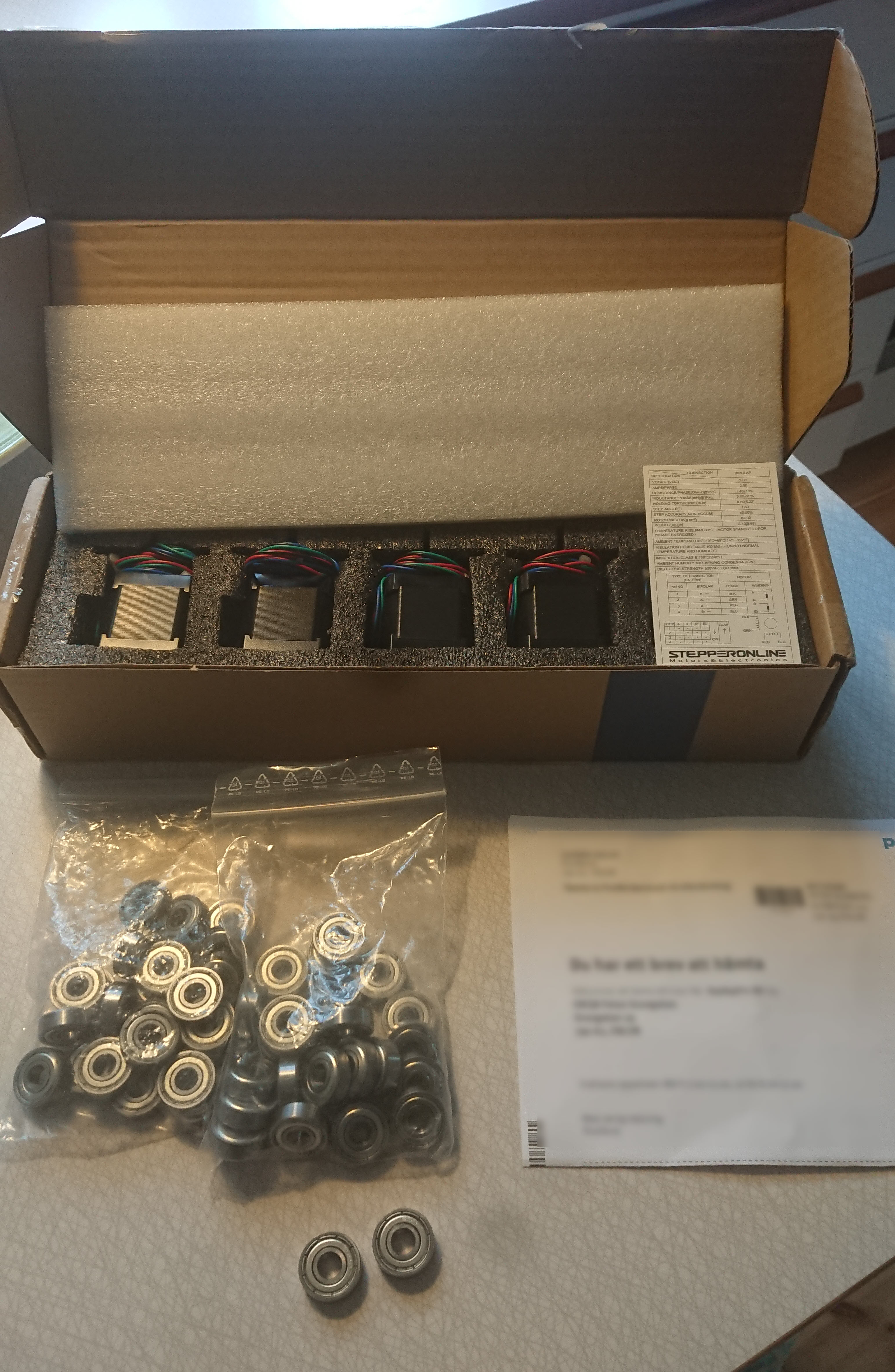

Steppers and bearings arrive! These are the Nema 17 2A 59Ncm(84oz.in) steppers.

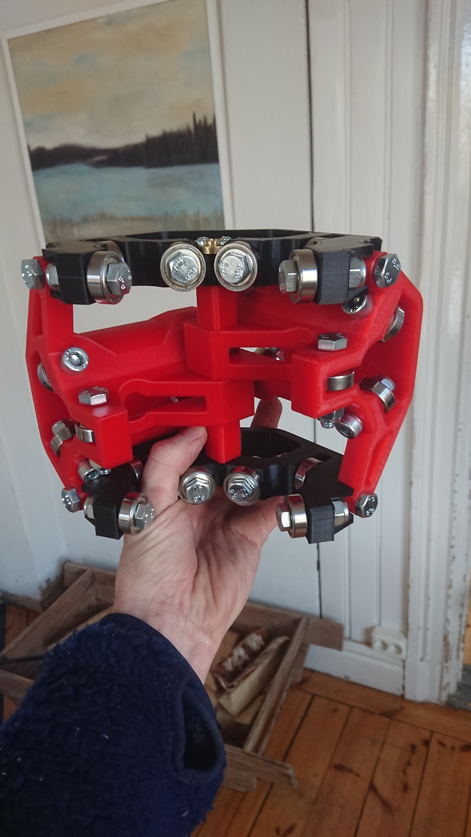

I could almost stop here! The middle assemby was way cool to put together and while Ryans design was impressive when they came from the printer bed, it became apparent that there are hours upon hours poured into every single detail in how these parts interlocks. A wonderful piece of engineering!

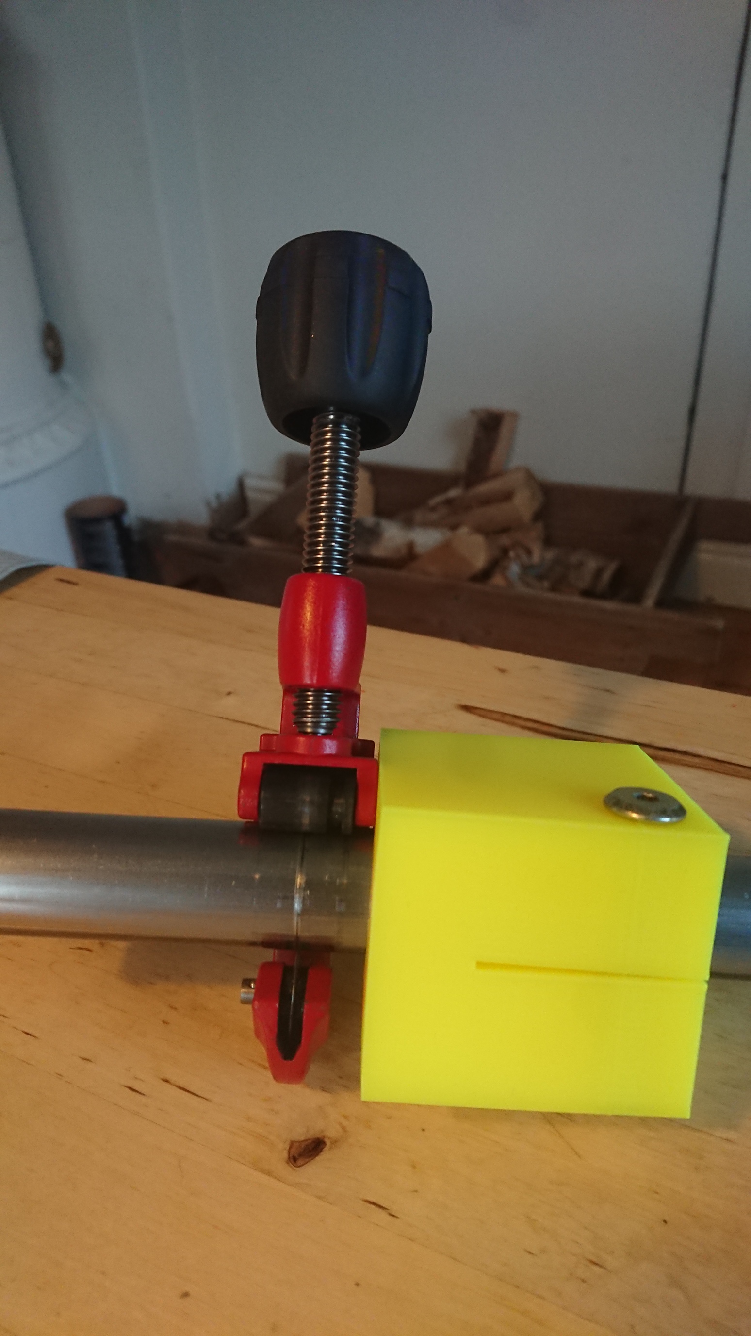

Cutting 3 mm thick pipe with a pipe cutter. It was doable but my first cut was not entirely straight, so I made a quick and dirty guide for the cutter to follow.

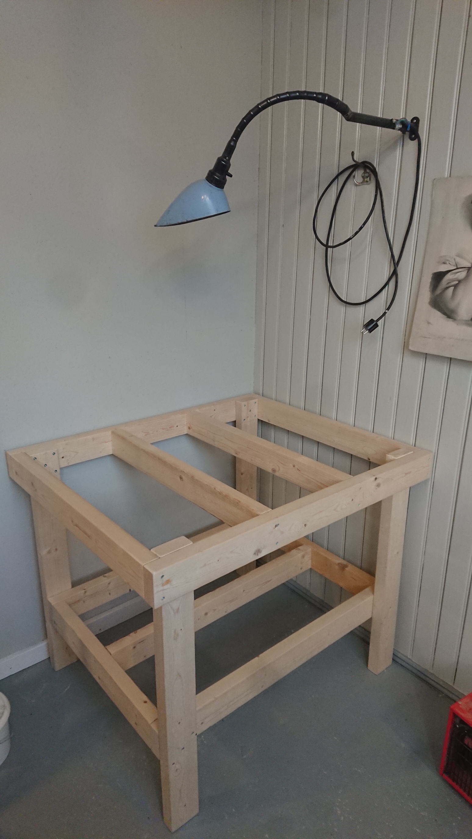

Parts are printed and most hardware are gathered. Time to make a table. My build is 600x600x85mm and the MPCNC calculator was very helpful! I wanted a sturdy build but I think I could go with a bit longer Z axis.

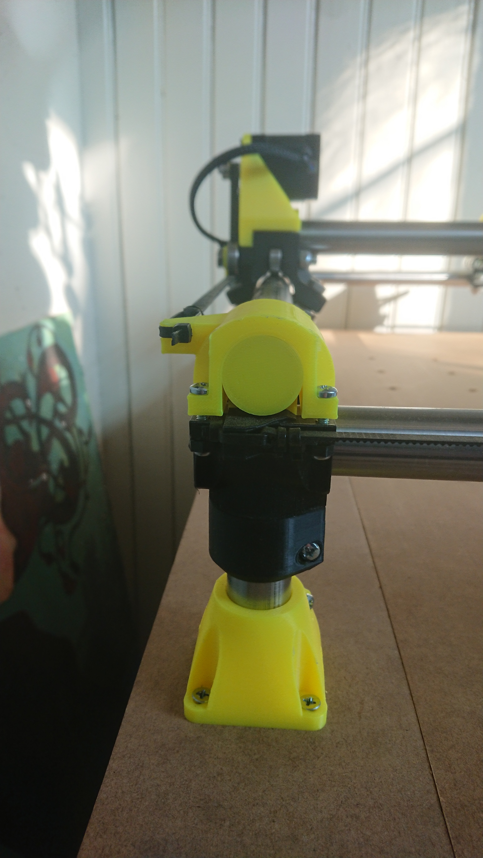

I made some end caps for the rails. It looks nice and I thought maybe they will dampen the noise somewhat. :- :man_shrugging:

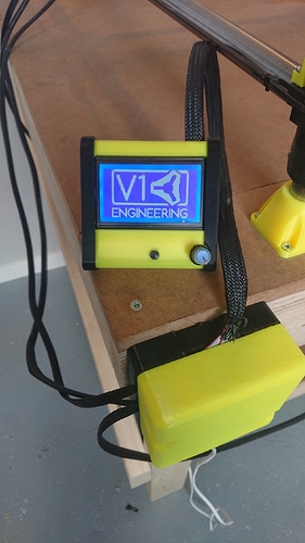

I used RAMPS 1.4 for control board and put it in this pretty nice case. The LCD display case is Ryan’s design. Note: I have since (temporarily?) moved to a Arduino Uno + CNC Shield + GRBL setup because I really wanted to try out Easel for carving. I will make a separate update for that (it was worth it!).

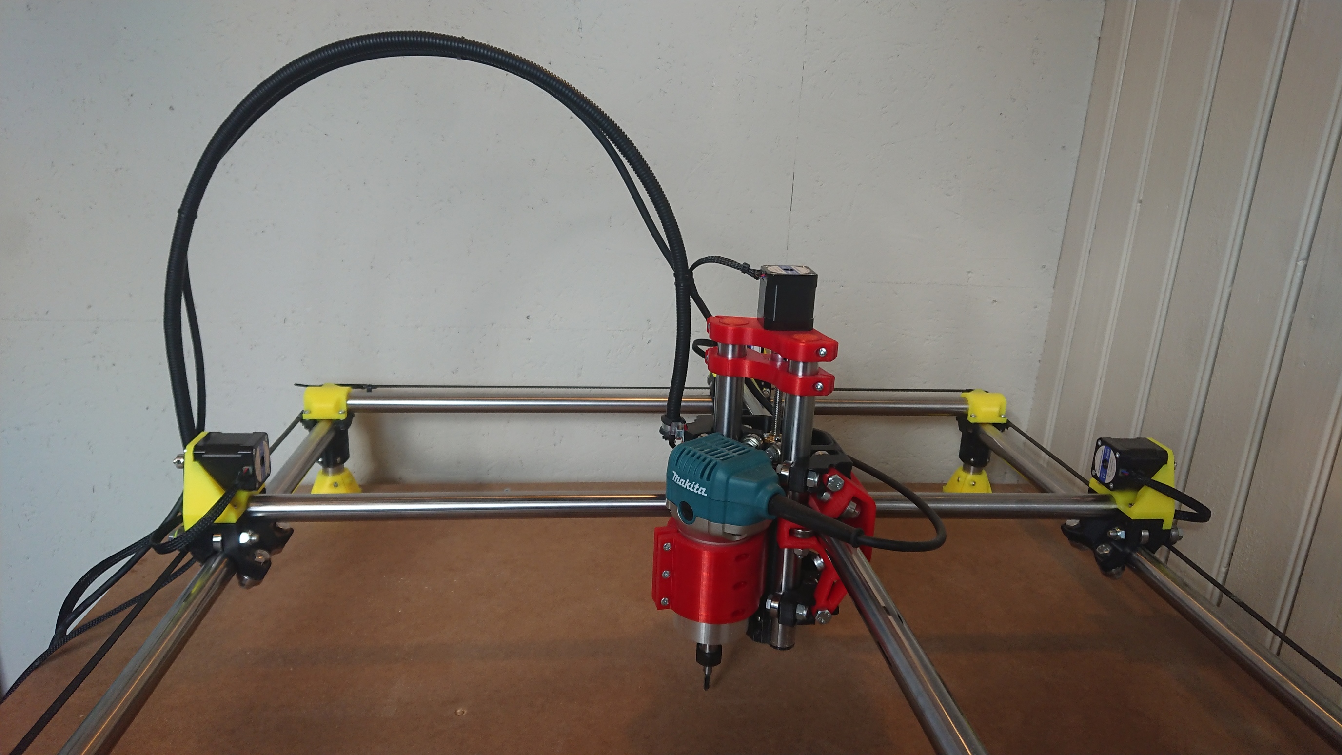

The moment of truth! It’s alive!!

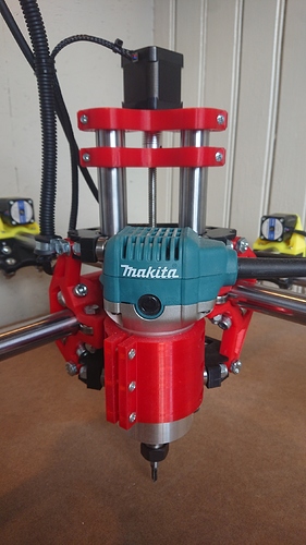

The Makita RT0700CJ 710W was easily sourced and has probably more power than I’ll ever need. I like it!
I have not done much in the area of cable management, but I wanted to at least have the gantry neat and tidy from the start. The loop is made out of a piece of drain cleaner coil (the flat metal type) inside a regular flexible cable tube. The metal is springy and bends only one direction and it holds both the router cable and the stepper cable. Cable chains are nicer, I agree, but this was a fast enough solution.

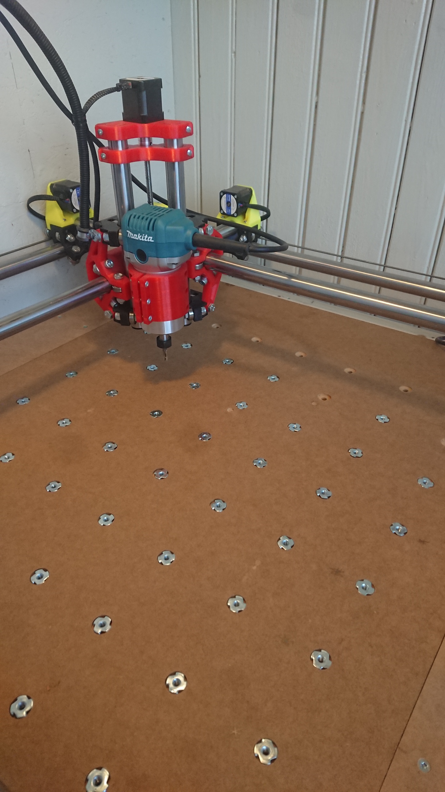

First real CNC project! Drilling out holes for clamps on the wasteboard and hammering down M6 nut inserts. The wasteboard is of course upside down in this picture.

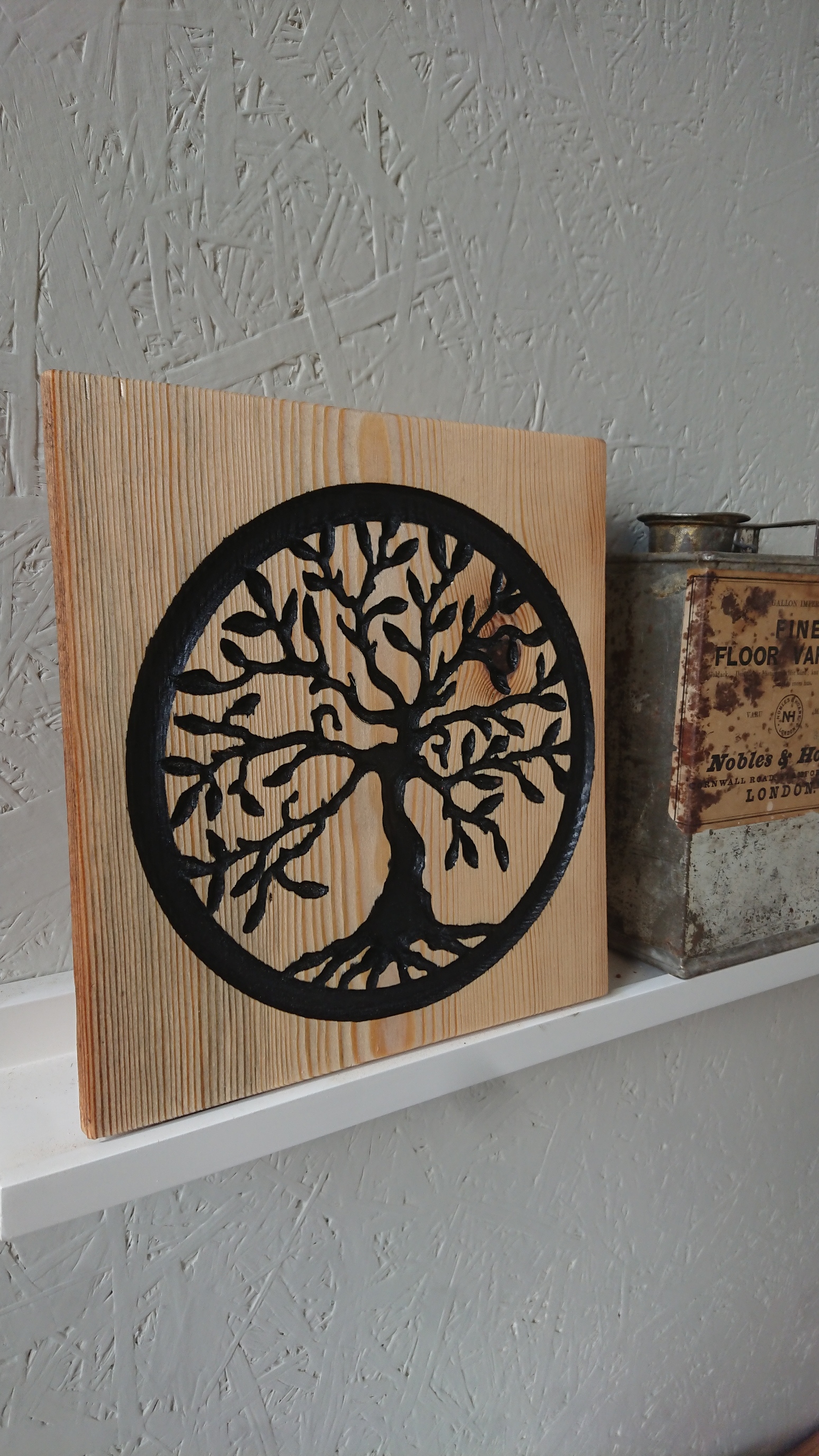

Wanted to try out some V carving and found this pretty tree. I do however really need to source some harder wood. This is carved in pine and while the end result is fine, the time spent with a Dremel was a bit too much. Also, why did I pick a piece with a branch eye knot?! :- :expressionless:

Looks good, and I agree with the wood, but it seems quite difficult to source more “exotic” and harder woods here in Sweden, we are condemmed by too much pine and fur growing everywhere.

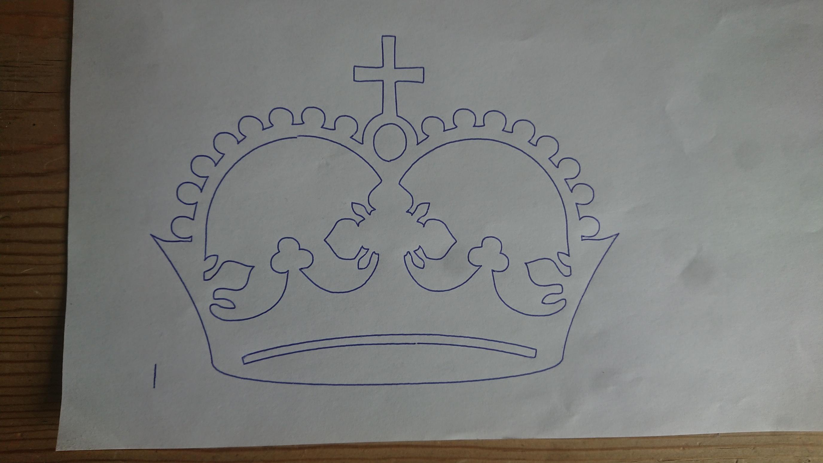

So why Easel? As stated earlier, I’m completely new to CAM and machining in general so navigating in this space is a little overwhelming at first. There is a lot of new terminology and I became a little scared of ESTLCAM, even though I managed do the crown test and some other basic milling with it. Easel is created for makers and while there are some evident limitations, you’ll get a basic understanding of CAM fundamentals. There’s also “apps” in Easel which are basically projects that you can configure for your liking, like a carved box with all the pieces needed. When and if I need to work more freely, going back to ESTLCAM or maybe even Fusion360 will be easier because I know how things work. Getting GRBL unto Arduino Uno was pretty straight forward. Then there is some calibration to be made. GRBL discussion here.
