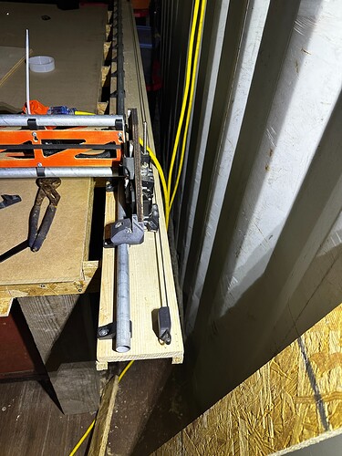

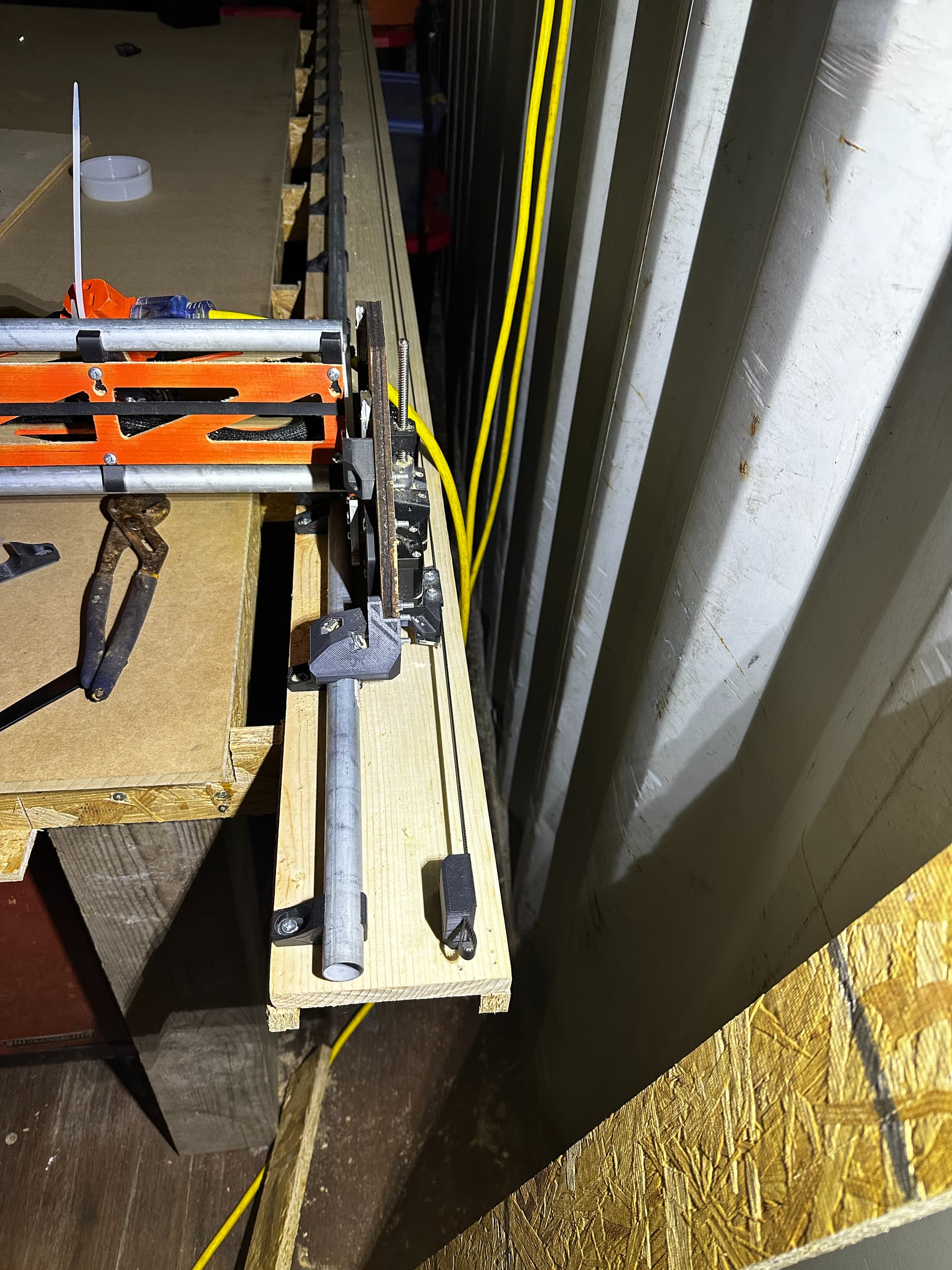

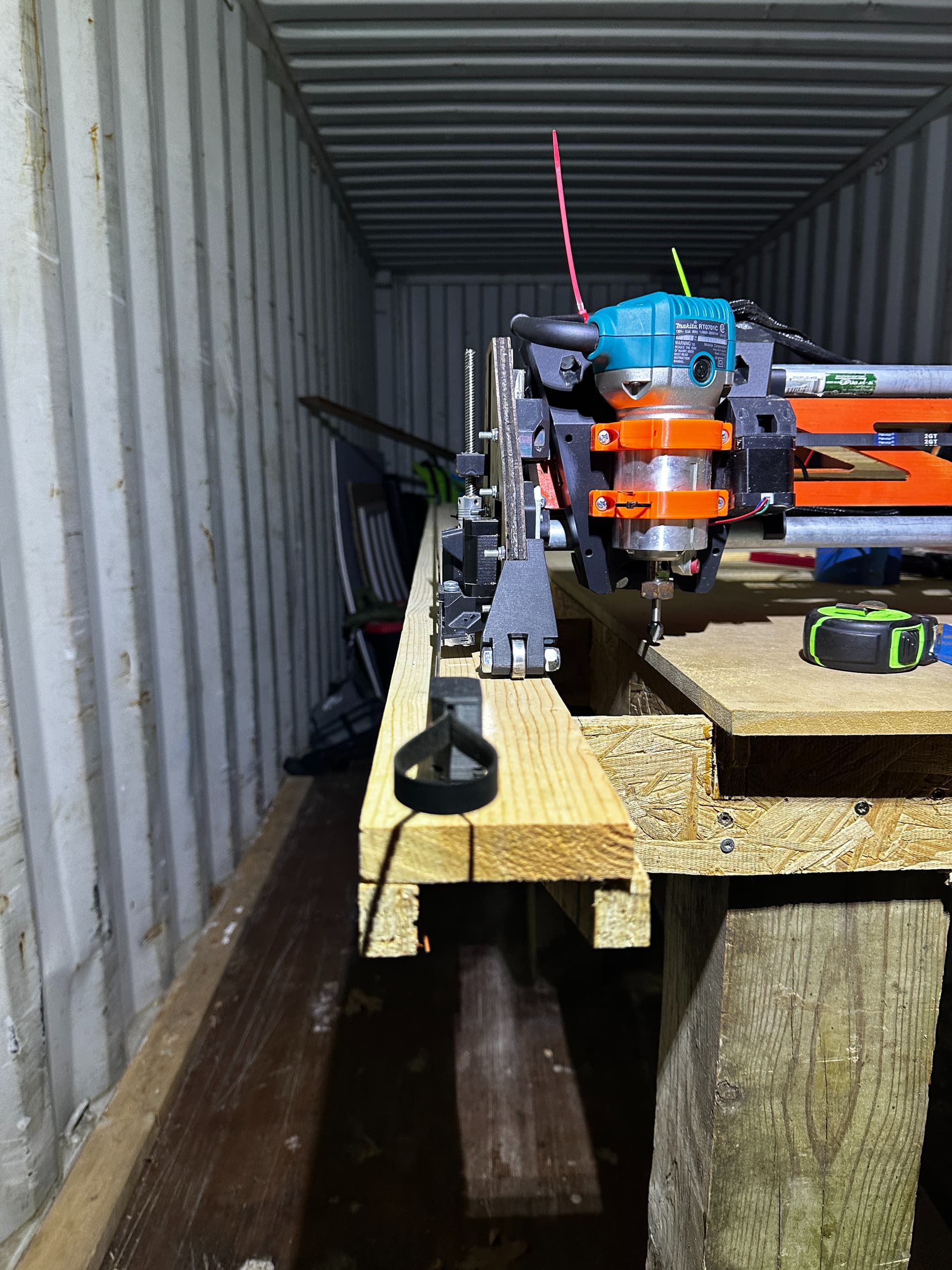

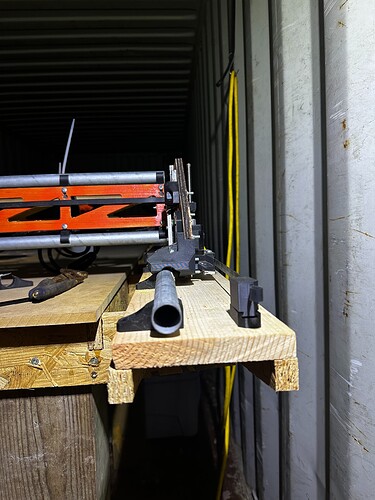

Hey all. Table is finally built which means I’m doing final squaring. I am less that 1/16th over a 4x8 build at the moment. Could be better, but I noticed what seems to be 2 issues. Before I go chasing better I think I should ask ya’ll.
First. My pull off numbers are 6mm and 15mm on Y axis. That seems like to large of a difference?? Or does it matter?
Second. It seems the closer I am to Y0 the farther off the rail my truck is. Does this mean my rail is not straight? Or is it that my mounts for my Y belts are messed up. (how do you guys ever get them even???)
Core at Y2400
Core at Y100
Thanks ya’ll!

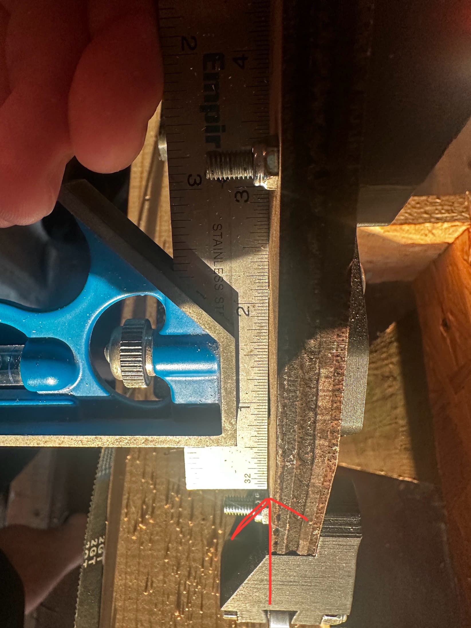

Measure your heal and toe distances. That is the front and back edge of the YZ plates. I am guessing you have a very different number on each end, it should be identical.
Yeah you are right. Looks like they are 58 7/16ths vs 58 and 9/16ths so I’m off by an 1/8th. The front is wider than the back if I remember right. It seems my YZ plates have a slight bow to them? I don’t know how. They’re Baltic Birch but a square says they are slightly. Is that my issue?
The last brace sets the angle. Make sure your X rails are not touching your XZ plate and kicking them out.

I have not swapped out the braces yet, so that could still be the problem. The thing I realized is that the farther I go Y+ the better the truck sits on the rail. The closer I am to the front of the machine the worse it sits. I would think if they’re at an angle or something it would be a consistent gap? Am I wrong?

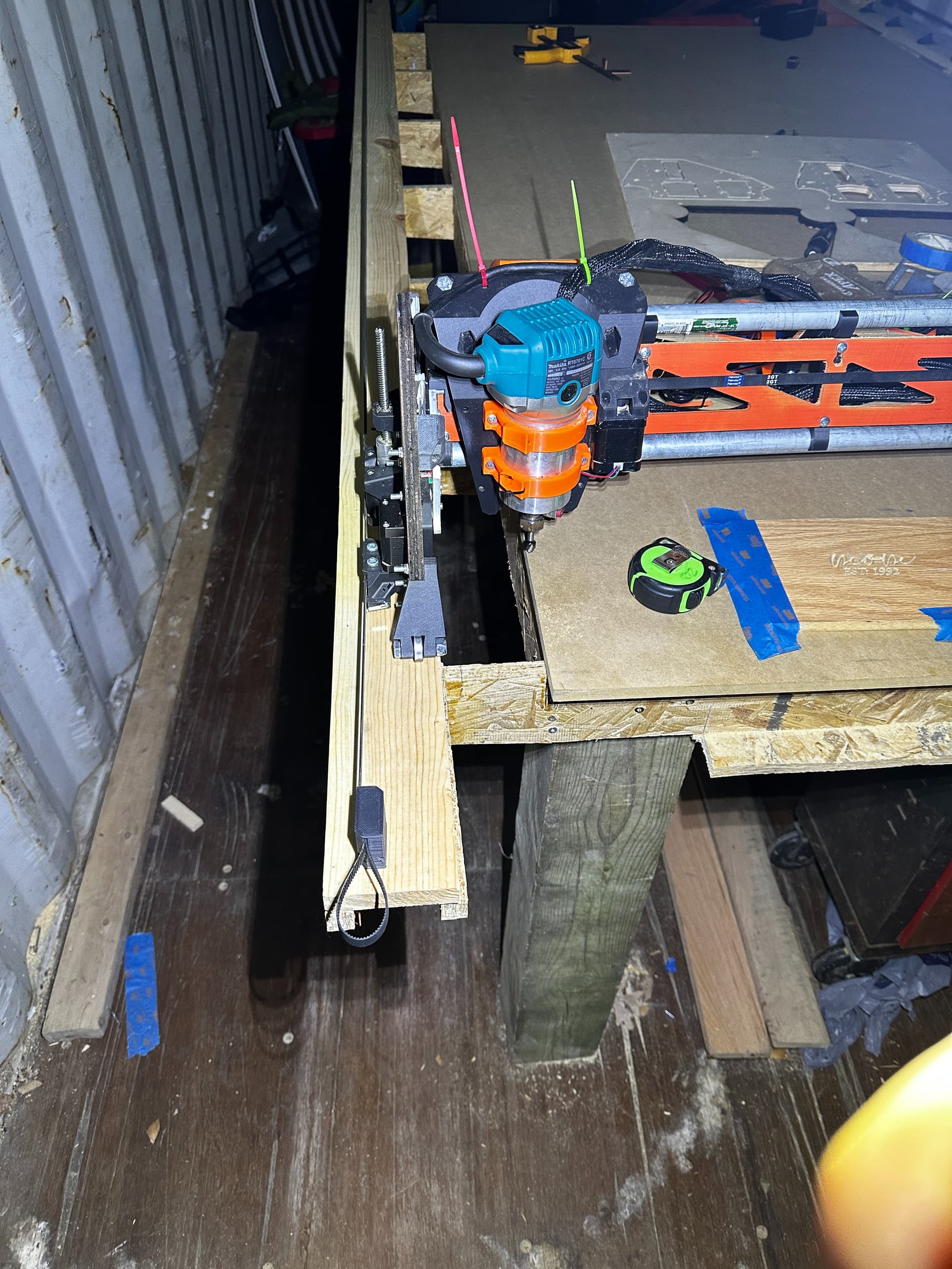

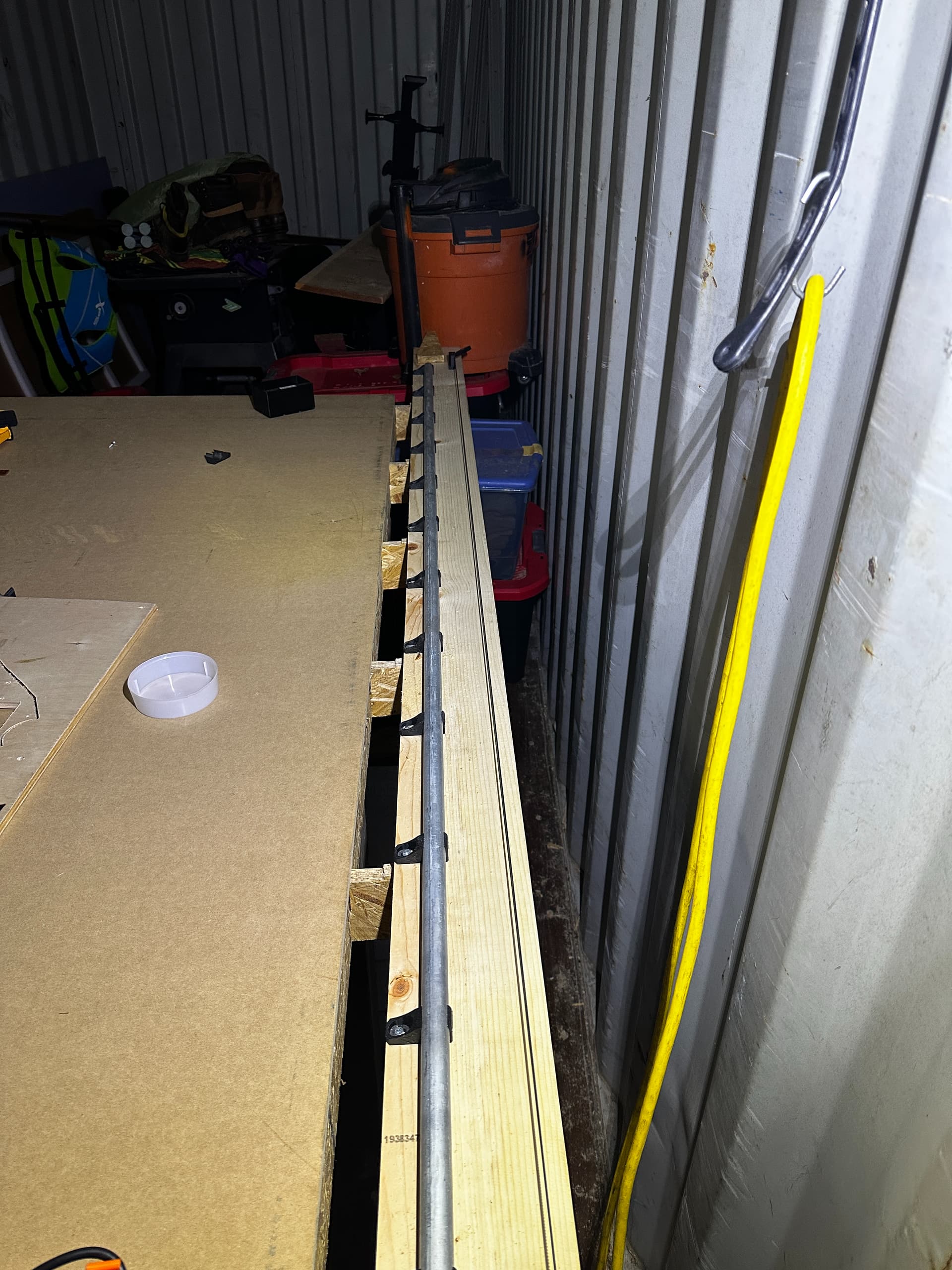

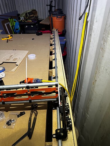

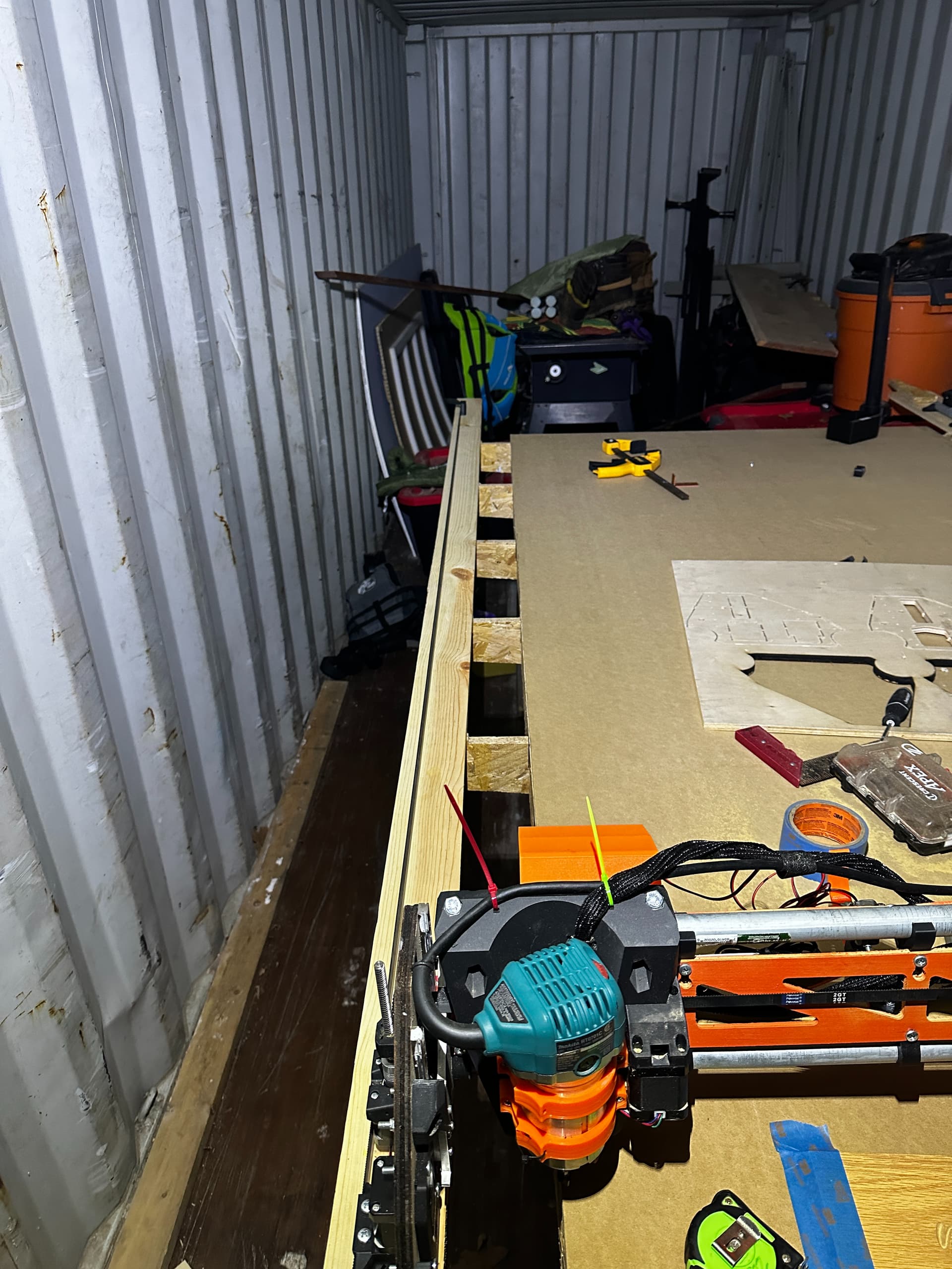

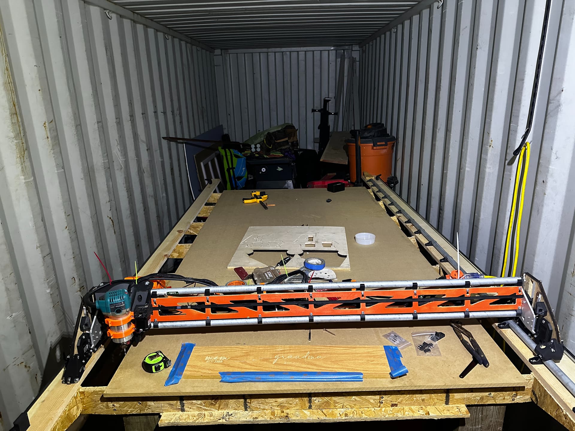

Let’s see some sort of overhead shot, take a look at your belts and rail. I can’t think of any way it gets worse other than it is so bad it is driving itself apart. Which it should not be able to do, that is the whole point of the bearings just sitting on a smooth table.
I would agree. That makes complete sense to me. Only thing I can think of is my rail is not straight. Not really sure how I would accomplish that. I printed a spacer block based on the drawings to try and keep everything at least even. But that doesnt mean its straight.
I just snapped a bunch of pictures.

Definitely a gap, and the brace is angled. No clue how I didnt see this the first time around.
Definitely got the rail to long. Its touching the plate on the other side.
