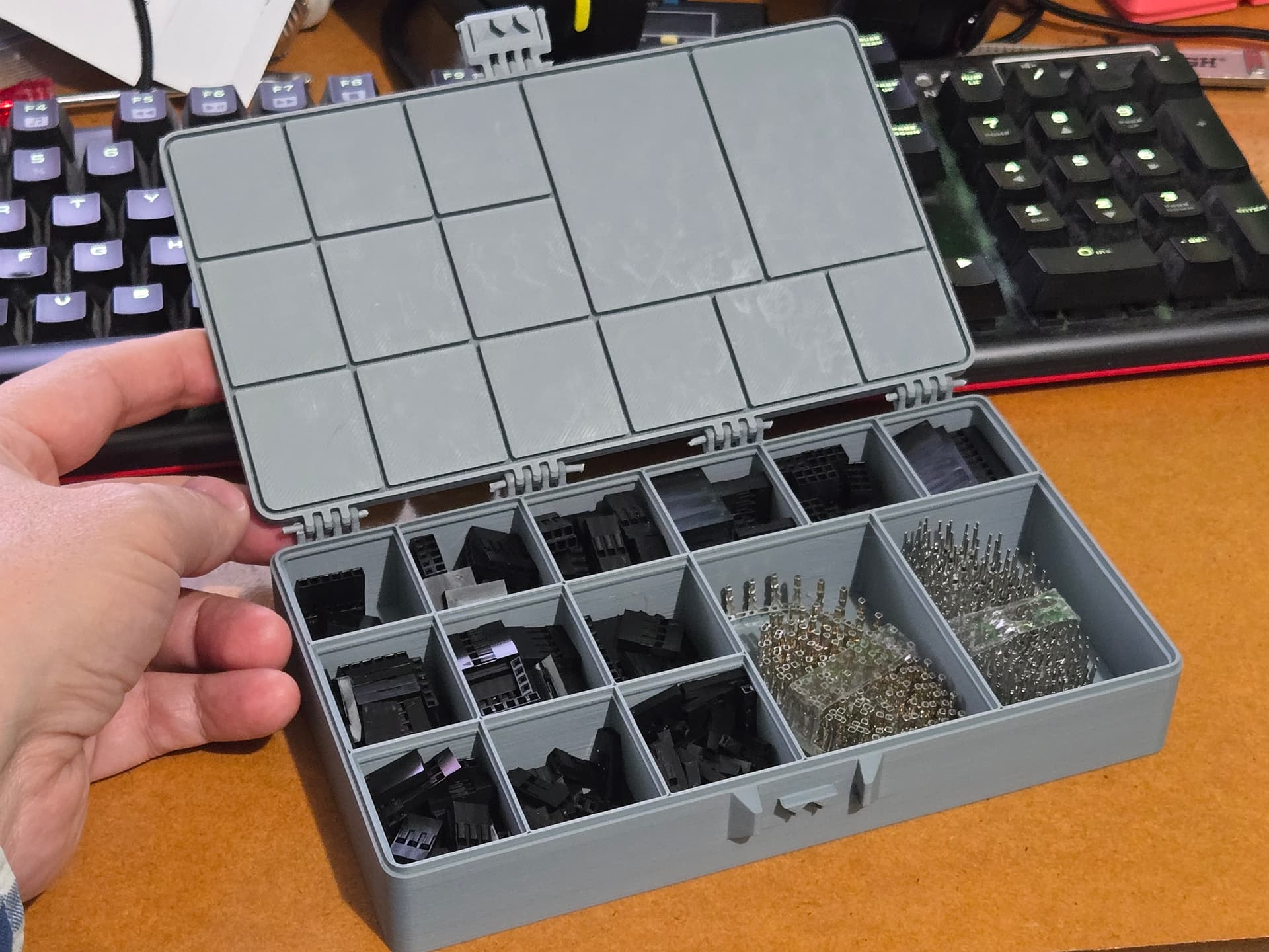

I know people like Gridfinity, but it doesn’t really fit how I work. I have piles of stuff and I need boxes that close, rather than open bins that can spill.
The translucent boxes that come when I buy Dupont connectors or cheap M3 screws from Amazon seem okay at first, but they are awful at keeping items separated. When closed, the lid leaves a large gap above the inner walls, and the removable separator tabs are easily bumped and suddenly two bins are mixed together. UGH.
I designed a box where the top of each wall has a little extension and there is a matching groove in the lid that is just a bit wider. Even if the lid is not completely flat or if it flexes from being tossed around, I can 100% depend on the parts to stay in the correct bin.
There’s also a clasp to keep it shut of course.
https://www.printables.com/model/1313419-multi-chamber-box-with-clasp-and-good-separation

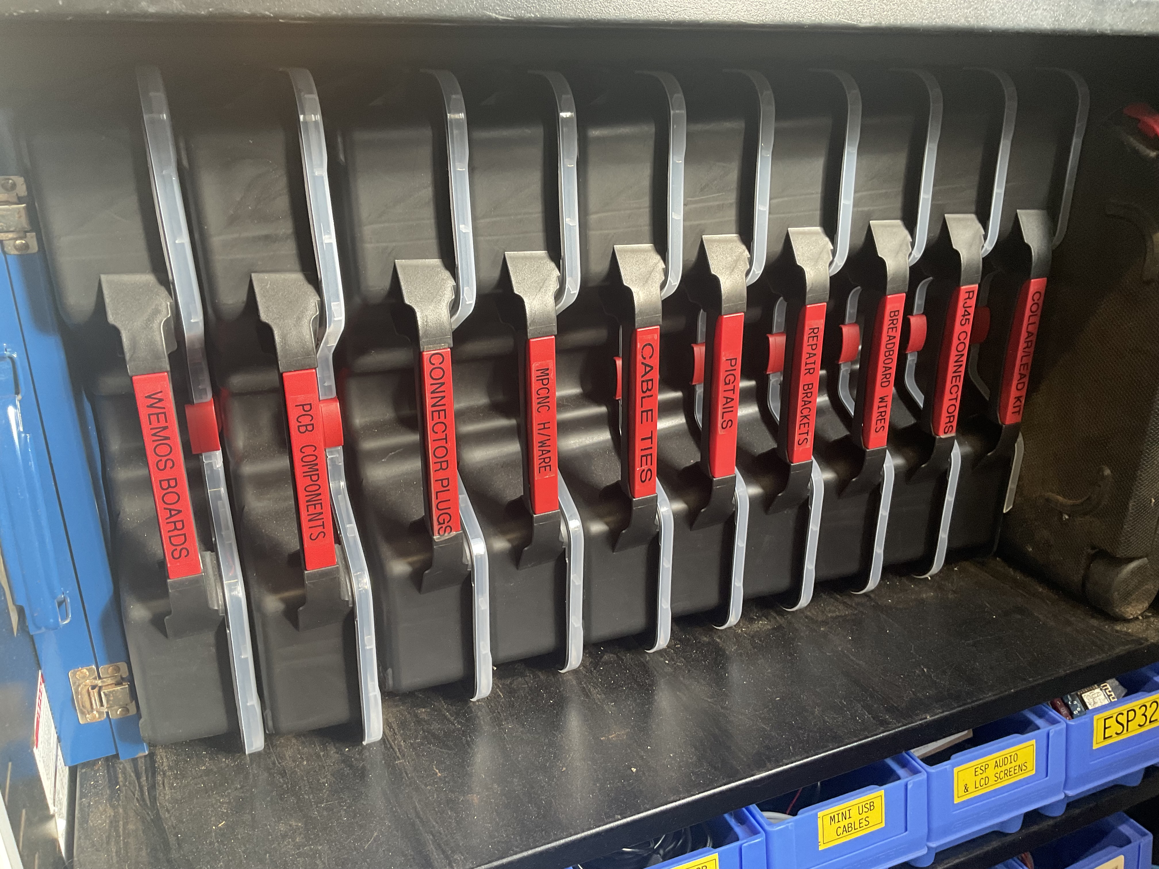

I can stand these on end, like books on a bookshelf, rather than having a stack of them and having to grab the one in the middle.

I have a couple of plano tackle boxes stacked on a shelf like that. It is much more convenient to be able to turn them around.
This looks like a great design.

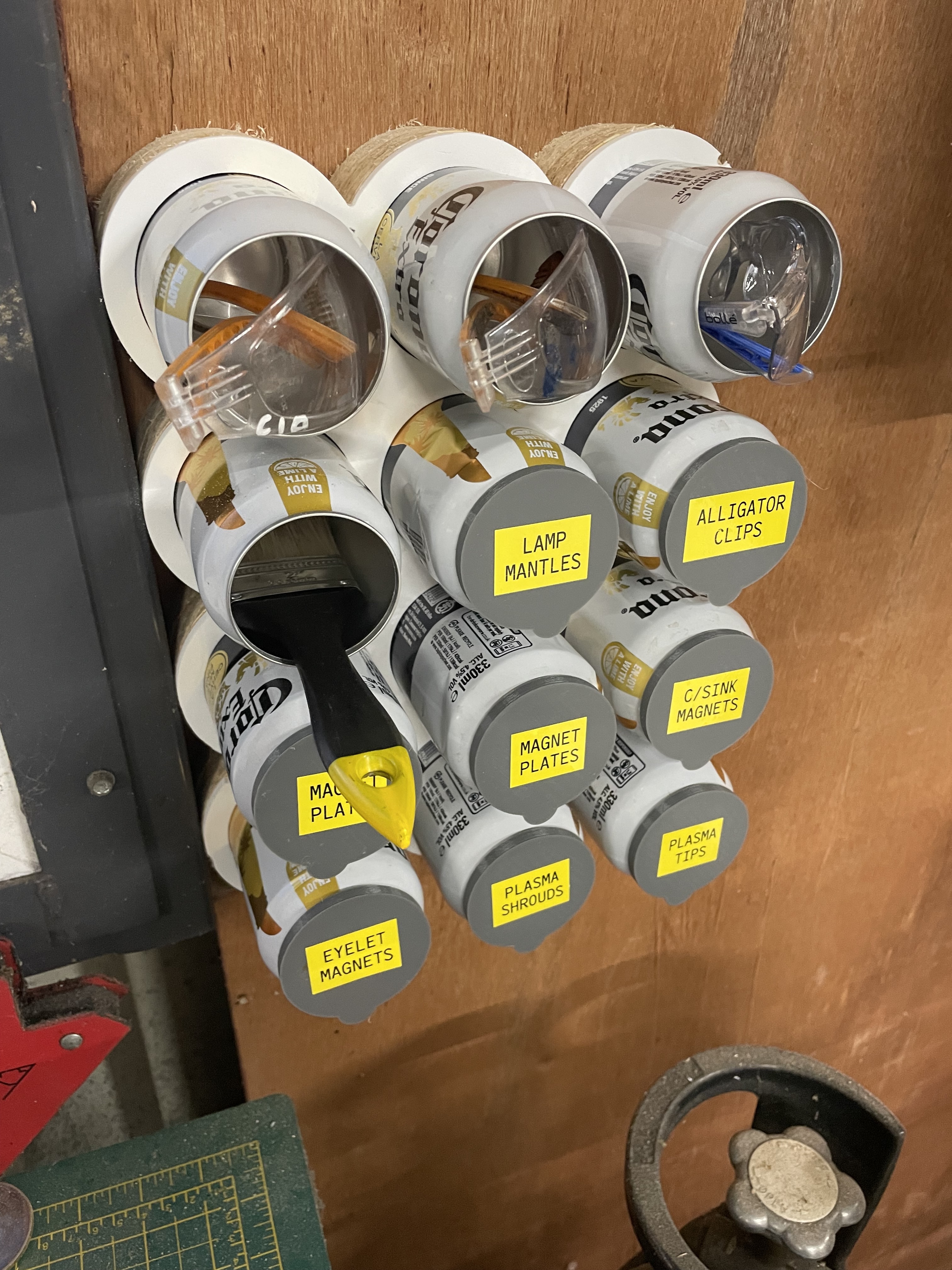

Since we’re talking storge I can also mention my recycling/storage solution - only possible by having a CNC machine:

This is what I do
That’s like 3€ in cans in Germany if you returned them to the store…
But it represents all of his pride. Canned Corona? Really? At least claim you got them from your child, or a local fraternity…
I can’t believe a German (or at least, German-adjacent) person let that slide.
I didn’t want to embarass him in front of his friends… :wink:
Who else would you embarrass him in front of? I mean, we know his family probably isn’t here… Very few of us have that level of familial support (and if we do, the embarrassment is doubly deserved/expected/tolerated).

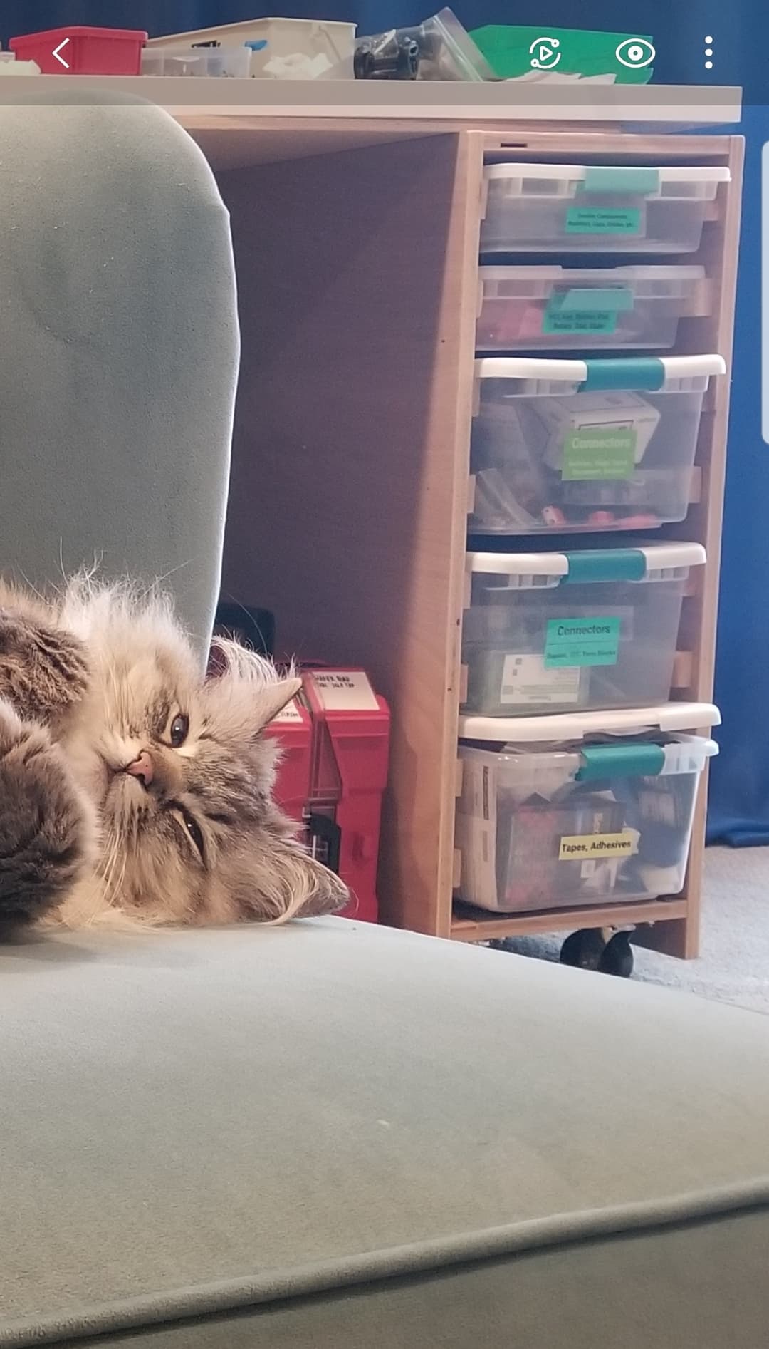

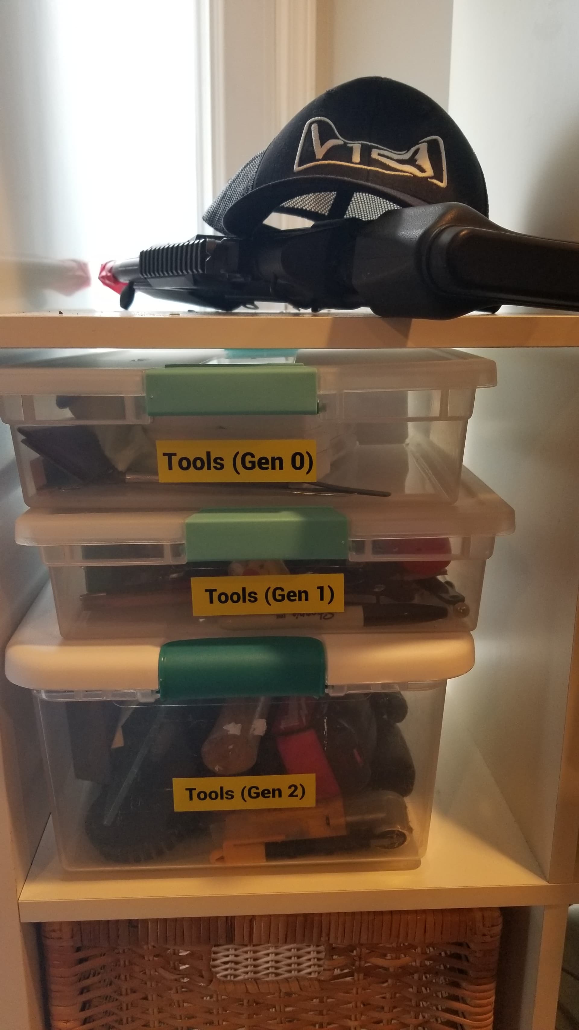

I went with bigger bins. Then I tossed out the removable buckets from one of them and put the little plastic containers that the amazon multi-pack bolts came in into the same bin.
I like to have them horizontal because I don’t always put the bins back where they go. I don’t label the bins because their contents can sometimes be adjusted as I run out of one size bolt and get something else the next time I do a project. Having the bins horizontal, I can pull it out halfway, see what’s in it, and then slide it back in if it’s the wrong bucket.
Kid for scale:
