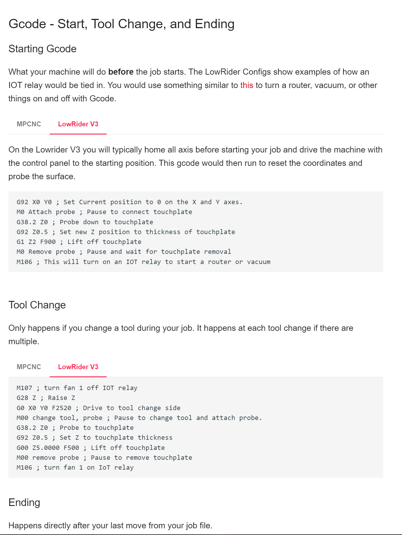

Not cutting struts deep enough
Hello everyone I have finally gotten the LR3 running properly. I do have one problem, which I assume is user error. I am attempting to cut my struts and I have the depth set properly in Estlcam, but when the LR3 cuts, it doesn’t go deep enough. I have seen in the documentation that when using the LCD and once you set the location to where you want you “Select Home Position” in the menus. I haven’t been able to find that on the LCD and I am hoping someone can help me with that.
Also here is the gcode for the file just in case that is the problem:

It may not be your gcode. How are you setting your z height? Probe?
I see g92 in your code. That way assumes z is sitting on your project. Is that how you are starting? I assume not.
Are you starting with your tool touching the top of the material? Because the first thing your gcode is doing is setting the current position as origin.
The other thing to check is your z axis is moving the correct amount - measure from the top of the z nut to the end of the screw, use the lcd to move the z axis 50mm and measure again and confirm it actually did.
Are you using the touch screen menu or the Marlin menu? that is only available on the marlin menu. Not a big deal though. Did you go though the milling basics page and set up estlcam with the start end and tool change gcode? if so then you should be using a touch plate to set Z and then you will cut as deep as you have it set in estlcam. If you havent done that yet read through this page. And make sure you select lowrider tab for the correct gcode.
this is the part your looking for the gcode. But its a good idea to read the whole page,
I am starting with the endmill touching the surface of the project. I guess the thing to do is as you suggested and see if actually goes 50mm
I was trying to locate it in the marlin menu and was unable to find it. I just got the touch plate but I’m unsure how to hook it up to the machine
If you are running the SKR Pro 1.2 then here is where you wire it to. Just like the endstops make sure you dont use +
I also wonder if I am simply not setting the depth deep enough. The material is roughly 3.28mm thick when I check with the calipers (it was supposed to be 3.175) and I was setting it to 3.29mm. If I am every so slightly above the material I suppose that could be doing it.
Yes that is probably not deep enough. Set your cut at 4 and you will be good. or at least 3.5
