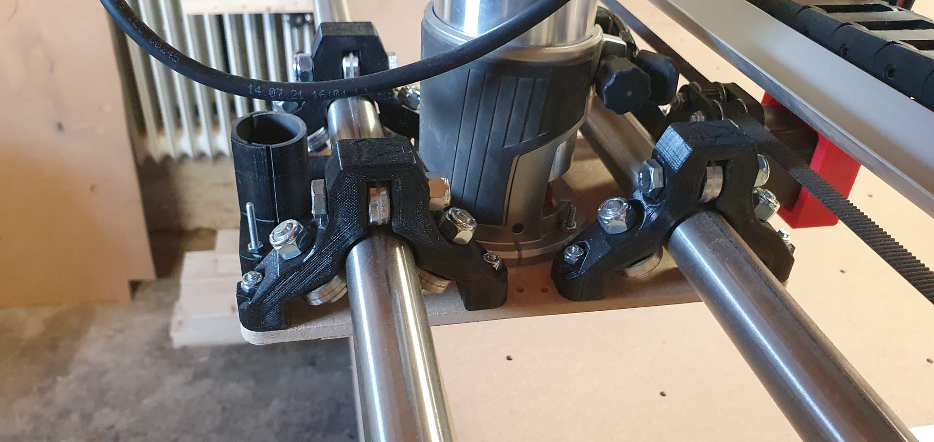

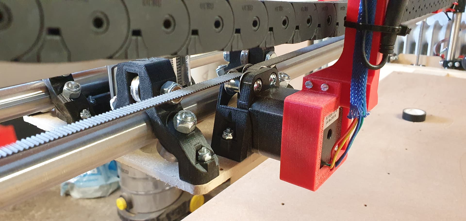

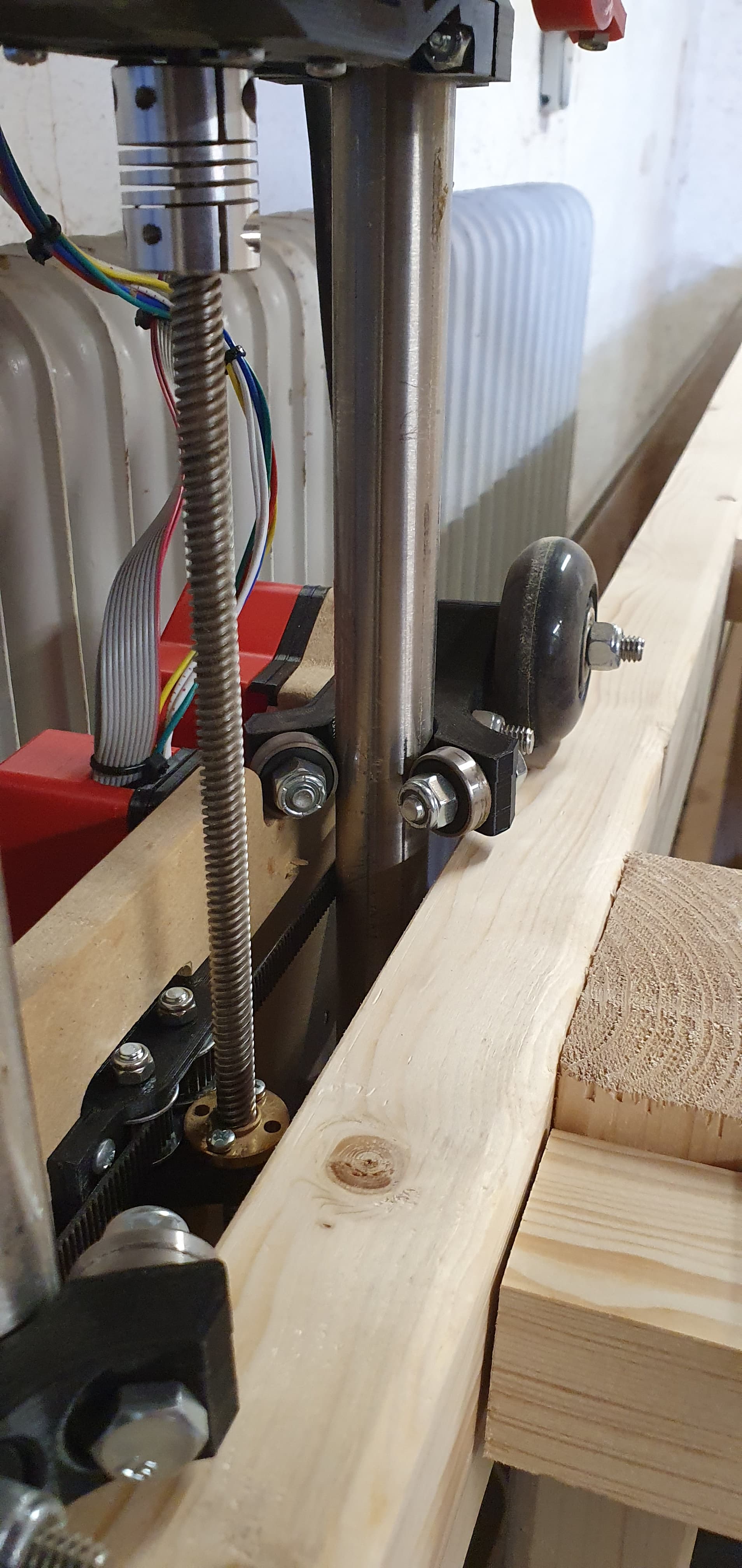

Here are a few pictures of my lowrider. hope someone can see an error that may be to blame for the bad result.
Just to simplify the issue, what happens if you just cut a single 100mm square. Measure the sides and the diagonals and see what you get.
Circles and drill holes and pockets can complicate the issue with additional cam settings but a simple square with a reasonable doc 4-6mm and feed rate of 6mm/s and a finishing pass of .5mm at full depth should make a pretty accurate square. If it doesn’t then the measured geometries should point to the culprit.

I still wonder if it isn’t tracking straight on the wheels, and you need some kind of rail to keep it straight.

Perhaps you could shorten the X gantry a few mm so that the Z tubes lightly brush the sides of the table.
This way the wheels will not be able to translate in an unwanted way.

Understand, so you could try to constrain wheels on Y with L shape aluminium profile
i just bought a pair of u rails for the weels. And going to install them tomorrow, to se if it helps.

Jeg har haft samme problem, hjul glider til en af siderne. Lagde en stribe af kontakt lim, for at se om friktionen ville blive bedre. Det hjalp
Mange tak…
Jeg har brugt et par vinkel profiler på begge sider af y aksen. Men har ikke haft tid til at teste det endnu.
Men umiddelbart lader det til at hjælpe på det.
