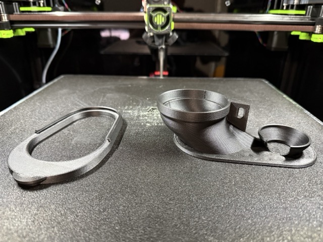

These are my results from the end of my first roll. Absolutely agree that the 500g sucks. I’m not even sure why 1kg isn’t at least an option. It’s expensive, but not exorbitant for the engineering type filaments.
It does stick well enough to my build plate that it is pulling up some of the PEI powder coat. I’ve really had to bring the bed temp down from what they recommend. (TPU started the damage, PET is just continuing to increase the torn up area.)
I am waiting on the larger shipment to have enough on hand for the core and YZ’s, but I’m already dreading overnight prints where I’ll need to get up and switch spools. I do have some orbiter runout sensors in the house, so I’m thinking I may need to take the time to install one before printing the larger pieces with this stuff.
Good results thus far though.
Yeah PET sticks like crazy! Have had zero bed adhesion issues for sure lol. Hopefully you dont have any issues with filament swaps. I only had one with PET-GF, and thats because my printers are set to leave the heaters on for a pause, and it paused right after I went to bed. Got up the next morning and fixed it, but when I restarted that part that was in the nozzle heated up all night was burnt black. and Now my pretty Blue PET-GF core has a black stripe in it lol. Thankfully that was for my personal machine and not for a customer one. I have now set my pause for the extruder to turn off after 10 min and the bed to stay hot so I don’t lose a print on an overnight pause.

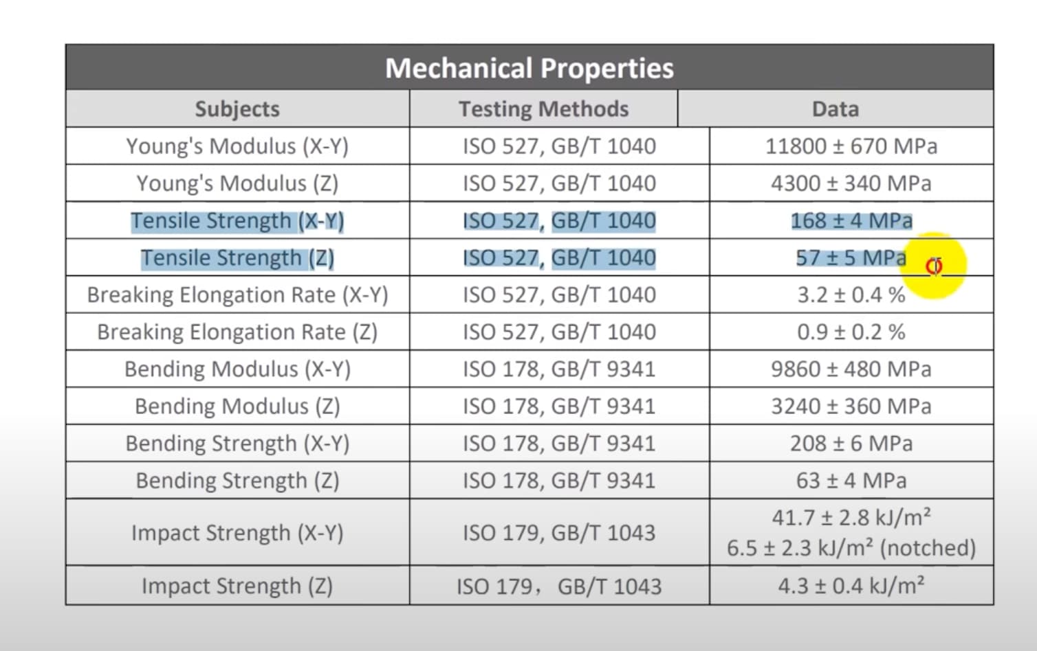

Anyone seen the PPA-CF from Bambu Labs? Clough42 just did a video on it and it sure seems insanely strong! At $150 for 750g a LR4 might be a little pricey but it would be cool to see!

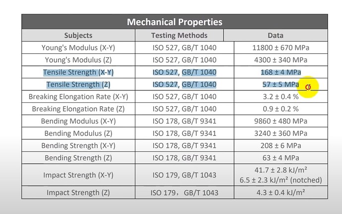

Screenshot of the mechanical properties from the video.
He spent a lot of time testing, but seems like he pretty much achieved the stated numbers.
Im no engineer, so maybe this would be like butter for our use case. But just thought it was cool. :+1:
We don’t really need strong, most all plastics are plenty strong for what we do. We are looking for stiff/rigid, young’s/ bending modulus, then low creep, then temp resistance.
Looks pretty stiff. All the failures were brittle. He managed to achieve the claimed strengths there so presumably the specs can be trusted somewhat.
XY Young’s Modulus: 11.8 GPa vs 4.3 GPa for Ultimaker PET-CF.
Z Young’s Modulus: 4.3 GPa vs 2.4 GPa for Ultimaker PET-CF.
Temp resistance is no problem, it’s printed at 300°C and annealed at 150°C
No idea about creep under load. Presumably that’s something that’d need to be tested specifically as I don’t think I’ve ever seen a spec for anything like that?
