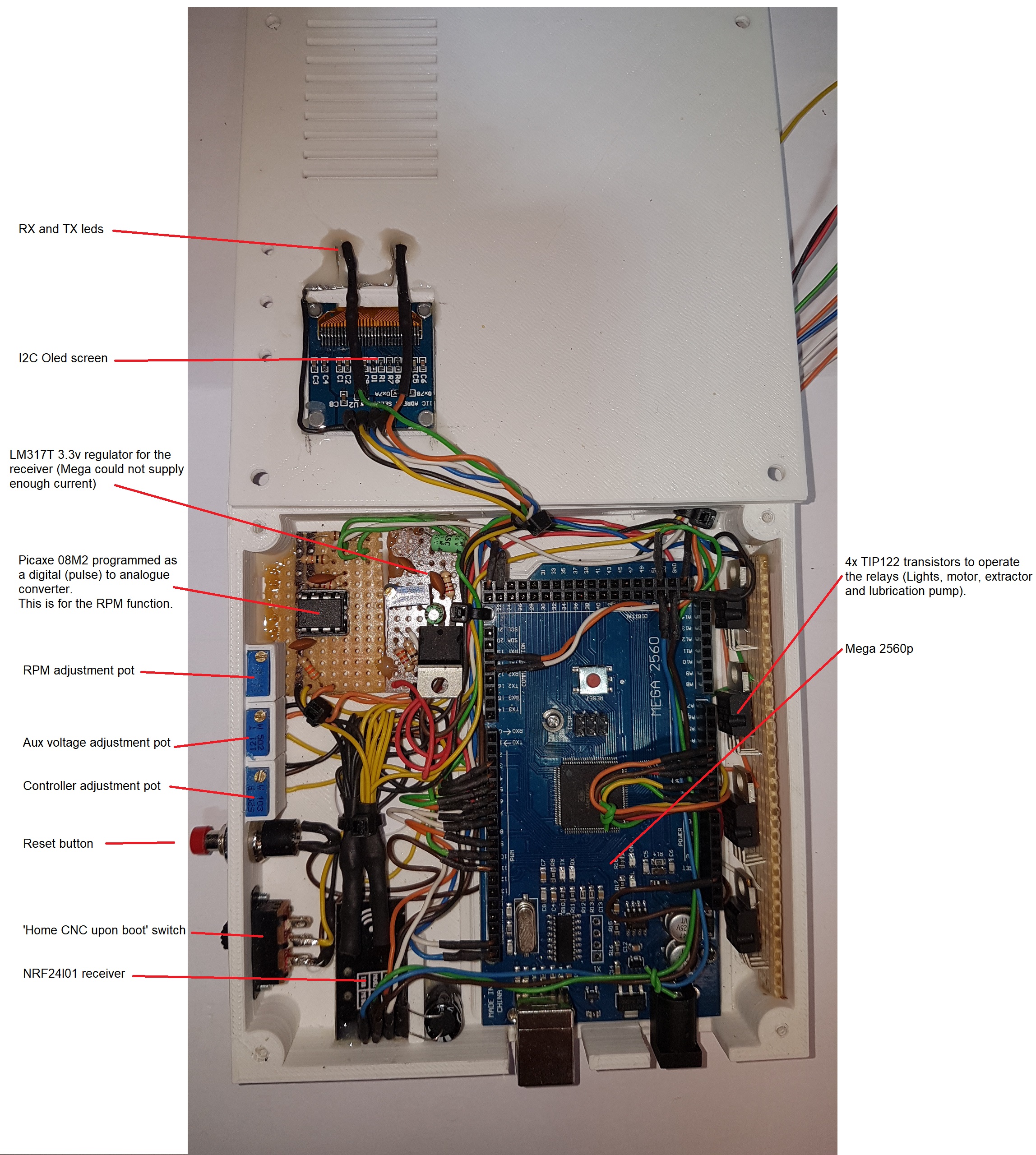

Just realised I never updated this thread about my wireless tablet controller.
So, a little tweaking to go, but essentially there.
The receiver is mounted under the CNC with the relays. This talks to the Rambo controller on it’s own serial port, so you can still use Repetier on the USB socket and the LCD screen all at the same time.
Upon CNC boot (Rambo boot), it retrieves the current data and also will home X, Y and Z if you wish (a handy function I find).
The wireless handset is very light, and I might even shrink it down further.
Has a 4000mAh Lipo inside. Runs for most of the day without issue.
A tilt switch inside shuts the screen off after 2 minutes if it hasn’t moved. Comes on upon movement.
4x Buttons on the left control the LED bed lighting, tool power (both laser and router), extractor and I have put the facility for a later date lubrication pump.
Displays X, Y and Z - taken from the Rambo. It tracks it’s own position commands (if you send X+100, then it updates it’s own screen first). But every 60 seconds, it does a compare with the Rambo to ensure they both match.
RPM is not quite finished. I have made a digital to analogue converter and its all working, but I need to install the optical disc on the router to deduce the IR pulse.

Voltages are also shown on the setup page. The adjustment pots are the fine tuning for how much the voltage has to drift, before it updates the handset (you don’t want it polling the handset constantly with updates on every 0.01v fluctuation).
I have it set at 0.5v.
