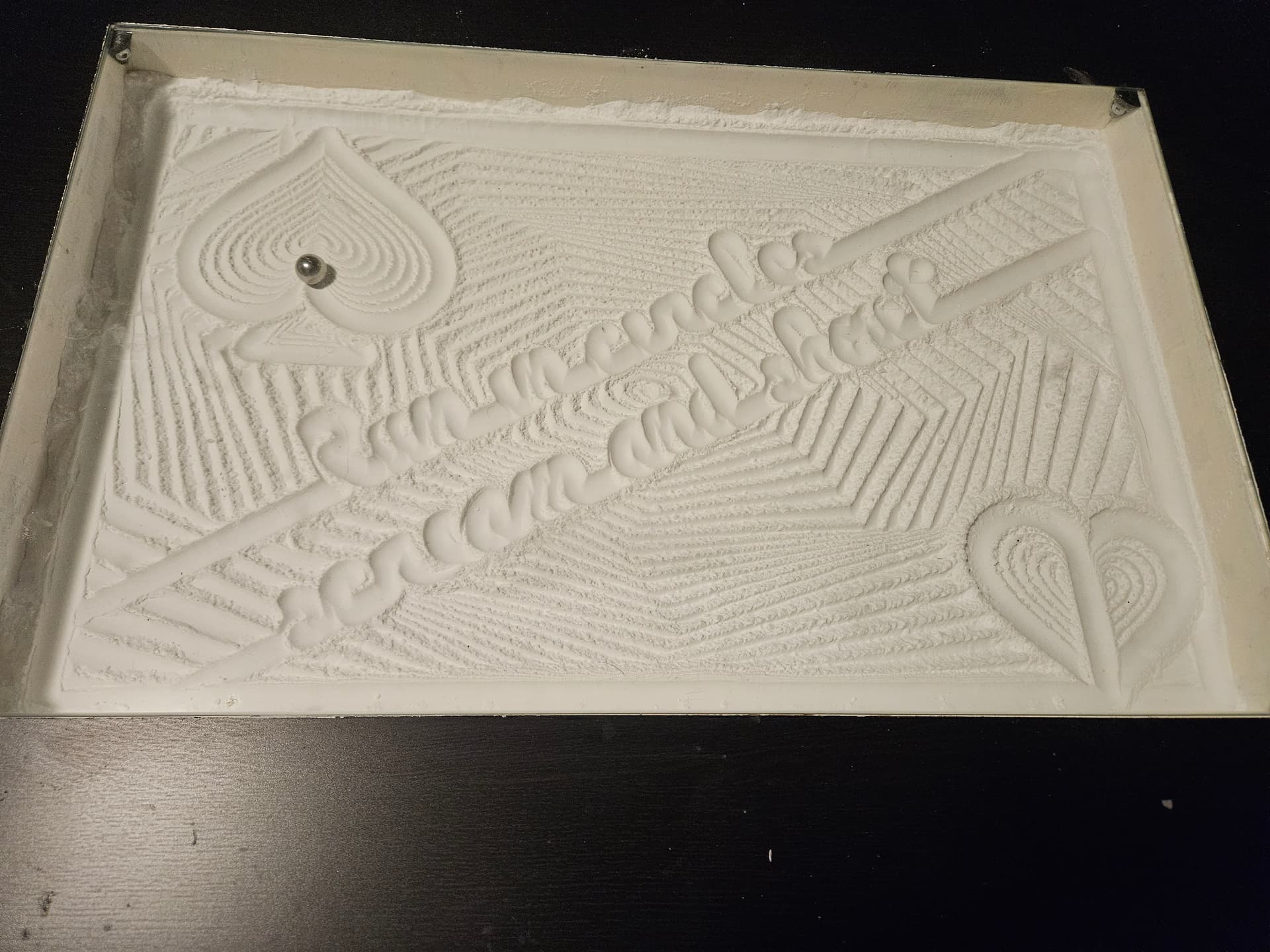

Well, I am stumped. Gonna have to just learn and live with it…which shouldnt be hard cause it looks GREAT! I just cant get the LEDs to draw more than an amp. I know that proper LED supplies are generally constant current, while I am only feeding constant 12V, but the gulf shouldnt be this big.
I am using the wLED limited to cap at it 1500ma anyway. I am pulling the Vin from the controller through the fan connector to power the entire LED setup. Per the documentation, the fan and barrel jack on Bart’s board are good for 3A max. I put my ammeter on the supply and tested white LEDs, “full” brightness (the fullest I can achieve), and ran a sample gcode. Never pulled more than 1.5A so I should be good.
Gonna do a little more wire management then I can show the final product!
Again, thanks to this whole community for inspiration and advice!
Not for addressable LEDs. The little circuit in the strip does the constant current driving for you.
You might ask in the wled forum. They are pretty nice there too.

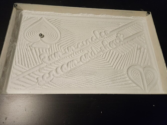

So my beta build broke last weekend. I put something too heavy on it, and it popped the sandbox out of the ikeaboard. I thought “For sure this time I’ll do a complete rebuild!”
Nope. Epoxy, clamps, and the beta is still chugging along.
I still have some janky hacks (80’s era cell phone prints, lol) for end stops, because these parts didn’t have the new optical stops yet. Still running on a RAMPS stack with the DRV8825s
And it still works great.
I’ve built some of the release version, but the parts I’ve printed to replace this one are still in a filament box on the bottom shelf, because it works.
Still, I do have problems with the janky hack end stops that I should really fix, but this being the first one keeps it in a special place, and it’s still super cool.
I have a release one running GRBL-ESP32 at a friend’s place, and one running FluidNC, which are quieter, and don’t have the same problems. Better for other people who can’t troubleshoot as easy as I can.
