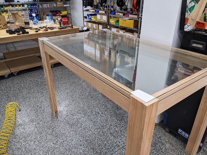

Mocking up the 3ā€™x5ā€™. I think I am going to take the easy way on this one and just use some black stain. I found some really really nice wood if I want to actually make a fancy one but I think I am going to run with this doug fir stained black for a while to see how it works out before spending the big bucks on the fancy wood.
I started a Onshape assembly but it was taking too long so I just started building it. Turns out the assembly process is very different from solidowrks. I can crank out the parts and even mate them but making it fully parametric, appearances, and file management is a bit wonky and I need to watch some videos instead of just sitting there getting frustrated.
I have a half way workaround for the CAD of a basic table just to get some files out there ASAP if it takes too long.

Getting there. I think this is a great basic design to share. I will work on a complete parametric assembly so anyone can edit to suit their needs. This is bar height, and 3x5ā€™ so I am confident anything smaller (or larger and shorter will be fine). It is pretty stout even without any glue yet.
I had fun, happy with the results after a minor redesign, and just happened to have very little waste. Next up is fit the printed parts that are still printing. Then LEDā€™s! The Last step is stain or rebuild with nicer wood.

That looks nice.
I think paint like black or white would look pretty good. i bet you can still see the wood grain shape through the paint with that wood. What are you doing for the flashing?
Well I have been looking around all day for my little can of black stain to do a test. Of course, I canā€™t find it.
I think either black vinyl from the sticker cutter or mask and black paint. Unless there are some other suggestions.
