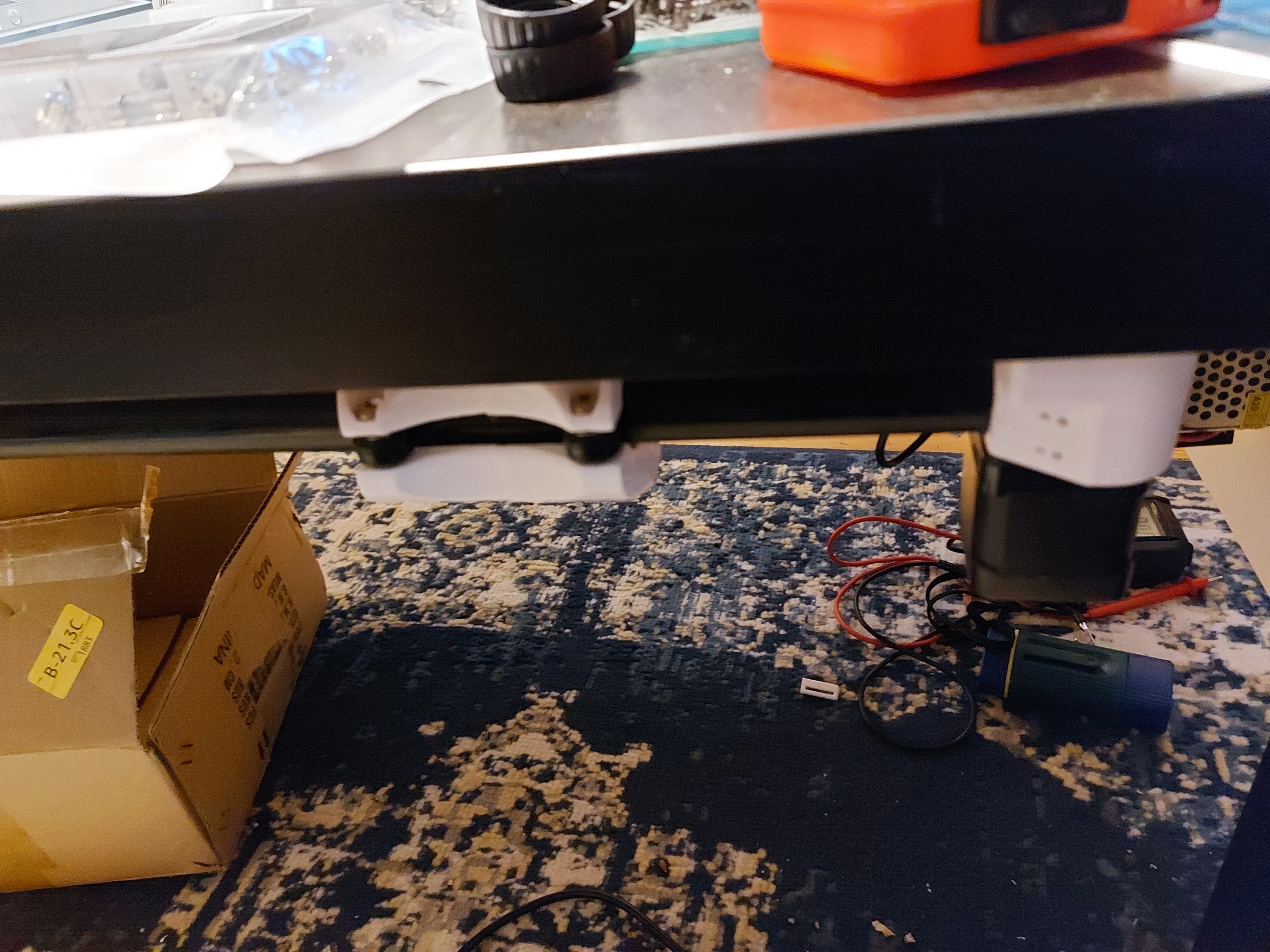

Zip ties might be one of the non-IR opaque plastics. I think I tried using them as flags. Might depend on what color…
I was triggering with a zip tie on my printer for a while, until I moved to one of those aluminum zip tie things with the adhesive backing.
“natural” nylon isn’t really apropriate, but black (or as I tested, red) is okay. YMMV
I like the trimmable aluminum idea, it’s pretty much what I’m using for my table now.
Finally, sat down and really took a look at everything. I like it. Two tiny changes. I am going to extend each trigger 1mm, super quick tweak. The other thing is adding a couple wire anchor points on the motor mount blocks. The wires are super close on the X trigger so it is necessary.
Besides that this homing sequence works swell.

Looking forward to the RC release, looks like I’m going to need to find those endstops, since they’re different from mine.
I ordered a bunch of them with different wires but they are not here yet. I think I have two more of these though, you just need to shuffle the pins on the plug side. I will check and send them out if I do.

I found the same opto endstops, but 3 weeks to ship :sob:
I’m going to try to play with the ones I have, since now I have way more than I’m going to need for the forseeable future, even if I change all my 3D printer stops over. I’m going to try to move the wire harness to the same side as the endstop. I might have to do that with regular pin headers instead of the ones it has though.
Edit: Even if I do change that, the mounting holes probably won’t line up, since those have the mounting holes outside the wiring harness location, so I might have only 1 screw holding each endstop. I can probably make do with hot glue or something. It’s not optimal, but I think it’ll work okay.
