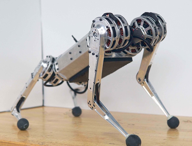

I retired recently and have determined that I need long-term projects that I can work toward to keep the old noodle active. My current long-term project is to build something akin to the MIT mini-cheetah:
not an exact copy, but something in that class of robot. So I expect to be needing multiple copies of fiddly little 3D parts… hence the delving into CNC…

I dunno, I’ve been beating up my MPCNC pretty badly over the last little while and looking at that little guy, I feel an MPCNC could do it.
I haven’t read the specs, for all I know it’s made of titanium, but I’d bet you could clone him in Aluminum.
