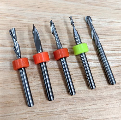

There is a multi bit pack in the store for 1/8" bits that would go a long way for getting started.
I ate a few bits getting started out (I skipped foam) so if you can’t wait to make chips in wood having a cheap bulk pack of simple single flute upcuts never hurts for the $1/pc-ish cost you can find them for.
I started with cheapo 1/8" compression bits to learn with and then added higher quality bits as I needed them. I work exclusively in wood products at the moment and the Whiteside RU2100 1/4" Upcut has been my go to for most projects. Midrange price, available on Amazon Prime, and cuts wood like butter.
I’ll second that opinion, seems to be a good all around bit for many tasks and nice having ready availability…
