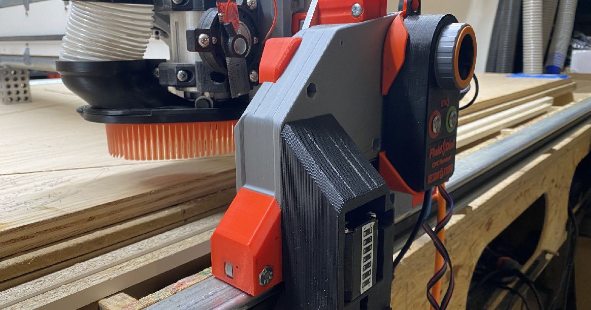

I love the mod, and it has been working great for quite some time, and it worked great on the LR3 for a long time.
Your thinking makes sense to me. If you don’t learn the machine’s capabilities before you mess with a hidden belt mod, you won’t have any experience to compare to.
For my own case, I have not noticed any difference between the machine’s capabilities before and after. Moving the belt down can have a detrimental effect that compounds over how much distance it’s moved, so I sought to move it as little as possible to meet the goal. If this mod is costing me any performance, I’ve not been able to detect it. It may be that some expert could devise a test finer than my real-world experience. Anyhow, it’s working great for me.

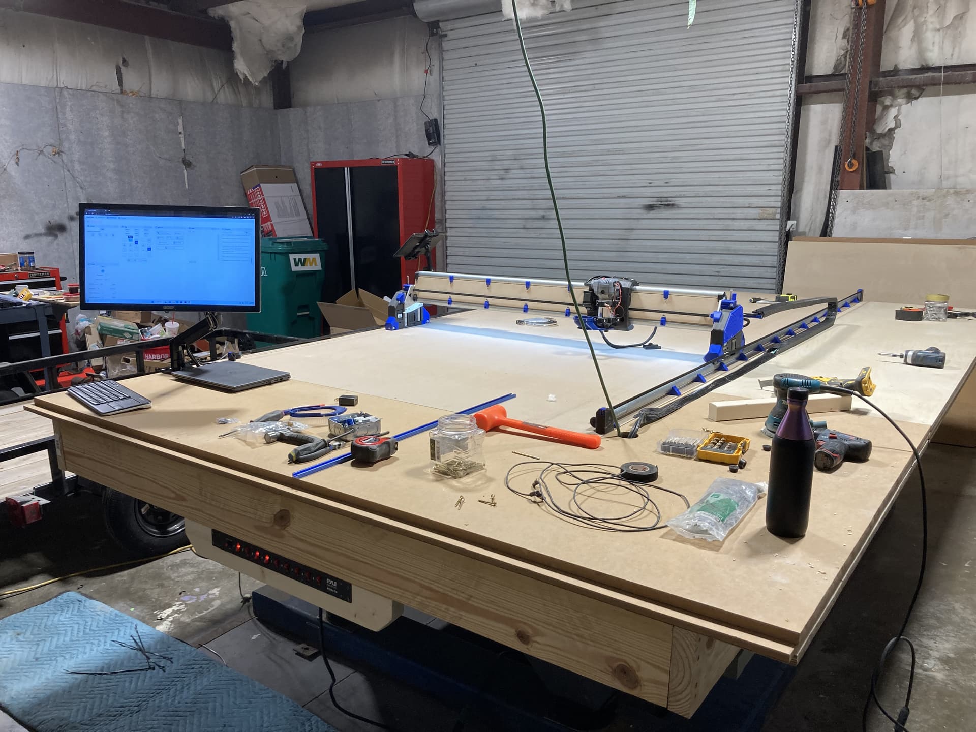

Didn’t take time to snap a quick pic of the progress as I was already late to meet up with the wife for drunkin painting (drink wine and pretend to be an artist for a couple hours…don’t know anything more about it, but I will report back) so I was already in the dog house. But…we managed to get all four belt retainers mounted and the belts tensioned, installed the micro computer, the monitor arm, and the touchscreen monitor.
Next I have to drop power to the table from the ceiling. Has anyone used anything like an AV rack outlet controller to manage the power to the various devices, LR4, router, computer, monitor, dust collector etc?
Also, is there a specific power down procedure that I need to follow so not to damage the controller when turning the LR4 off?

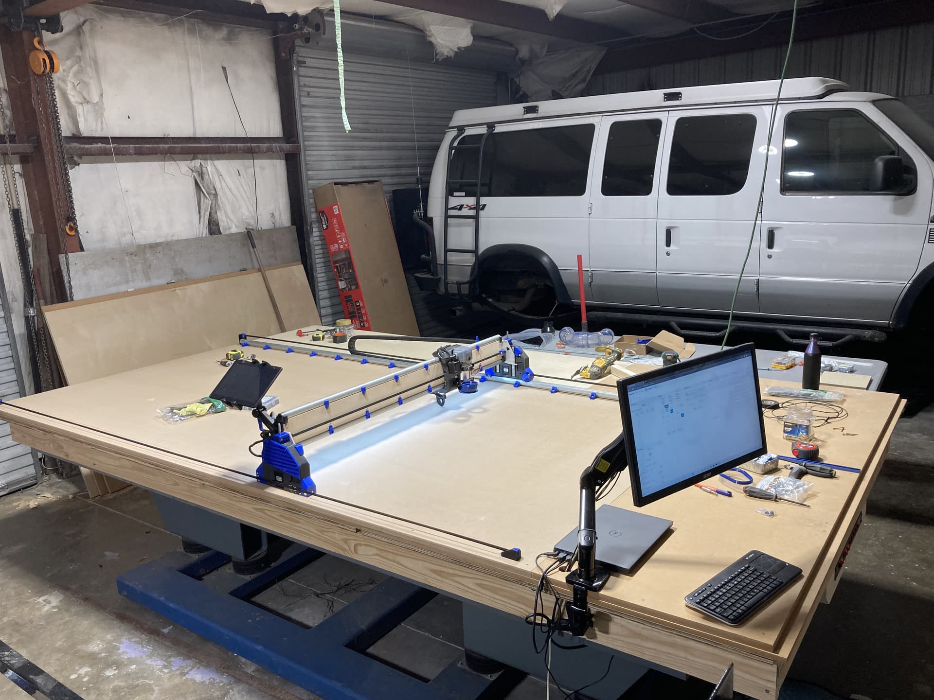

Ok…got some updated images…
Got the touchscreen operational on a temporary laptop while I finish configuring the micro computer that will be mounted under the table. Have power distribution installed under the end of the table with separate switches for the CNC, Spindle, Computer, Monitor, and Dust Collection.
I have movement on all three axis and will start the process of setting up all the proper configurations tomorrow.

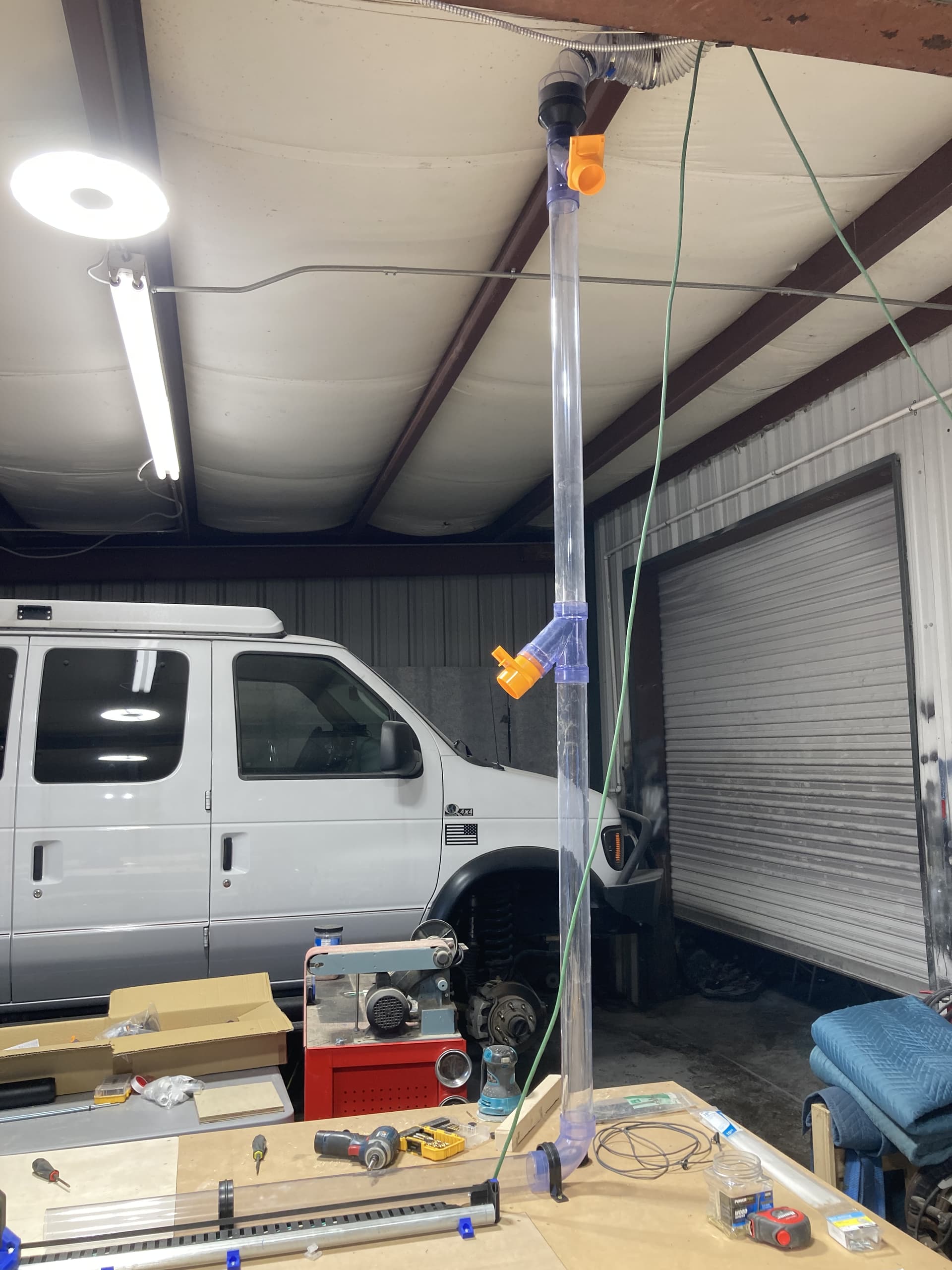

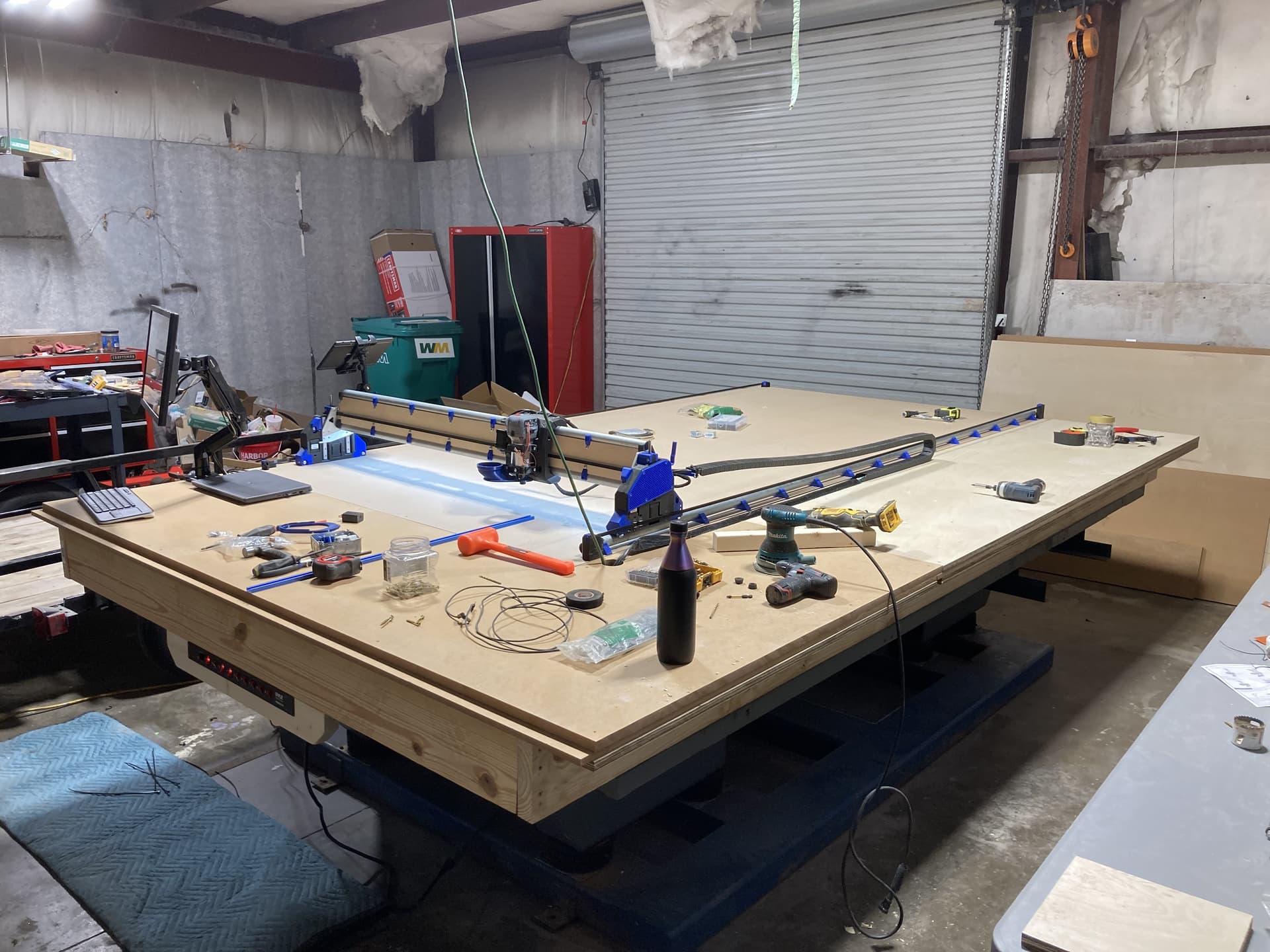

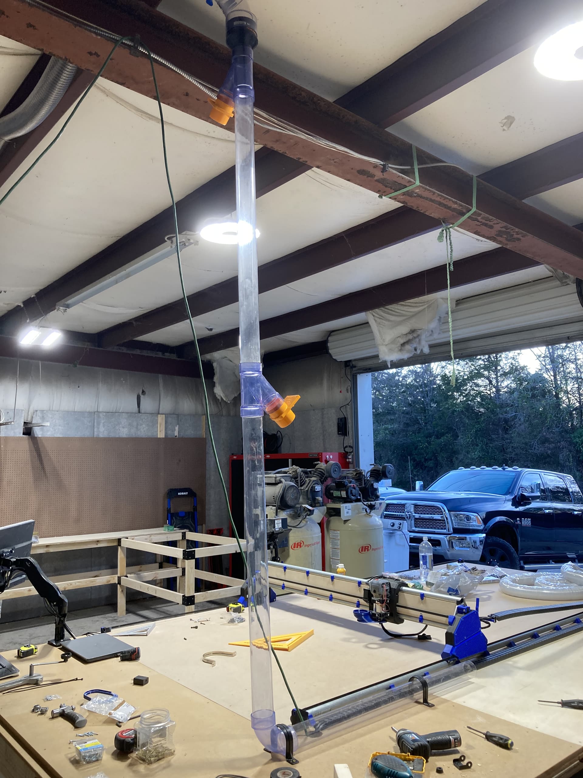

Finally got power run for my dust collector and started my hardlines. I was able to add a remote relay in the dust collection circuit so I can remotely turn it on and off with a keyring remote hanging on my monitor on the CNC table. Hopefully today I will adding in the softlines and figuring out how to get the LR4 to move through full range of motions without hanging up or causing binding.
You can see I already have my drag chain mounted and fully functional for power to the gantry, LR4 and spindle. That part already works very well. I bought the 10 gauge wiring and conduit to get power to the table vs the current extension cord. On a side note, has anyone priced copper wiring recently?!!? OMG! Anyway…should have more significant updates later today as I spent much of yesterday building out work benches and routing 4” dust collection trunks around the shop. Next I have to get the air compressor installed and plumbed as I also picked up the wiring and disconnect for it.

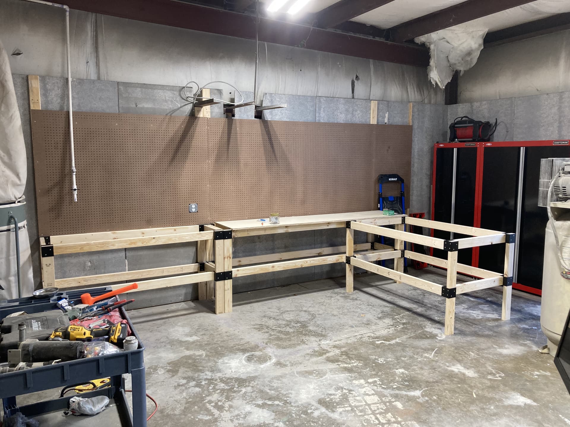

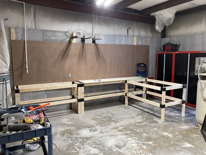

The 30” wide extended workbench will have retractable castors that can be lowered and the workbench disconnected from the main bench and rolled around the shop as a work/build table that attaches to the main workbenches when not needing to be mobile. That way I can have an island work table that is not taking up valuable shop floor space when not in use.

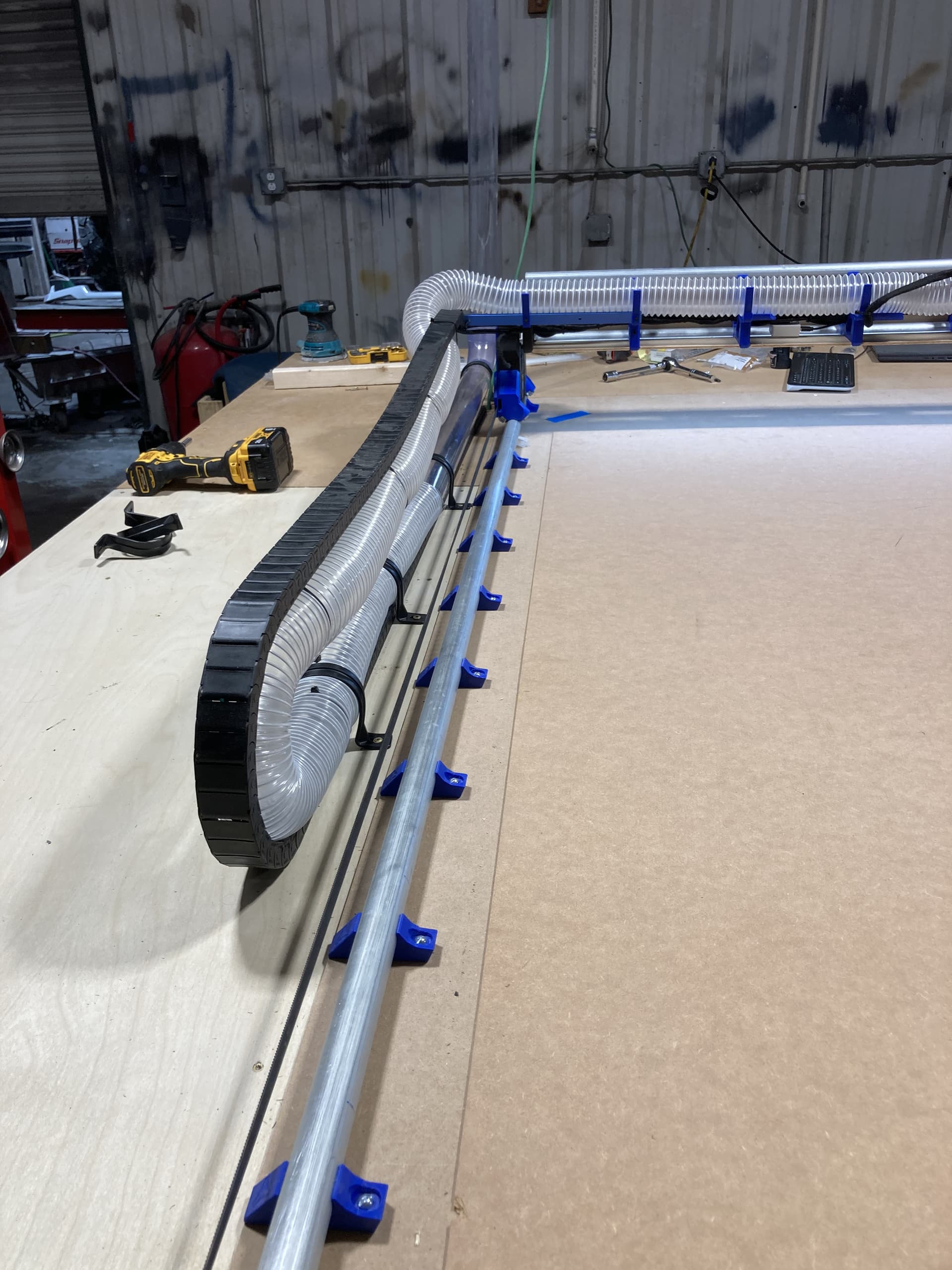

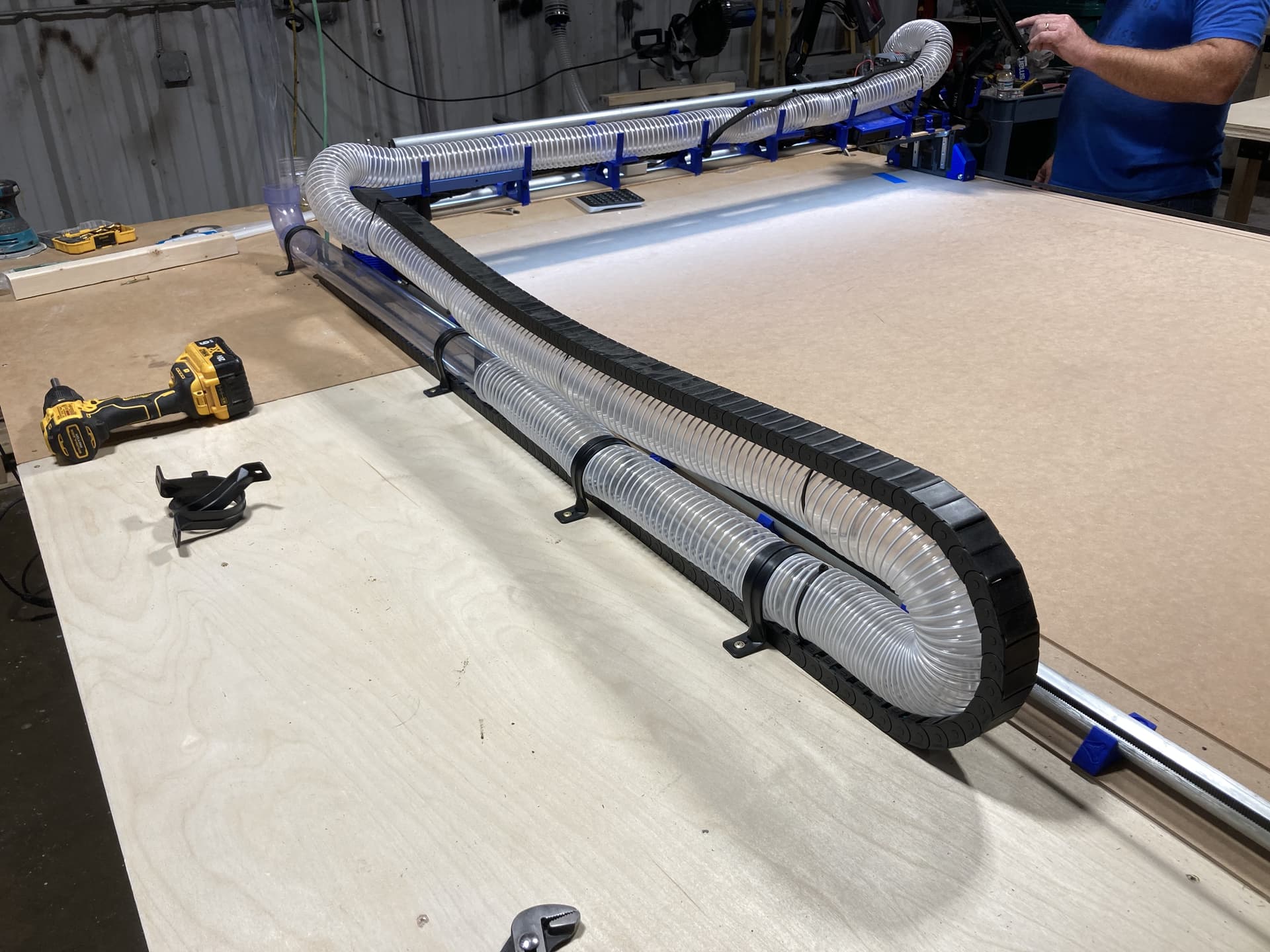

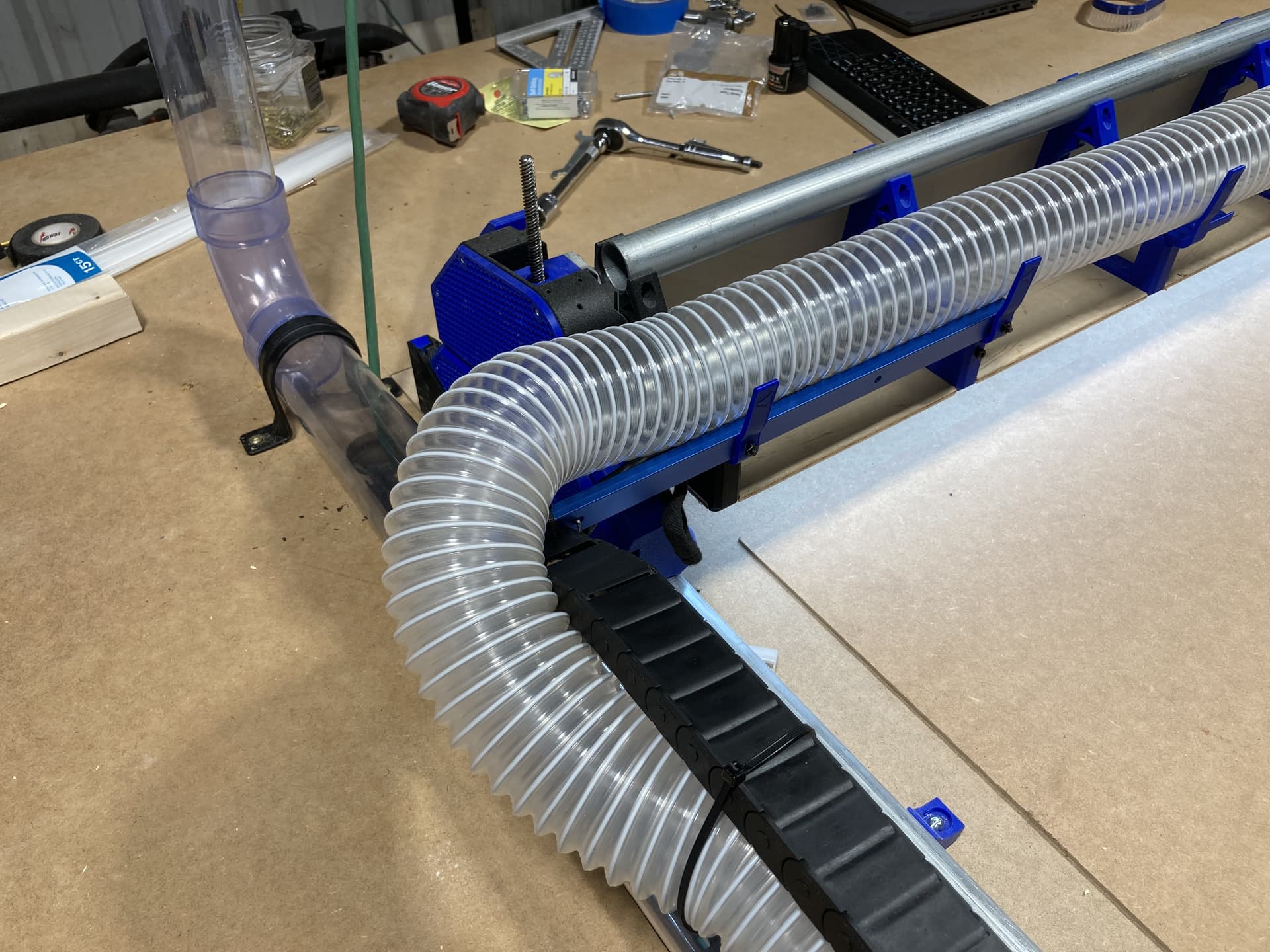

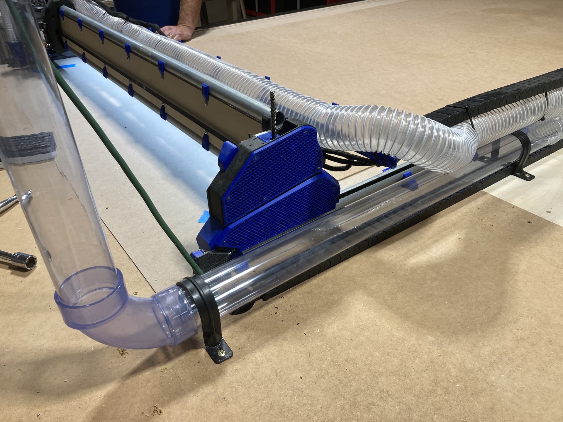

Ok, now lets talk about dust collection and power cable management. I read everything I could find in the forum as well as watching tons of videos. I came to the conclusion that although there are numerous ways to do it incorrectly, there does not appear to be a single solution that works for everyone…so I designed my own.
I used commercially available light weight drag chain and 2.5” duct hose. I purchased a pair of 12 gauge stranded copper extension cords and stripped the outer coating from the section contained within the drag chain so it was much more flexible. I left the coating on the section threated though the LR4 trusses, one for the Jackpot power supply and one for the spindle motor. The other end I plugged into the power distribution mounted under the end of the table so now I can control everything separately.
I fabricated an extension arm from light weight T track (also blue) and bolted it to the X Axis hose supports so it extends beyond the guide rail. This enables the power to be internal to the chain and the dust collection hose strapped to the drag chain without interfering with the Z-axis movement.
I filled half a bucket with cut zip ties (easily 150-200) trying every possible routing and variation before we got it dialed in.

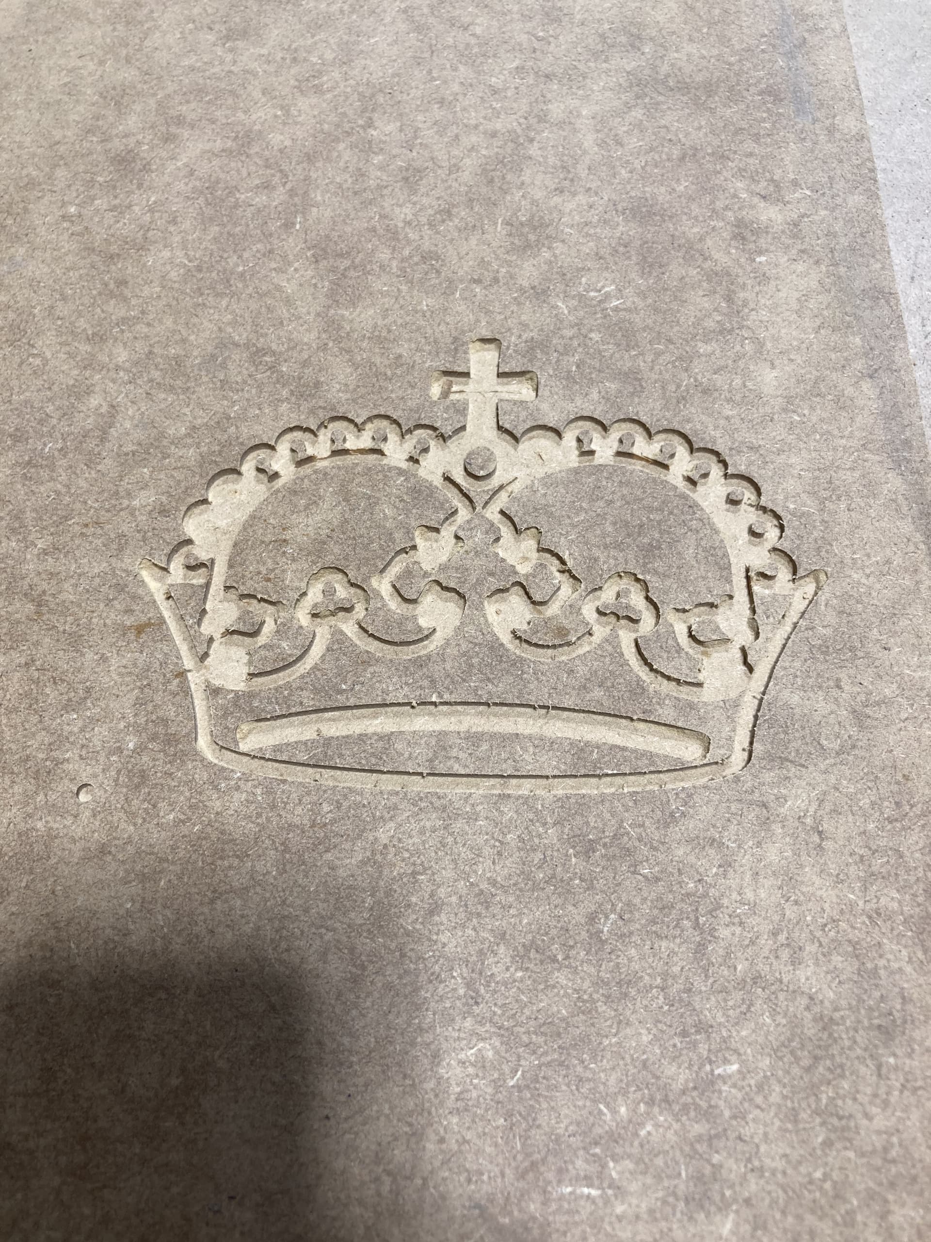

But, the result was completely worth it as we made the obligatory test crown before leaving the shop for the evening.

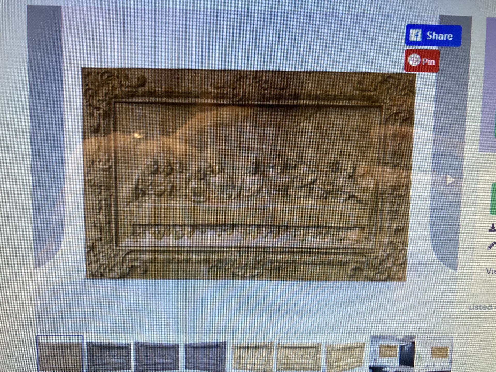

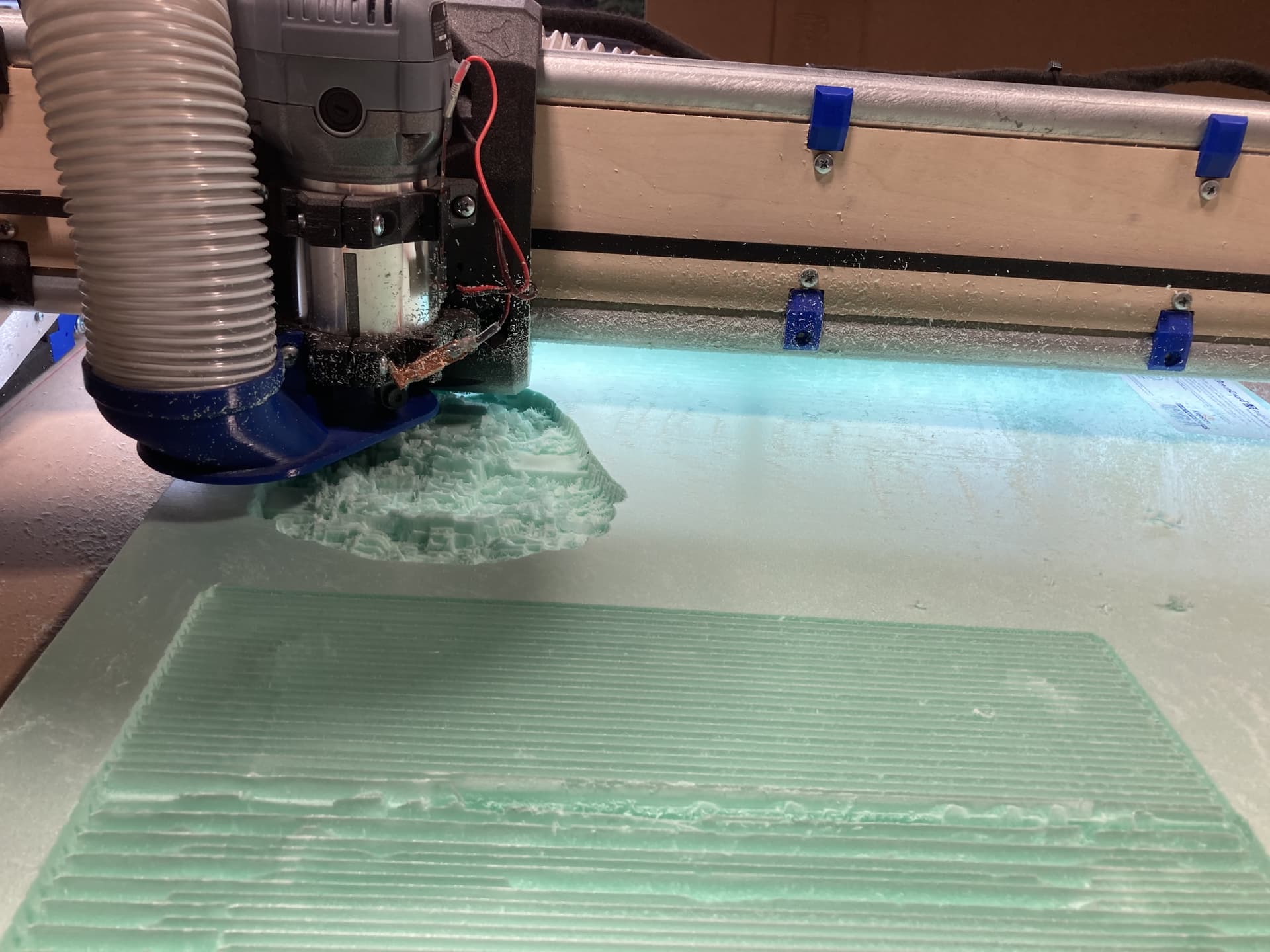

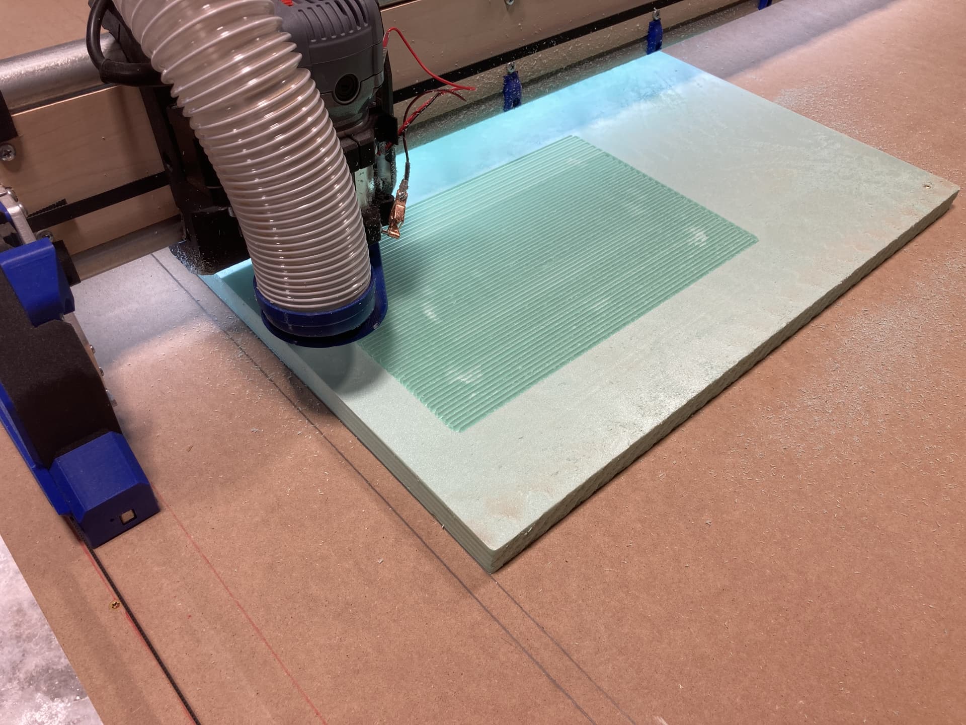

Ok…I am going to need some assistance please as I am a bit frustrated after a quite unproductive afternoon. I downloaded EstlCAM and working through the online config and a call to Jonathan to understand that I was attempting to use EstlCNC vs EstlCAM, we got it configured to what we thought were the correct specs for exporting gcode for the LR4. We then configured a couple tools. Knowing I wanted to carve and having already snapped the tip off yesterday of the only v-bit I had purchased from Ryan, we purchased a 1/4 shank 3/16 taper carving bit with a 7.5 degree angle at the local WoodCrafters. I then purchased a couple pieces of foam in which to play. I added the new bit details into a new tool and saved it (on the the second attempt).
I then logged into Creative Fabrica and downloaded the STL for an image I wanted to attempt to carve. I imported it into EstlCAM and then exported the gcode.
And started the carve. It estimated1.5 hrs to carve.
This is not the last supper so I finally stopped it after 45 minutes or so and then went back online to download a smaller carving.

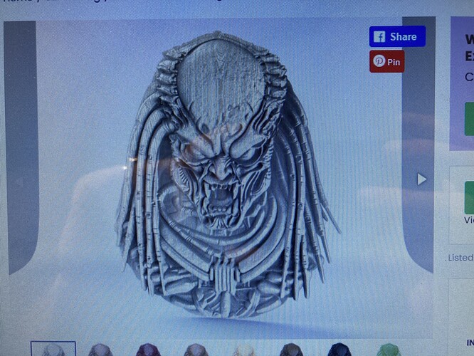

I selected a Predator and adjusted what I thought were the settings, increased feedrate to 60mm and max depth to 12mm and exported the gcode. It said 25 minutes so I uploaded to the LR4, rehomed, established the work home, and probed the bit again to establish Z and started the carving.
That is NOT the face of a Predator.
Needless to say I am a bit frustrated this evening. I am hoping someone/anyone can provide some assistance even if it is a known good gcode for testing carving as my goal is to do carvings and eventually inlays on this LR4….but after today, that does not look to be in my future anytime soon…and I’m beginning to question my decisions
What’s the Maker site, does it generate .STL or gcode files?
Am confused by “imported it into EstlCAM app and then exported the gcode”, did you import a .STL or gcode into EstlCAM and then export gcode again? I normally see people importing .STL, .DXF, .SVG into EstlCAM.
Asking because opening a .gcode file in EstlCAM ends up launching the “EstlCAM CNC” app which you can use to send gcode to your connected CNC, and control motion. Are you using “EstlCAM CNC” or FluidNC Web UI to control your LR4? Sorry if you mentioned already, I didn’t read entire topic.
You are trying to start out with one of the hardest things to do. Maybe start with a few simple boxes first until you understand the machine and software.
Inlays are completely different from 3D-carving when it comes to machining. I have some tutorials up on it on YouTube.
I was incorrect. I downloaded the STL not gcode. I opened the downloaded STL file in EstlCAM, selected my tool (Carving Bit to I defined in the tool list), edited the feedrate and max depth, and then exported the gcode from EstlCAM (to include the configured start and end code from the EstlCAM setup performed earlier when configuring the EstlCAM) into the exported gcode.
I then copied said exported gcode file onto the Micro SD card (supplied by Ryan to Jonathan with my build parts as not to be an incompatible card) and then ran it (selected the file from the SD panel and pressed the play button) from the FluidNC Web UI LR4 control interface using an android tablet attached to the LR4 gantry and connected to the LR4 via it’s AP. I also mounted a full computer on the table to run EstlCAM and make edits to the gcode files and then transfer them via the SD card as there seems to be potential issues if you try to connect directly to the JackPot board other than through FluidNC Web UI via AP. I plan to work on that issue in the future, but now, the SD card sneaker net works.
