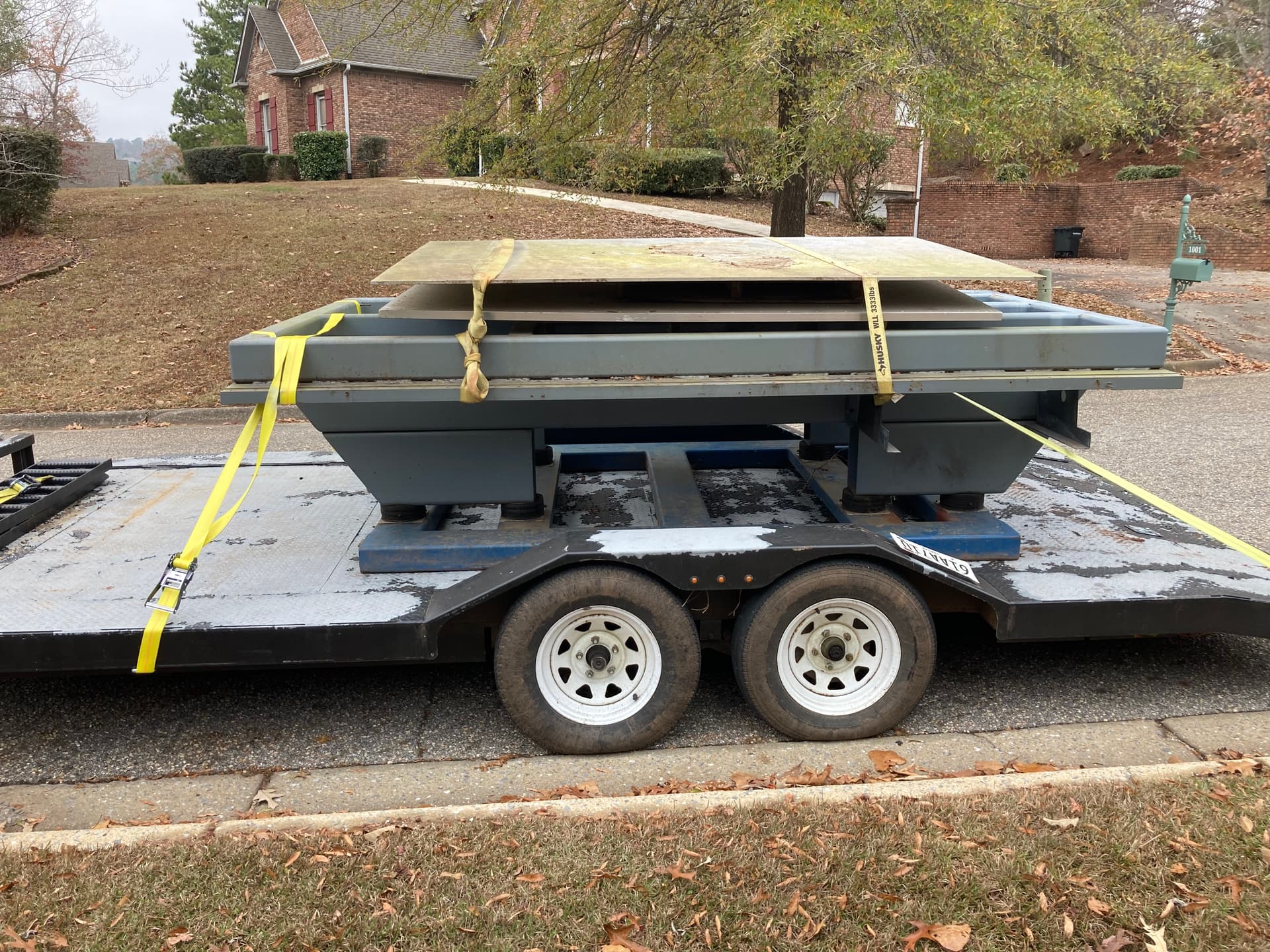

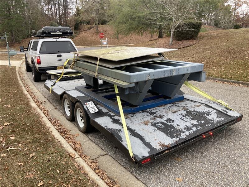

Well, I went and picked up the CNC table this evening….I am concerned about parking the trailer in my driveway as it might crack my concrete. I took a car hauler with me to carry it back, and this thing has to weigh several thousand pounds. I think I am going to go weigh it before unloading it just to see how much it weighs. I will post some pics tomorrow.
Well…I stopped by a scale on my way to unload and this table weighs in at 5k lbs…but it’s level :rofl:
Should probably be sturdy enough
LOL one should hope with the weight and rubber isolators….after I cut off all the un-necessary parts and repaint it, I’m going to do some model numbers as OVERKILL 9000.
I want tio see your uloading process. Yikes!
Sounds like you could put your car/truck on it for the next oil change!
Great thought on the unloading Jim. The unloading process was the reverse of loading it over in GA. The ol guy had a rollback with which he slid under the table, and used his winch to drag 60% of it up onto his bed then I backed the trailer under it. So, back over here i hired a rollback to reverse the process and winched most of it up and onto their bed. Then he backed the rollback into the shop and slide it off onto the floor via gravity. I should have videoed it, but I was an active participant in the process.

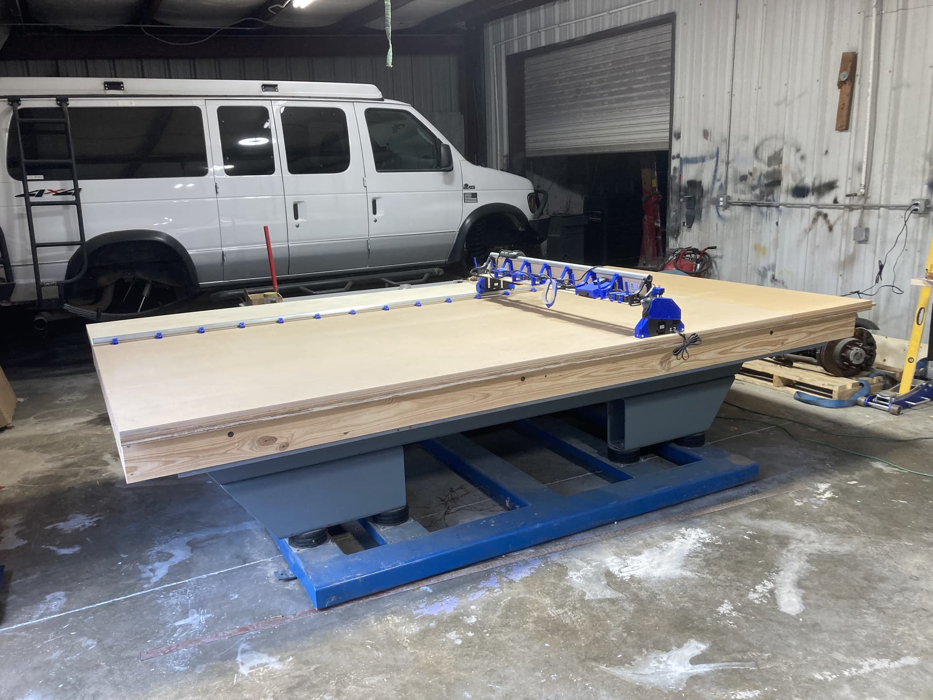

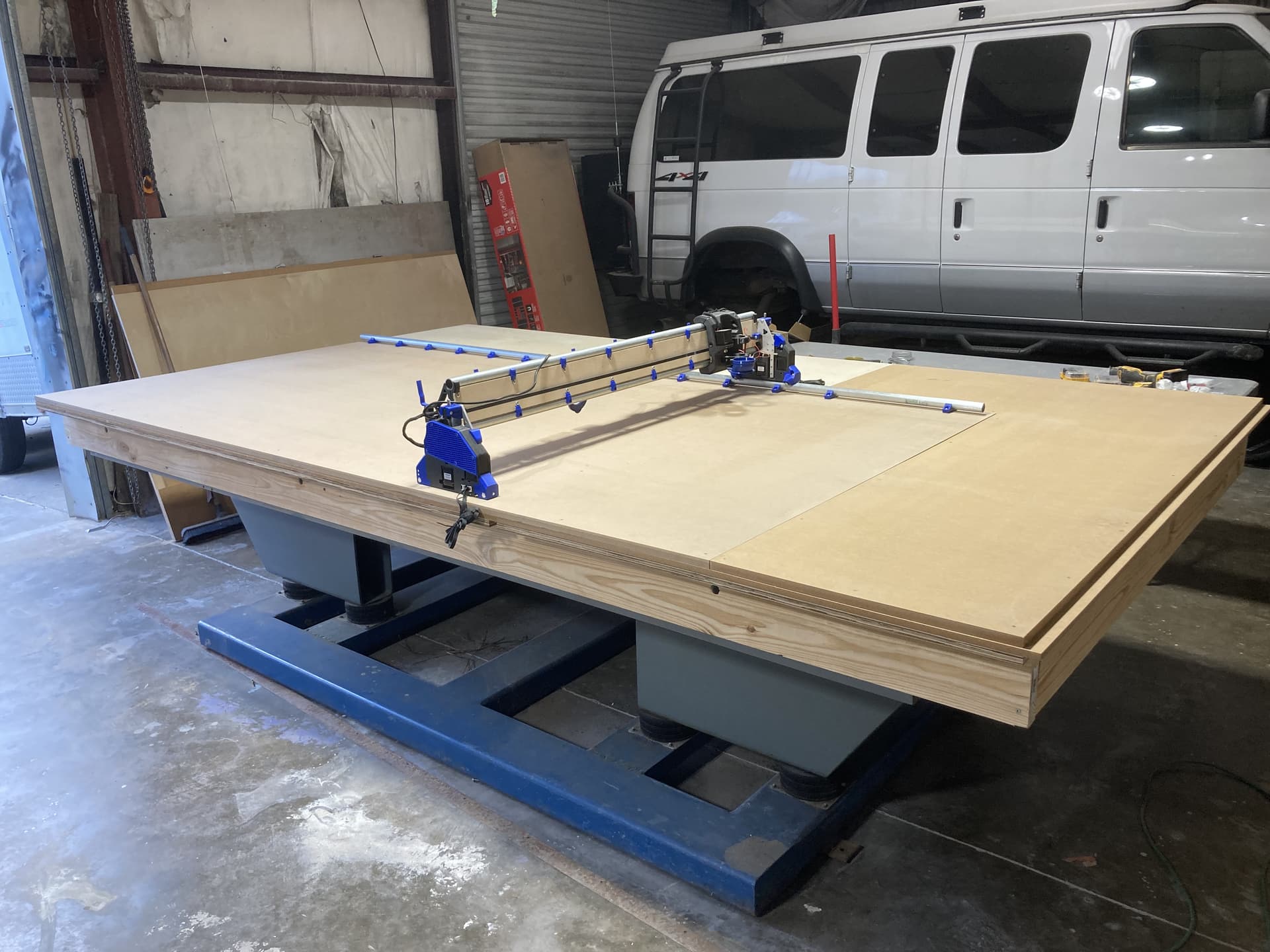

I know there has been a bit of a time delay since the last update…but, with some engineering, we were able to build a 2” thick top (required by the 1.25” thick vacuum bed) so we used 3/4 plywood, 1/2 MDF, and then the final 5’x10’ 3/4” MDF board over the entire surface covering the the vacuum plate as the spoil board. We also ran an outer band of planed down 2x8s resting on the original gantry tracks to provide additional support for the outer edges. This design enabled a 12’ x 8’ work surface. I will be adding an under mount router on the opposite end of the table.
I snapped a couple shots this afternoon as I was leaving the shop to show the progress.
OH! I forgot to mention a really cool discovery. What I thought were rubber isolation pads between the table base and bed ended up being airbags to level the table on an unlevel concrete floor. I did not expect that, but glad they were there. I discovered what they were when I saw a nipple with a valve stem cap on each of the rubber “isolators” …as I stated…newbie. :zany_face:
…also for those of you keen eyed makers out there…yes, you will notice the extra 1” of MDF extending beyond the end of the table due to the 97” length. Once I am satisfied with the table top, I will be using a flush bit around the perimeter to clean up the layers. Also been thinking about inlaying a replaceable hardwood bumper around the entire perimeter to protect it from damage as we move other equipment and material around the limited space shop.
