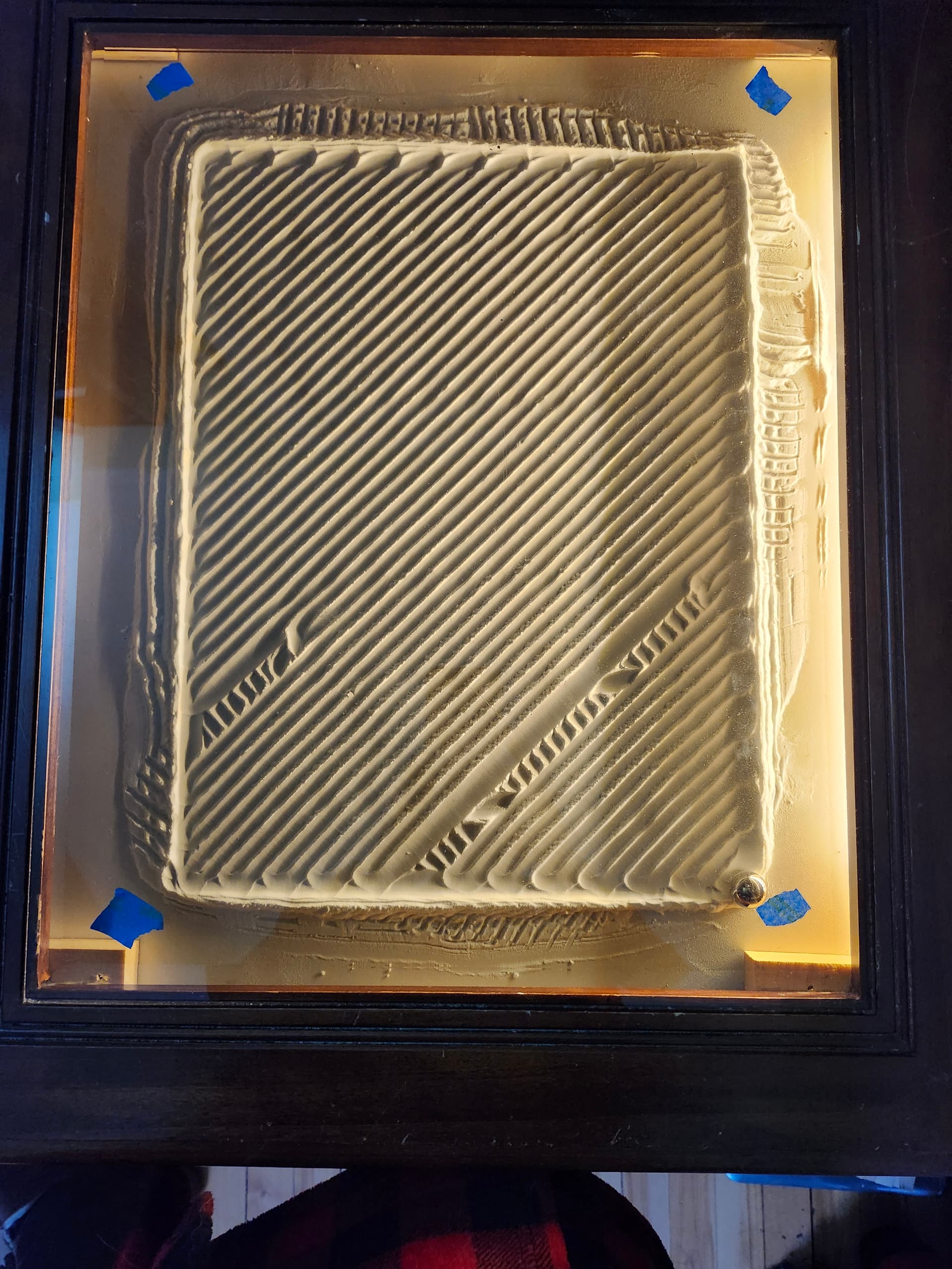

Hi all, I’ll start off by saying thanks for the ZenXY design, sandify and bard dring’s board. I’m about complete assembly of a smaller table before trying something a bit more ambitious. I essentially bought an old end-table with the glass top already and modified it to hold the mechanism, and using some 1/4” hard board for the underside. The hardboard isn’t perfect but I think close-ish.
For the most part it is working splendidly and my wife is now obsessed with it after being ambivalent when I first tried to explain it to her.
Issues:
  1. Occasionally the magnet will ‘drop’ the ball. I’m unsure if this is a result of too much baking soda, not sufficiently strong magnet, or inconsistencies in the baking soda and/or magnet distance, or some combination thereof, or possibly caused by #2.
  2. The ball moves somewhat jittery where it will seem to fall behind by a few mm and then catch up to the magnet. The magnet moves nice and smooth. I’ve tried feed rates betweenb 500 and 2000 and the jittery movement remains.
  3. As I type this and looking at the picture I see some ‘artifact’ in the upper area almost like a rectangle, though the previous few drawings have all been wipers alternating between 45 and -45 degree angles..
    See attached picture of a wiper pattern where it dropped the ball a couple times and picked it up on the next pass.
    Any pointers?
    Side note I do plan to add some vinyl to the borders of the glass to hide the non-work area.
Is the sand/soda thicker where the ball drops or is the board farther away? Magnetic force falls off with distance, so you want the stuff as thin as possible. The ones I’ve seen in action go somewhat slow relative to a printer, but maybe a bit faster than a cnc… 1000-1500 mm/min maybe? Perhaps @jeffeb3 could comment on speeds and thicknesses. His was the only one i’ve seen in person. The one i have is not yet completed.
Yeah I think it may be a combination of the soda being a bit thicker there and the magnet being a bit further away in that region. I’m going to think out the soda there and if that doesn’t sort it I see some shimming in my future.

I built a larger one and ran it shortly for testing. Your soda looks too thick to me from my limited knowledge. Also you want the magnet as close to the bottom as you can get it without it rubbing.
I also think the medium looks too thick.
Thinner medium will also provide better detail, even with the same size ball. I have about 2-3mm of baking soda on the surface of my first (The ZenXY v2 beta build) and it provides excellent detail. I have about 6mm on my other one, and it’s still good, but noticeably less detail. The deeper medium requires less combing. The thinner one shows where frequent drawing gets inconsistent depth sooner.

I’ve manually raked the medium to about 2.5mm avg depth and running a fresh job now to see how that goes. The magnet touches the bottom in most places but does pull away a bit in the area most prone to the ball getting stuck so I think I’ll have to shim that out. I’ll explore other options for the bottom or potentially stronger magnets. I do have a piece of aluminum sheet in the garage that might work though I suspect that might be a little noisy. Same with some acrylic sheet I can just imagine a stray piece of grit gets between the magnet and sheet the screech that would make.

Ball dropped twice.. I’m going to design a rake to ensure consistent depth, and do some shimming (tramming?)

Is your baking soda smooth yet? It takes a little time for the marble to pulverize all of the little clumps. Maybe 5-10 full wipes. I’ve mostly seen the jittery when there is sand and not baking soda. Or the magnet is too far away. If it’s too close, it tends to slide and not roll.
Smooth-ish I’d say, it was quite lumpy (i’m using the expired stuff from the fridge) but I now only see smaller clumps. I’ll run some more wipes to smash them up. I do also seem to favour 1000mm/min speed, as it seems a happy medium for noise level. Maybe slightly slower. I really only tried 500 and 2000 as a means to rule speed out as the culprit. I’m actually designing up a graduated adjustable rake right now to see if I can find the perfect depth, but really need to get that bottom as flat and planar as possible before I can expect consistent results I think.

Finally had a chance to re-shim the bottom (still using the 1/4” hard board for now) and also designed (poorly) and printed a rake allowing me to control the depth of the medium and have had a few successful runs in a row. Depth at the moment is about 1.3mm, and I’ll try increasing that slightly as 2mm was still getting hung up on occasion. Because the ball does still jitter more than I’d like I do still plan to switch over to a glass bottom that will be closer to 1/8” thick using an old window I replaced a few months ago, but it’ll have to wait until I can pick up a glass cutter as well as the patience to take everything apart again.
