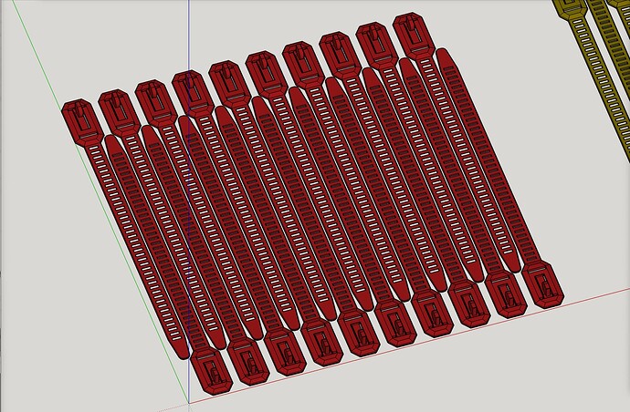

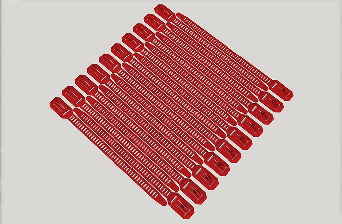

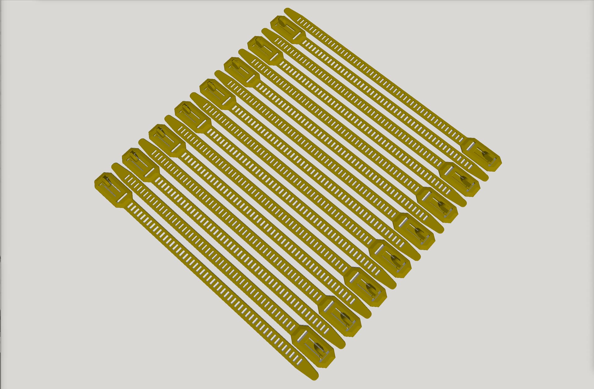

NEW v2.0 Print your own reusable zip ties - Printables link - Improved, reusable zip ties! 4 lengths to choose from, batches included, PETG recommended, but PLA works too
Printables link
Improved, new, reusable zip ties! 4 lengths to choose from, batches included, PETG recommended, but PLA works too, v2.0
Note: all models and batches assume a print bed size of at least 200 x 200 mm. The zip ties longer than that are turned at 45 degrees in order to fit on the bed. Be aware that the new retainer loop feature, which allows attaching zip tie to a cord both while it’s in use and in storage, requires a tight loop that may break PLA, which is one reason why PETG (more flexible) is recommended.

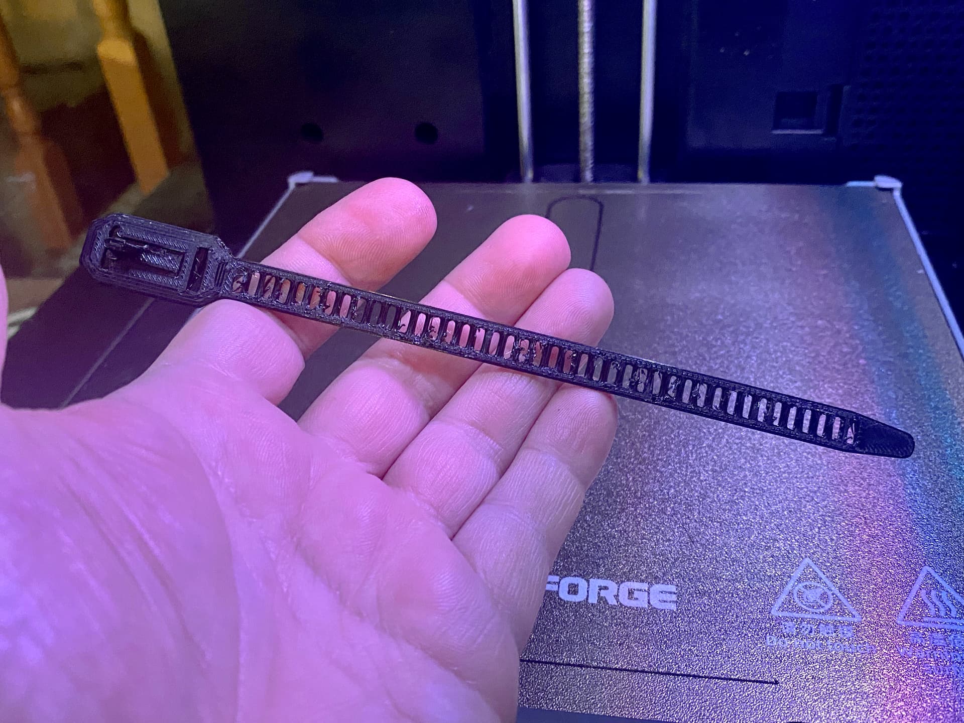

PETG works real nice on these.

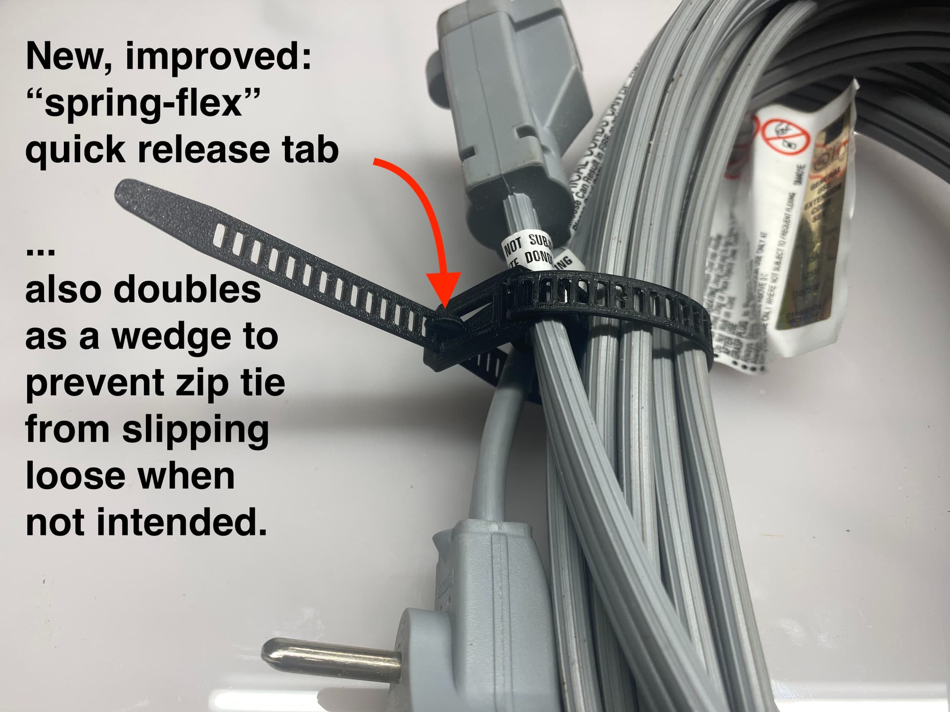

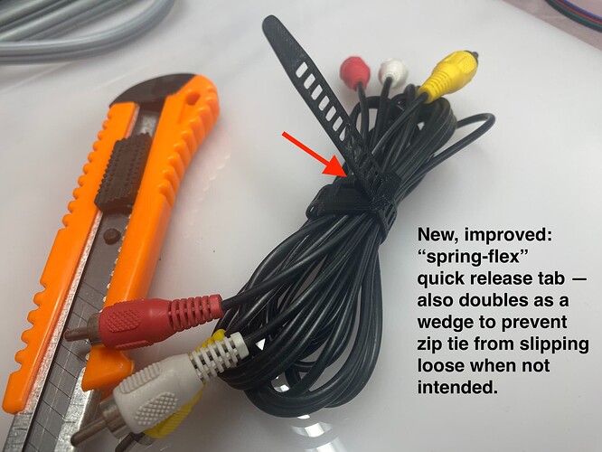

NEW as of July 17, 2024: new version 2.0 added. Includes new ratchet style lock tab with spring-flex quick release tab, which also doubles as a wedge to prevent unintended loosening, and a new retainer slot so the zip tie can stay attached to a cord both while in use and in storage.
