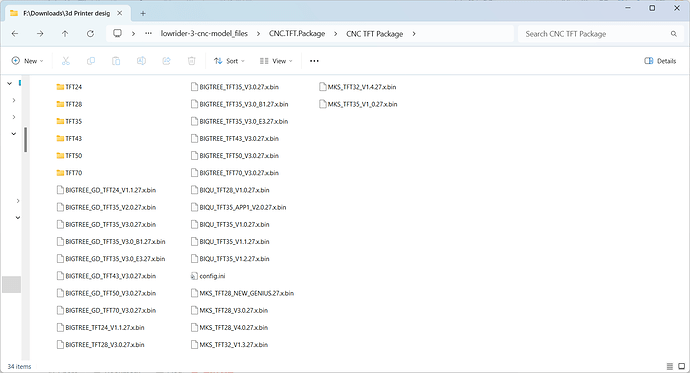

I know this is an older issue that has been resolved for the cnc, but did anyone figure out what specifically needs to be changed. Is it the TFT flashing? I’m having this issue on my 3D printer, but can’t figure out the changes done by kisslorand and how they can be applied to what I am flashing on my TFT or motherboard.
I have been trying to follow this topic and I gather that the issue has been resolved, but I have just built a new Lowrider project (newbie, 1st time build) and I am getting the exact same error message whenever I home any axis. I have used the recommended firmwares (V1CNC_SkrPro_DualLR_2209-2.1.1 and BIGTREE_TFT35_V3.0_E3.27.x). These seem to be the latest firmware releases. Everything else seems to work OK, so far.
Should I be using different firmwares, or is there another solution?
This topic is really old, always good to just start a new one when in doubt.
When flashing your screen, there are two .bin files one starts with BD but is otherwise named the same, put both on your screen along with all the other listed flashing files. When you restart it will use the right one.
There are two different chips on the TFT’s without looking at the IC itself there is no other way to know which one you have.
Thanks for the reply Ryan, but the zip file downloaded from BTT doesn’t include a bin file starting with BD. See my folder screenshot from the zip file.
Gd, sorry I just finished my coffee.
Ah! :grinning:
I was just about to put the chip on. It is a GD32F205
