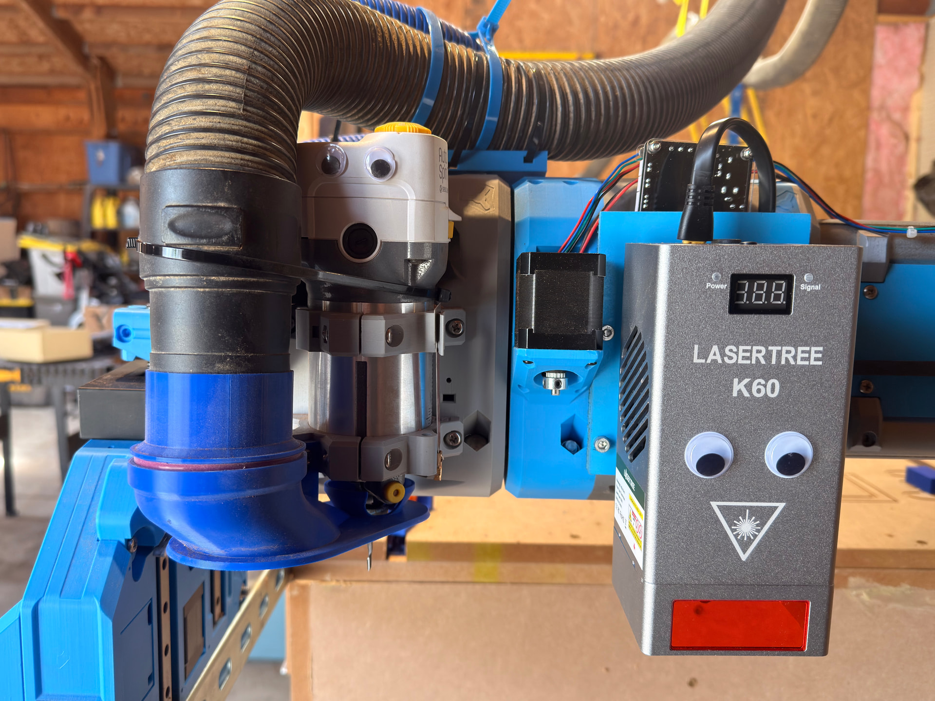

I’m pretty sure my cheap spindle is about on its way out. I took it apart and cleaned out a bunch of dust and that seemed to help but it’s loosing a lot of power at times I think when it’s getting hot.
I was looking on Amazon and saw this dewalt mini router with adjustable speed. Would this be a good replacement?
That’s the exact one I have. Keep in mind the lowest speed is like 16,000 RPM. If you want to go lower, I believe the Makita is the one others use. My Dewalt works really well. Even at 16,000 RPMs it still produces chips.
So no matter what you should be printing new ones. You can buy any router, but i would not pick a bad ultreacheap clone. We had some discussion about one er11 collet router clone from the makita. But i do t think its available anymore. Let me cheack and i’ll edit this comment
Er11 router i cant speak about the quality of this exact one. I have been using the Carbide Er11 router but the price is up to 150±
Both are 65mm body so you need Kobalt or makita mounts
This would come with an er11 1/8” collet, i would advise to buy the others you think you would need. 1/4" 6mm 4mm/3/16” you name it
If it is available for purchase yes but buyer must have a way to control the 0-10v via a 0-10v module (i don’t know it its already integrated in the new jackpot)
