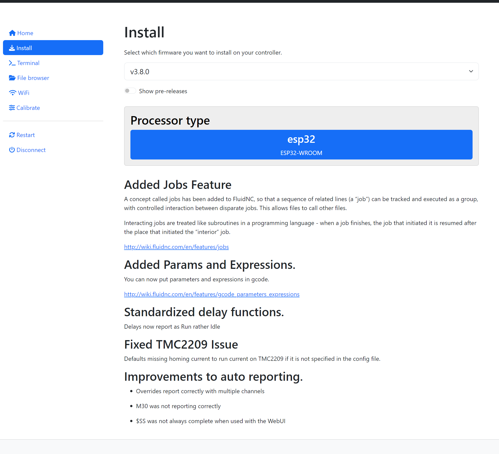

Was going to reflash this morning since I have one thats running real HOT… Noticed this
Interesting.
Note the version in the install drop box is ANCIENT (3.8).
We were at 3.7…
Yeah not ancient, now we would be I guess 3.8.0
That new jobs feature sounds useful.
I bet that would work for the ZenXY to have it run various patterns continually.
Anybody updated to V3.8? Maybe I jumped the gun and should have waited a bit. But I couldn’t wait because I was going to use the Parameters feature.
Using Estlcam v12, I was going to change my ‘tool change’ function to read and save the current working offset, then go to my G54 (where I homed the machine) and move the bit to the front left side so I can easily change bits, then re-establish the working offset and return to the work piece to re-adjust the z 0 location, then move it back so I can put the dust shoe on (since sometimes there wasn’t enough room to do so), then resume the job.

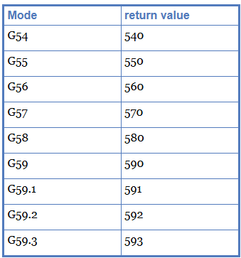

Referencing the FluidNC Wiki GCode Parameters and Expression | Wiki.js (fluidnc.com), and the LinuxCNC functionality it’s based on: G-code Overview (linuxcnc.org) and the fact that the _coord_system is just 10x the value:
This means we can use an expression to divide the _coord_system by 10. So, I think G[#<cwc>/10] is what you’re looking for.
G56
ok
#<cwc>=#<_coord_system>
ok
D#<cwc>
[MSG:INFO: Value is 560.000]
ok
G54
ok
D#<_coord_system>
[MSG:INFO: Value is 540.000]
ok
G[#<cwc>/10]
ok
D#<_coord_system>
ok
