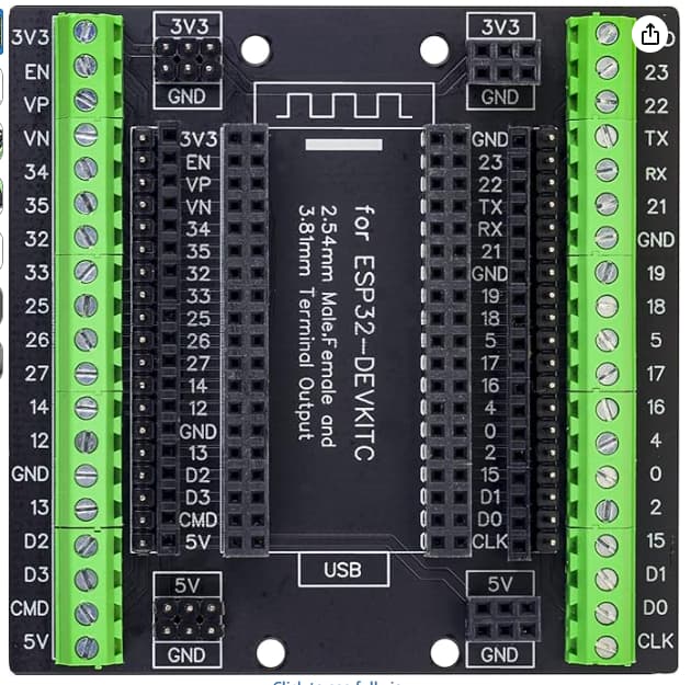

I haven’t gotten to the deployment side yet :slight_smile: At the moment, I’m just using ESP32 dev boards.
I don’t know if I’m going to try to be efficient with it, or just chunk it on some breakout boards or something like this
and stick that in a 3D printed case.

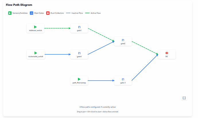

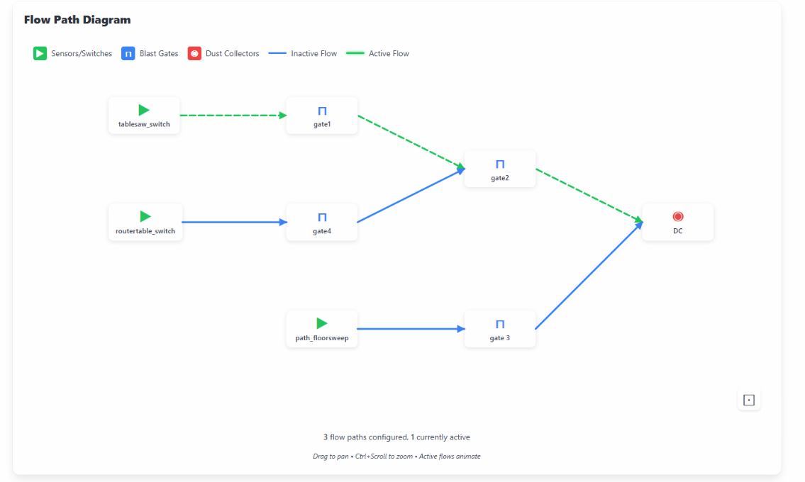

I started writing code for a similar system years ago, using Arduinos and XBee links. Implementation never happened and in the interim, I’ve changed the approach to ESP32 using MQTT over WiFi.
Someday I may get around to finishing it….
Found a picture I had laying around from when I was testing before I left of what the current running Dashboard view looked like so far
(Icons are just placeholders for now)
