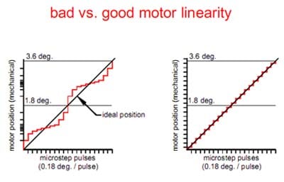

I’ve seen charts at 1/16 microstepping of commanded movement vs real movement, and it tends to look like a sine wave for error, in that the 1/16 microstep does work, but is decidedly not 1/16th of the movement of a full step.
It looks like a sine wave, but the amplitude is reasonably small.

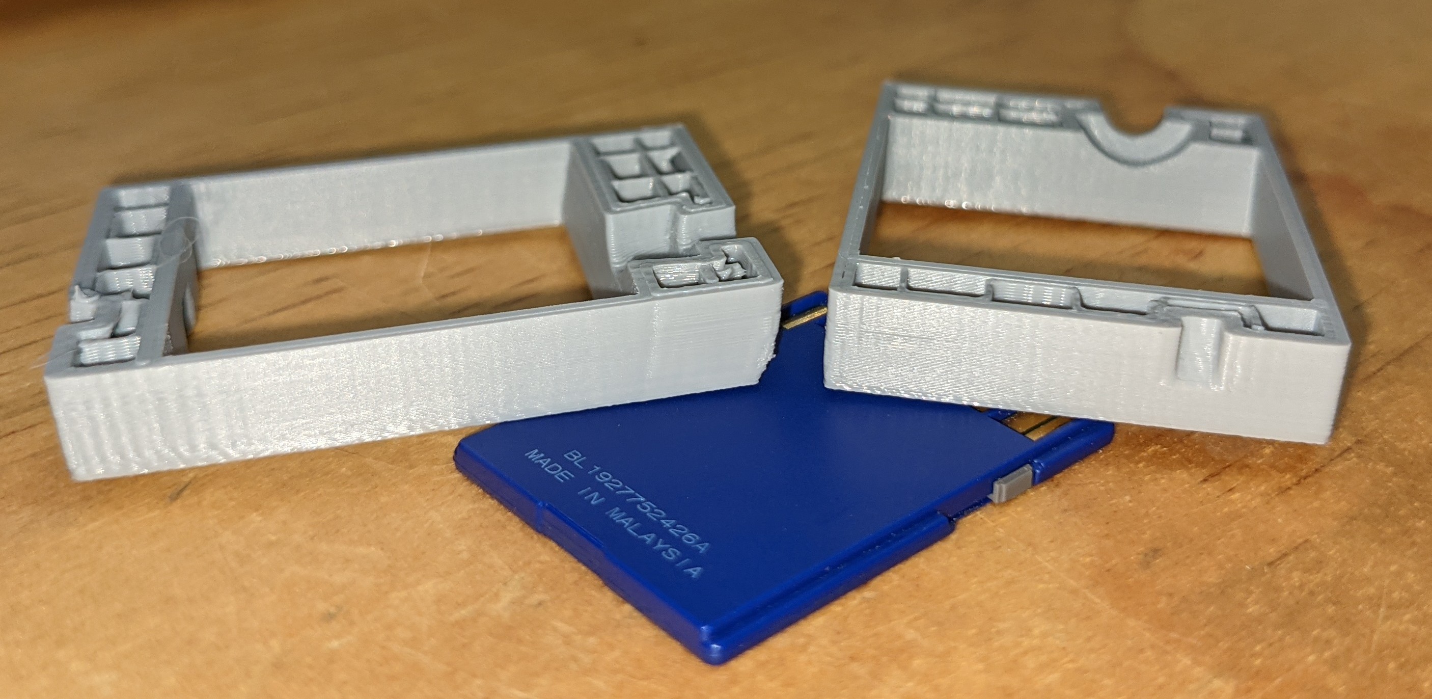

The 0.1mm prints are doing okay on both printers, the MP3DP has noticeably more ringing and poor infill (cooling?)…I am printing at 50mm/s so that was expected, but the new printer has some ringing as well infill is fine. Pics soon.
Not yet. I really need to sit down and double check that count is right. I typically do not get counts right the first time around. I should have CAD open here pretty soon the double check.

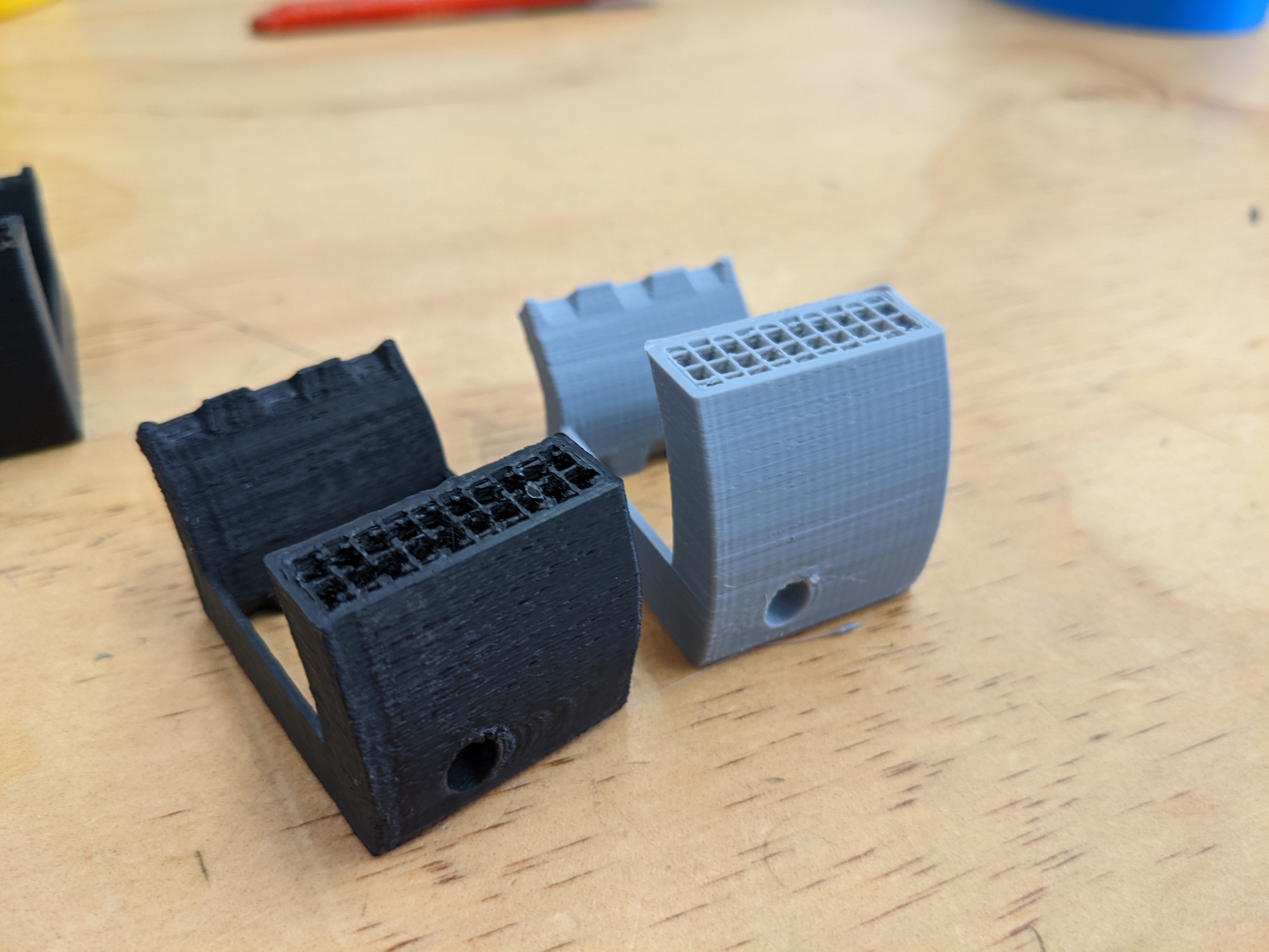

Well they both look crappy. 0.1mm is a bad test with a 0.5mm nozzle I think. Both at 50mm/s grey is from the new printer. Better all around and infill. Not happy about these prints.
Try again at 0.2? That is a non ideal layer height and these big nozzles have a better chance at a good print.

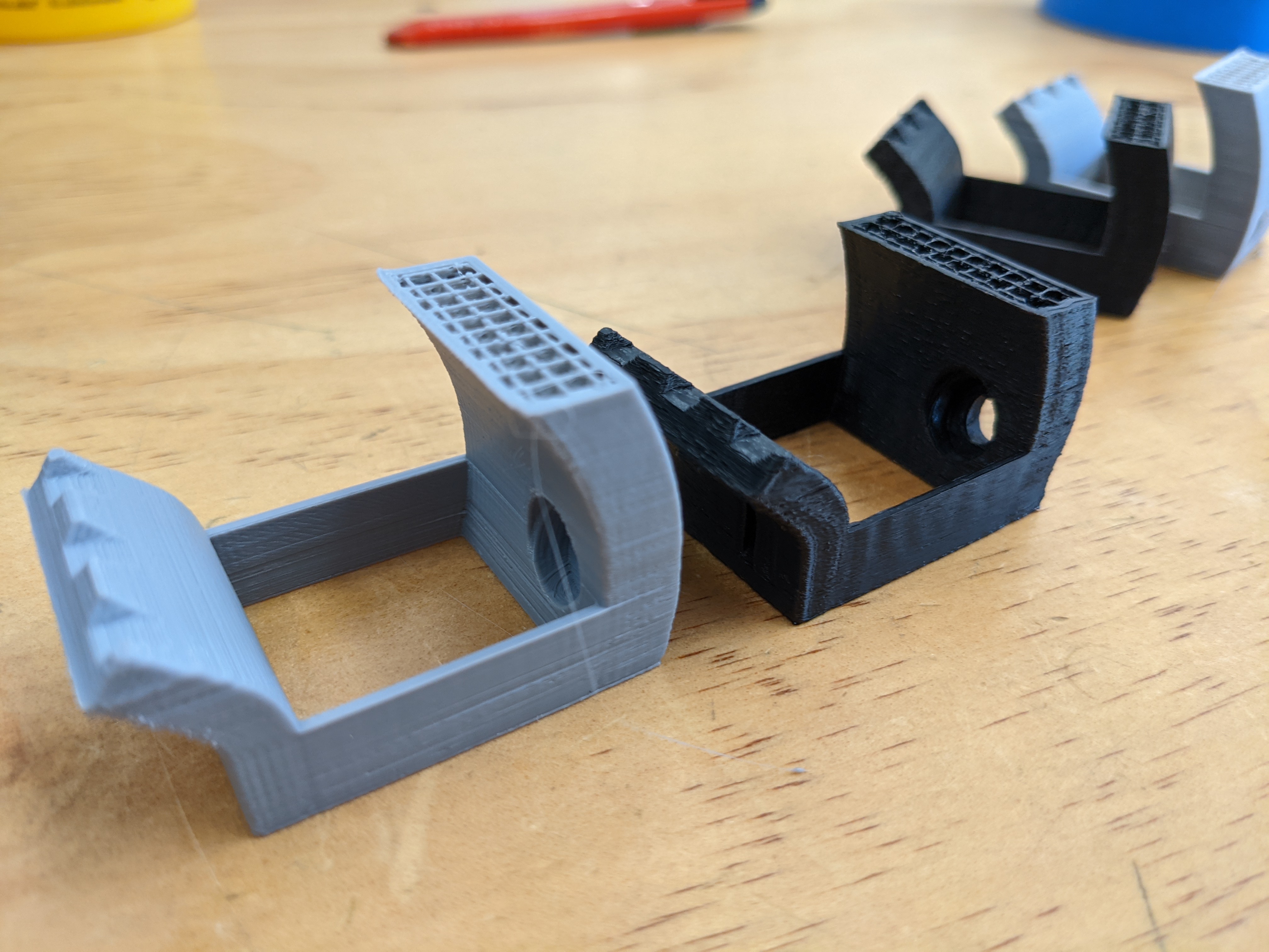

So those previous pictures…disregard them I changed slicers, verified the settings and made sure that there was no layer slowing…flawless 0.1mm prints are happening right now. Feeling good now!!!

.1 layer, at 50mm/s. Ringing… slightly flash exaggerated but still not expected. I stopped it to do the other test.

I did find this diagram on linearity, obviously a vendor pushing their motor drivers as being more like the “good linearity” model.
Worst I would say is probably at the 1/4 step mark. 0.12mm layer is going to tickle any error in the motors to its maximum fairly regularly.

Going by the pictures that have appeared since I started typing… I’m going to say that the 2209 drivers are probably plenty accurate to the 0.1mm layer resolution, and I don’t think you’d see anything at the 1.2 (theoretical worst case) resolution.

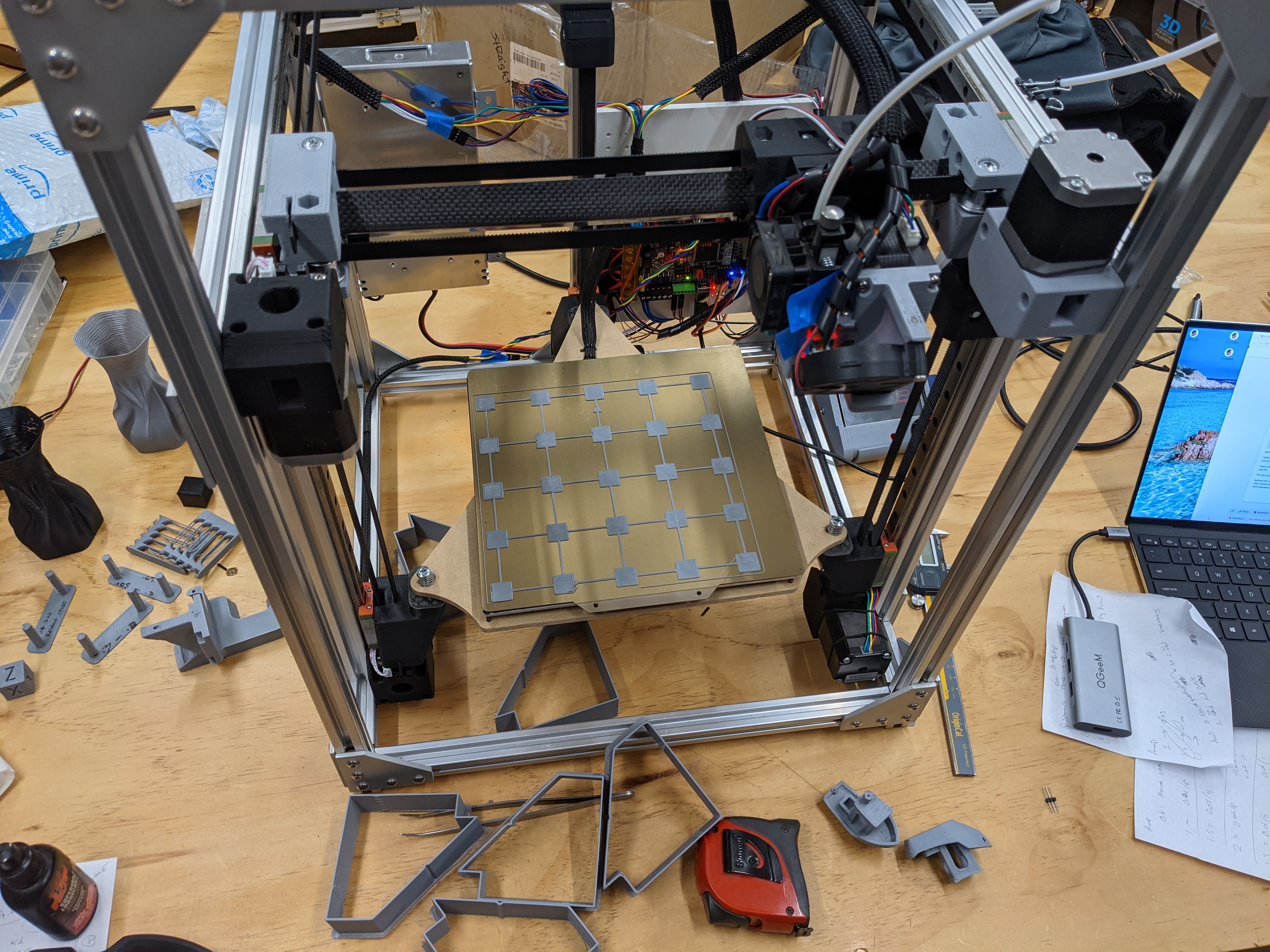

I ran a giant square around the entire bed. No steps, just a clear indication the bed in not as flat as it seems. The line goes in and out in spots gradually. From what I can see it is always a smooth transition.

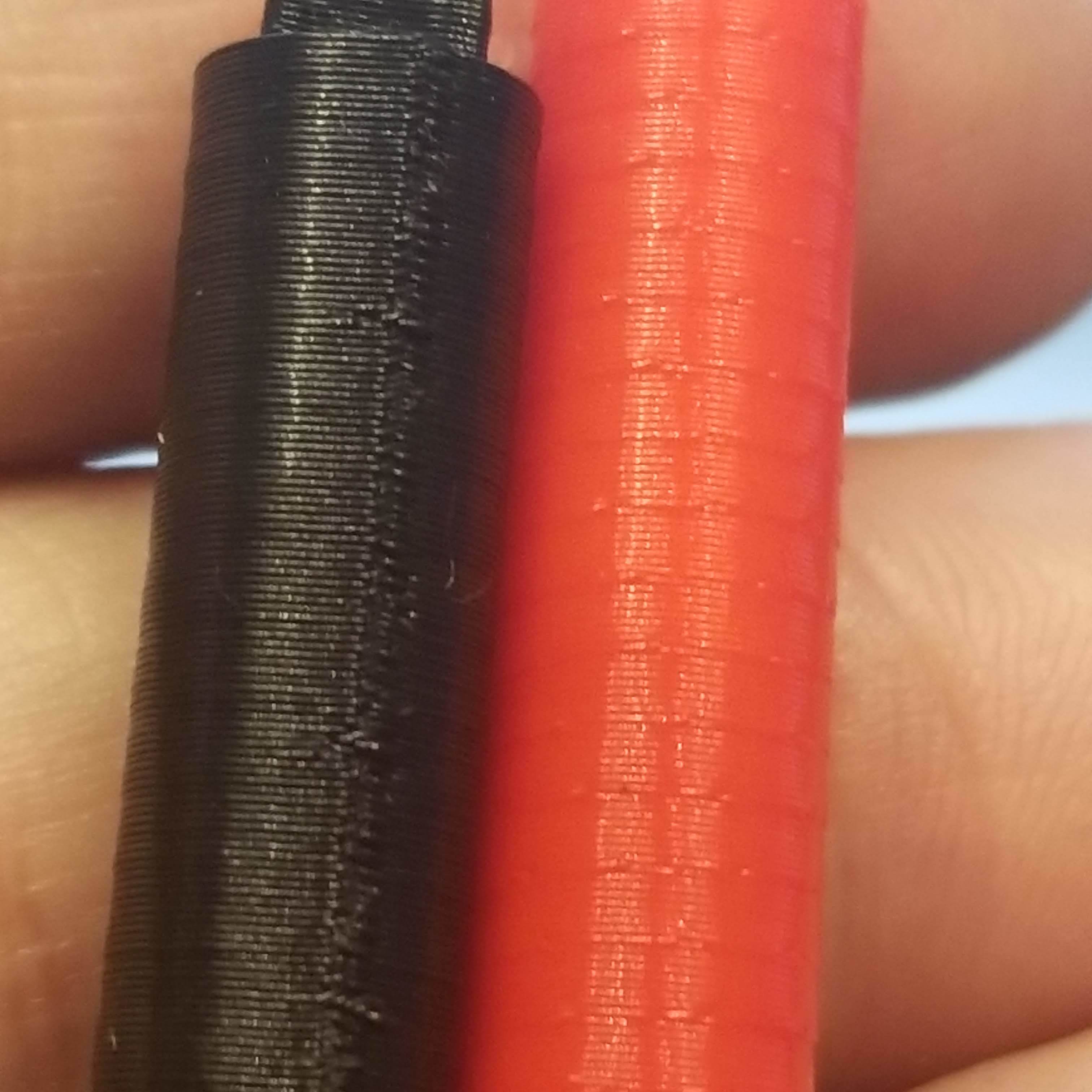

Super clear layer lines on the red, but the black is almost perfect. What was it?
The Z rider!
