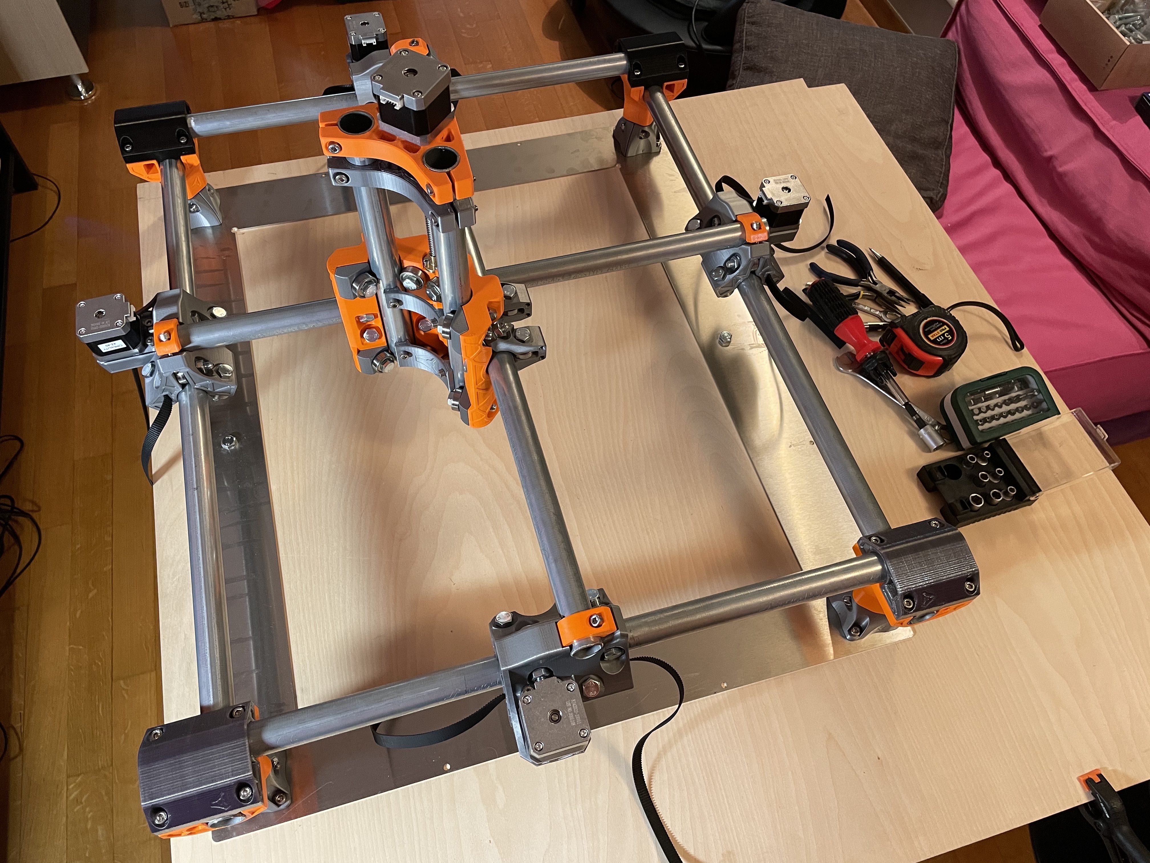

Hi fellow MPCNCers,
It’s been a few months i got my 3D printer and MPCNC is the first big project i try to build using it :slight_smile:
I started working on it last week and by now I have all the required parts printed and all other parts where purchased locally. Now lets start with some mods i had to make
  1. this is how it started
    and this is how it turned out to be enhanced
    This metal frame helped me be spot on with the diagonals and the parallel sides. I’ll upload my drawings for this metal frame which is based on the default Primo size for anyone who might find it helpful
  2. My version of Idler 20t gt2 10mm
    As you can understand I missed the Idlers when i placed my order and i then realised it will take some time before i get them as they were out of stock. Still i had these tiny bearings in hand and made my own printed version of idler. As you can see they fit perfectly in place and they are spinning just great. Any reasons why i should not even try to get the MPCNC up and running with these in place instead of the actual idlers?
  3. This is where is am now…
    …i need to do the fine tuning even that everything seems to be moving just fine by finger :slight_smile:

As promised… MPCNC Primo Metal Base (Default size 720x609) by aNodyNos - Thingiverse
I am lucky enough to have a friend who has access to a CNC machine and got this done for me. My initial try (with the tools i have) was OK for the sides but had a difference of 5mm between the two diagonals, meaning that the whole structure was not squared. All sides where parallel but corners where not 90 degrees. After using this base i have zero tolerance :slight_smile:
Even that i pre-threaded the nuts so they are not that stiff, i have two Belt Slides that the nut turned into them and now it is impossible to take them out (or not)? I checked if there is an access point on the top of the corner bottoms but there is not one. So I’ll have to work very carefully with the tension using only the opposite bolts, still IMHO an access point is needed for nut on the corner bottoms so that if you take the corner top out you can stop that nut from driving you nuts… :frowning:
