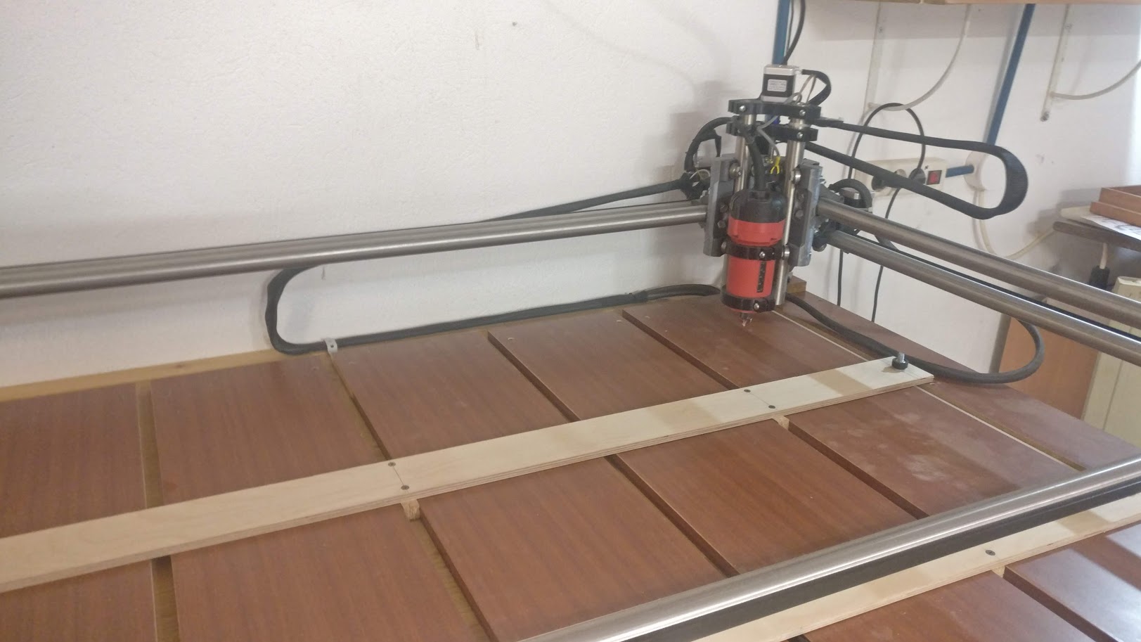

Hello to all
I attach some photos and 2 Youtube video clips from my new builded Primo. It took me about 40 days to build because of the courier delays, Working Size is 1200x600mm Quite rigit. My 3d parts made from PLA where i prefered rigity and PETG where i need temerature resistance, motor and steppers etc. The plan was to use Marlin, but after a second thout I used GRBl with 5axis, enducross version
I will use my built for CNC and laser cuttings.

Nice construction, good job, now it’s time to start enjoying it
What kind of bearings did you use, they look like 608z or 608zz. I initially put in 608zz and after a while the dust did its thing, and they were no longer running smoothly. I had to disassemble everything and install some 608RS.

I have noticed a tiny wiggle on tight YX curves that’s maybe to high acceleration speed 300mm/sec. But is not visible on woodwork that I am doing, so I let it be for now.
