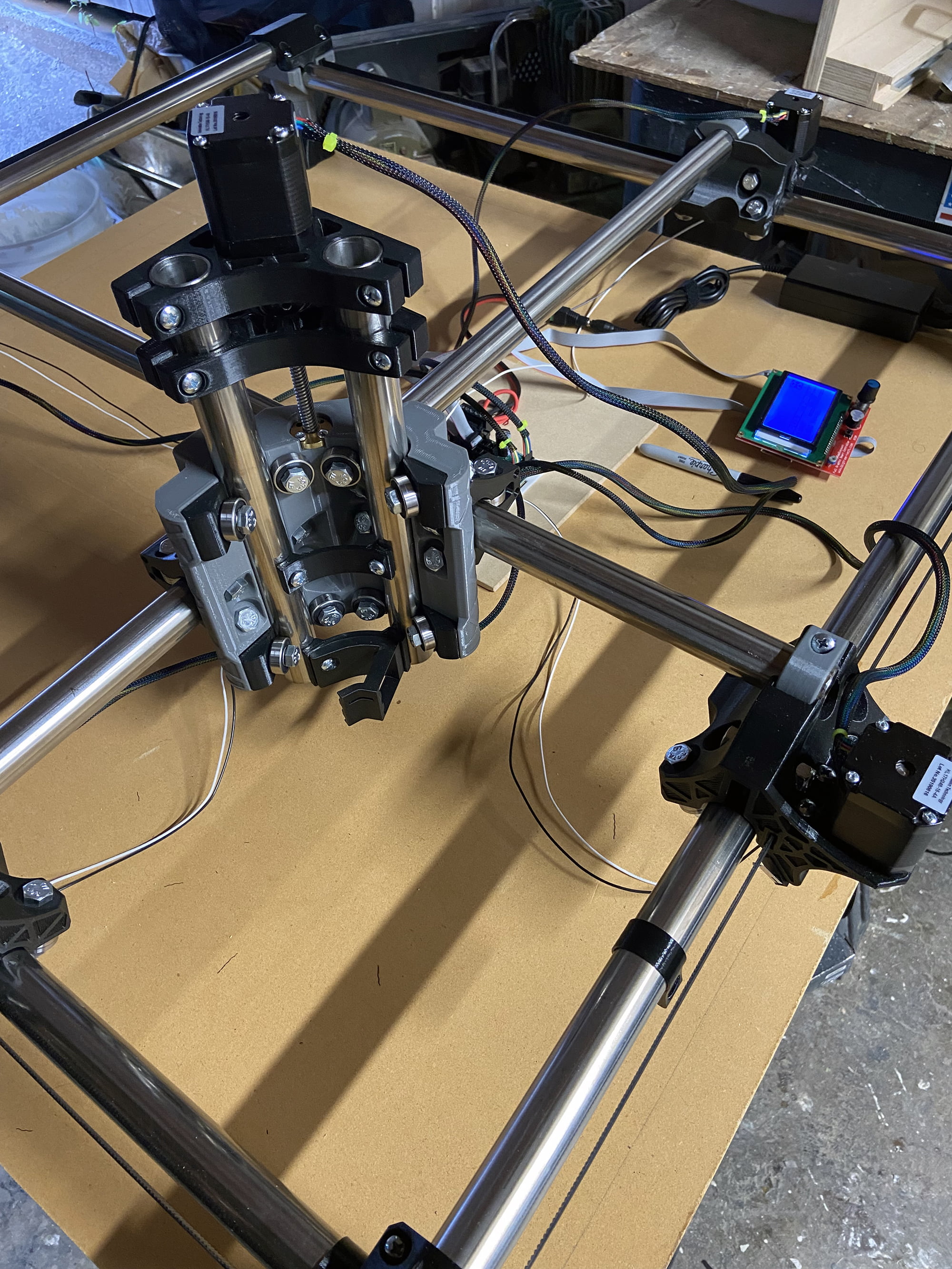

Finally made some progress on my MPCNC!

  5. (EDIT) I noticed that two of the rollers on my front truck along the X axis do not make good contact. I’ve circled the problematic ones in red in the following photo. Seems like they only make contact in a small area near the middle. Is this common or is there something I should do to fix it?
Here’s my result after running Ryan’s crown test with a ball point pen. TWICE!
The lines almost perfectly overlap!
:blush:

First make sure the machine itself is square. Measuring the legs across the diagonals as per the instructions is the best way. These diagonal measurements magnify any errors, so getting them as close as possible is best.
Squaring the gantry at home position is next. With the dual endstops, you start with a tape measure and make sure that the distance from stop to end is as close as possible. Without, you can still use the stops the same way, just without the switches. From there, drawing a square isn’t a bad idea, but you really want it as large as you can get it. Again measuring the diagonals is the easiest way to check how square (or rectangular is ok) it is. If the diagonal measurements match, it will be good.
Diagonal measurement of the inside of the legs is fine?
I’m measuring 43-5/8" for both of them…one might be 1/32" smaller; it’s really hard to say.

For dialing the trucks and the core in I found the best way was to set my end stops such that the auto squaring got it perfect (measuring from the side tube to the appropriate gantry) and then adjust the trucks/core until the bearings could all be manually spun with a bit of drag on them. Worked out well for me at least.
