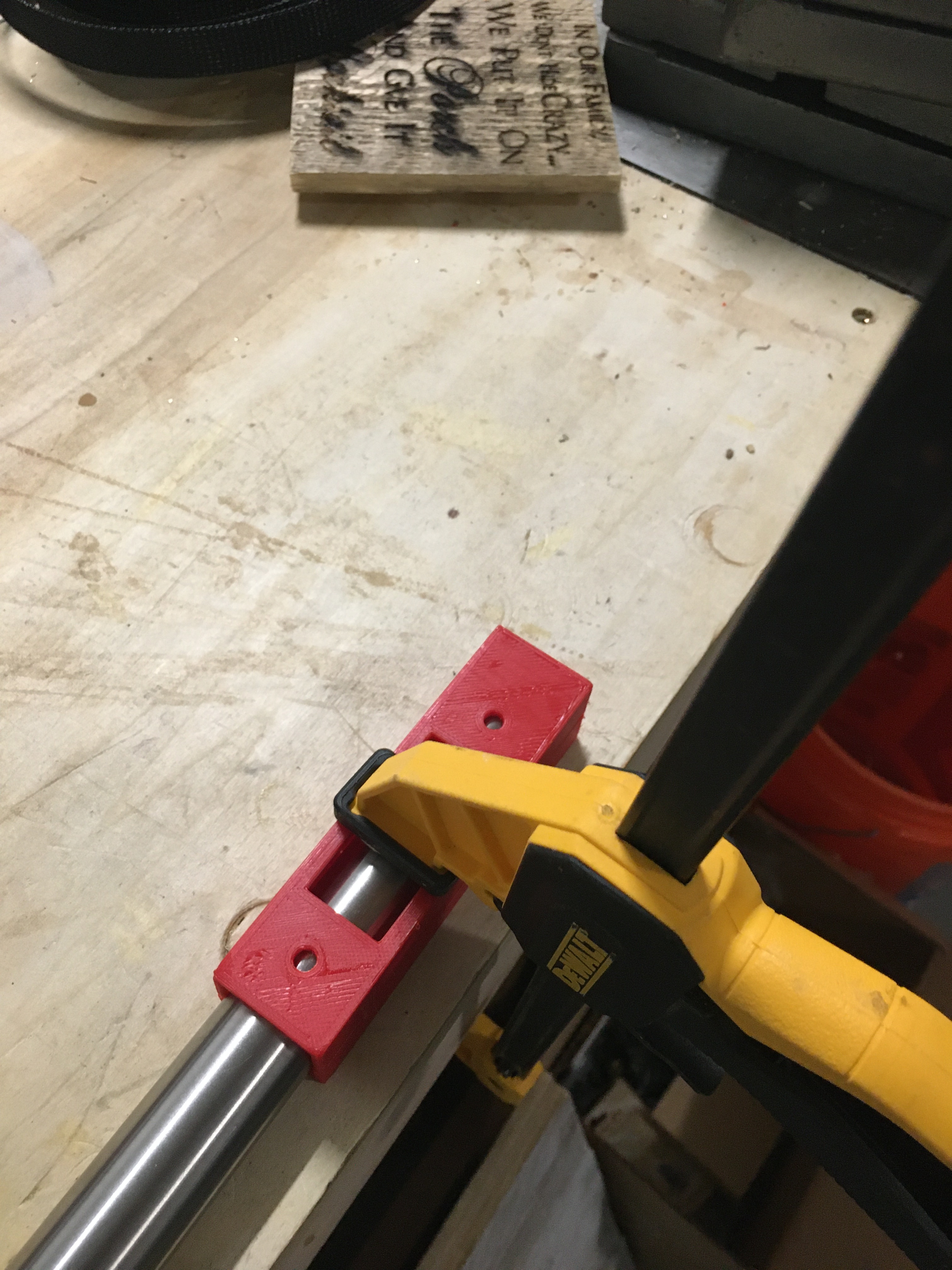

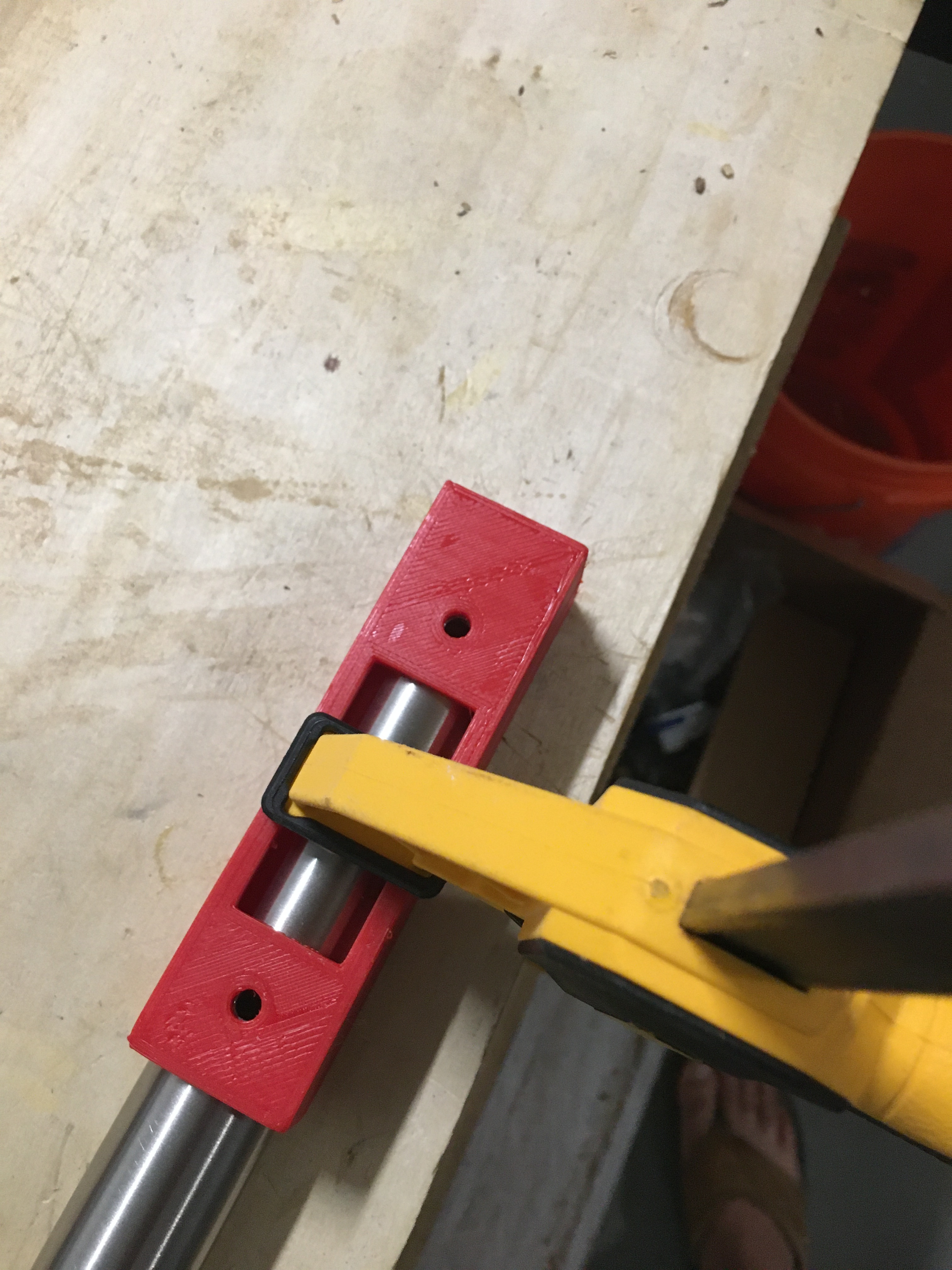

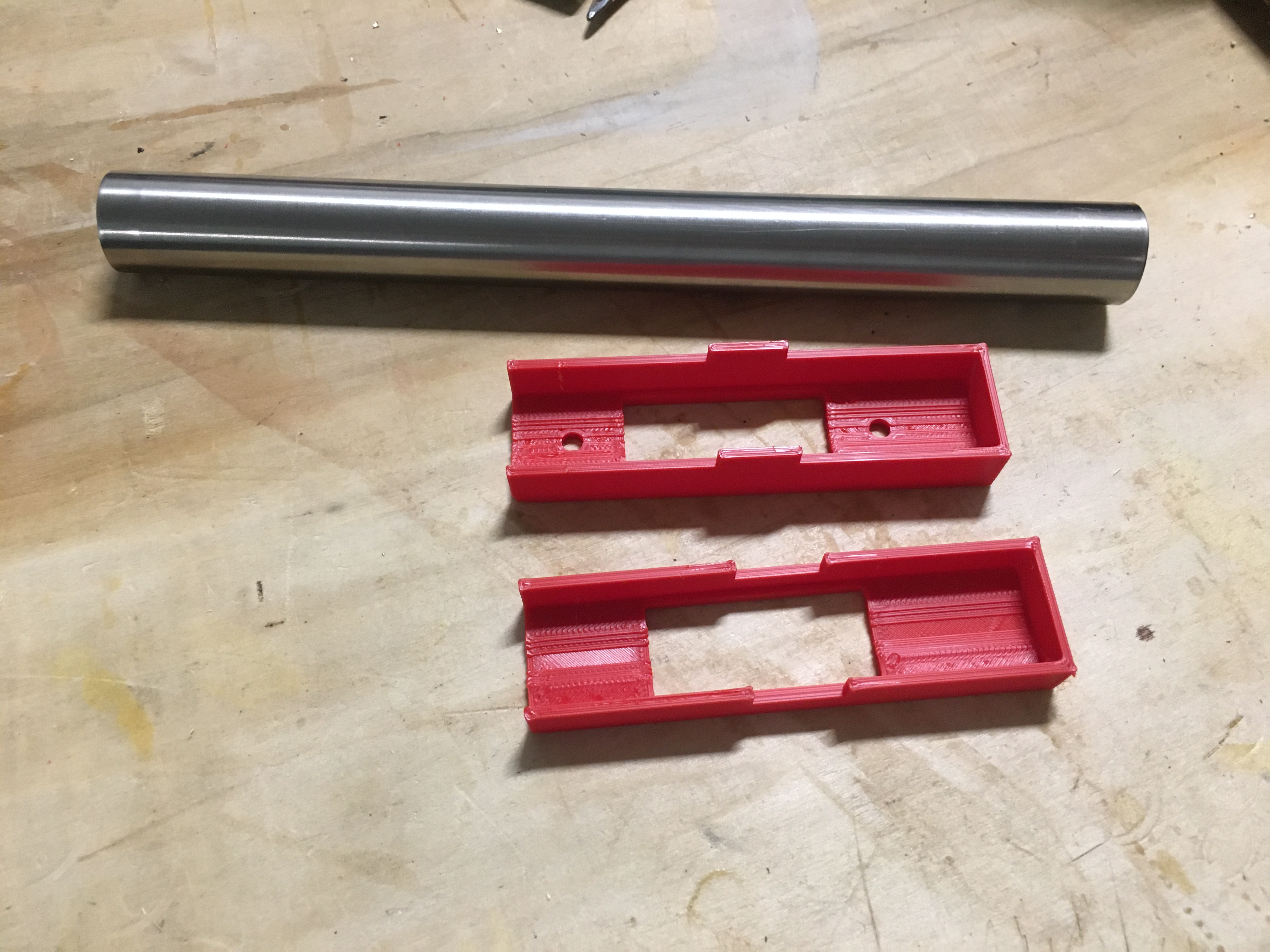

https://www.prusaprinters.org/prints/35297-mpcnc-primo-j-254mm-z-nut-trap-jig

Got my pipes - 25.6(!)mm SS from Jegs[dot]com. (Btw, the forum is only allowing me one image since I’m a new user [and no links! hence the [dot]com above and broken URL below], so for those interested, here’s the URL for the pic of the pipes I tried to embed here: https ://forum.v1e.com/uploads/short-url/sRwP3AhUQzJJkHrEJpzFldoBG4D.jpeg)

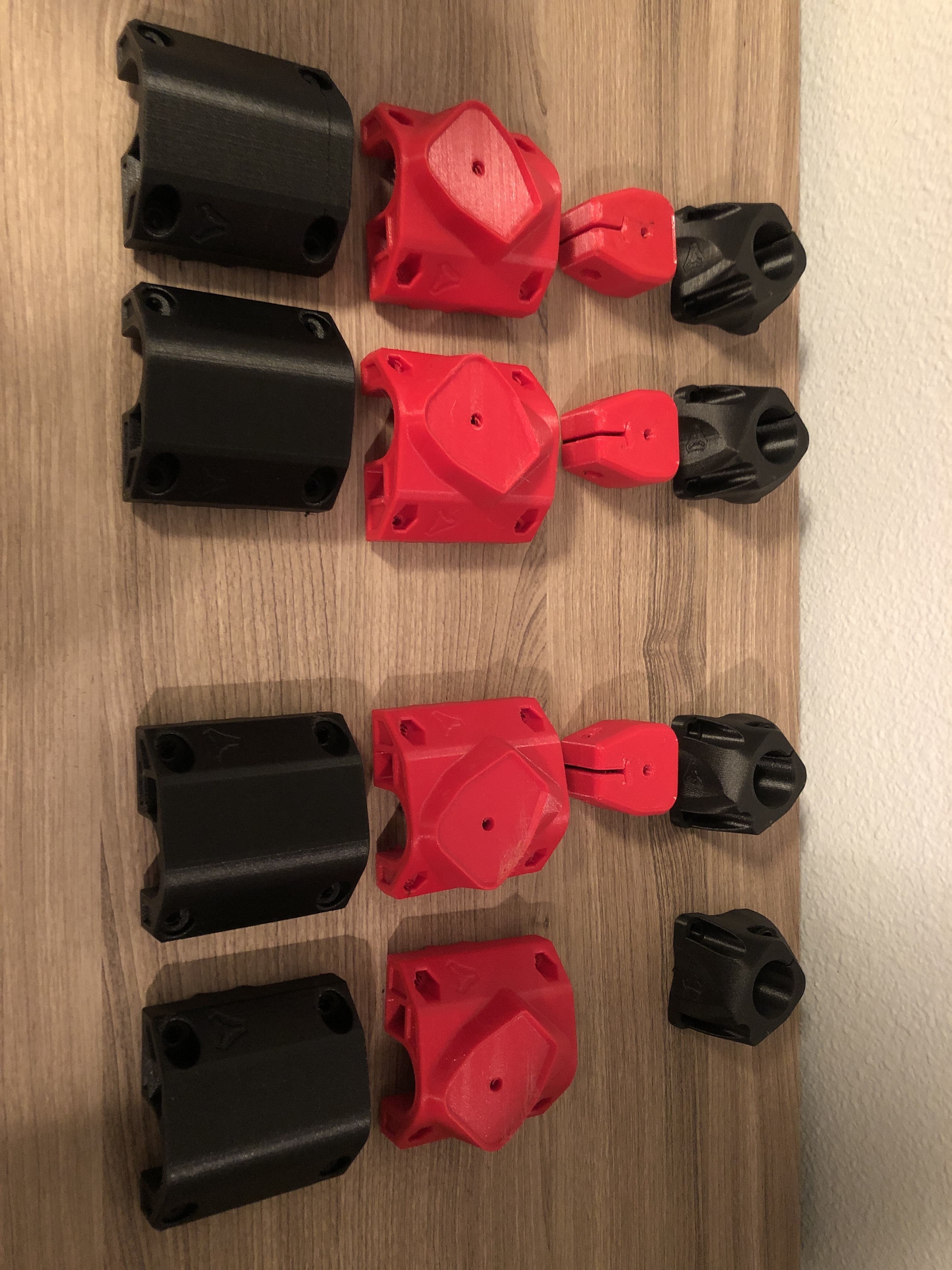

Also got most of my printed parts:
And the 660 arrives on Friday! I’m beyond excited.

Good to hear. So the OD is within 25.4mm ballpark? (Except the ground weld line)
huh. looks like all star. :man_shrugging:t2:
hadn’t unwrapped yet.
25.46 OD with ~2 wall.
give or take (crappy caliper)
