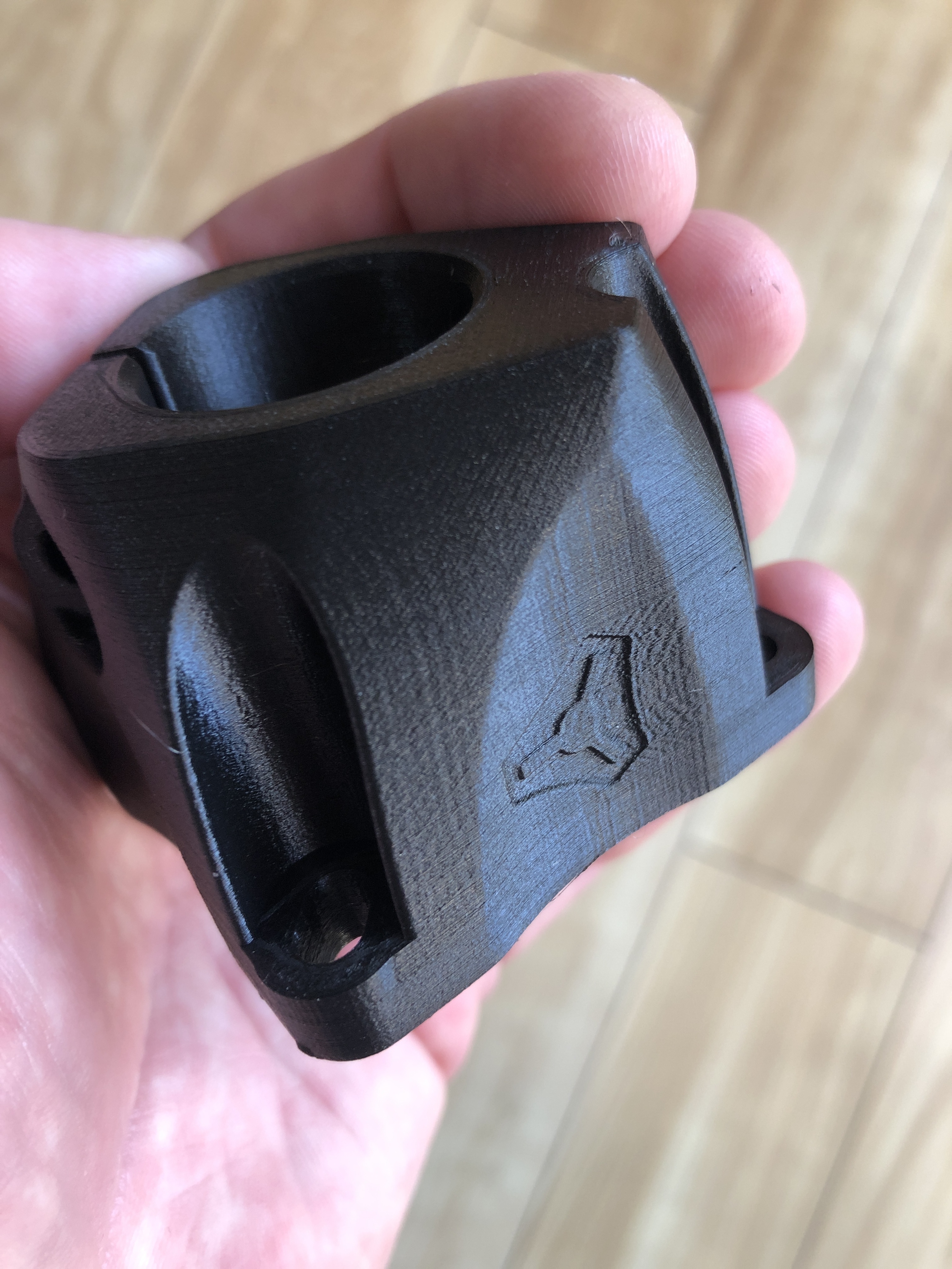

I’ve started printing! I have a foot that’s 2 hours in. Expecting 1 more hour.
Newbie question- I’m noticing a lifting lifting on one side in the corners. I suspect it may be due to having the AC running in the room. Is there an easy way to fix this for the next part? Will it impact the usability of the foot if it isn’t perfectly flat?
Just paranoid, I guess… Thanks in advance for sharing your collective wisdom.
If you have a heated bed, upping the temp a few degrees can help. Also just a big box, or even the bottom half of a box, no lid, around the printer will help. Keeps the breezes off the print. I’ve actually printed stuff with just a paper ring a few inches bigger than the part around the part. Leave it loose so the hotend can move it as it prints.

Also you can use Brim, 5mm to 10 min should be enough to keep the corners down
Or mouse ears.
Thanks for the suggestions. I’ll give them a try on foot #2. Any concerns with the using this foot? Seems like its not critical.

As long as it mostly doesn’t rock, should be alright. The tubes will keep it straight, screws just keep it from moving. Don’t forget it’s off a little though, you could crack it if you tighten the screws too much.
