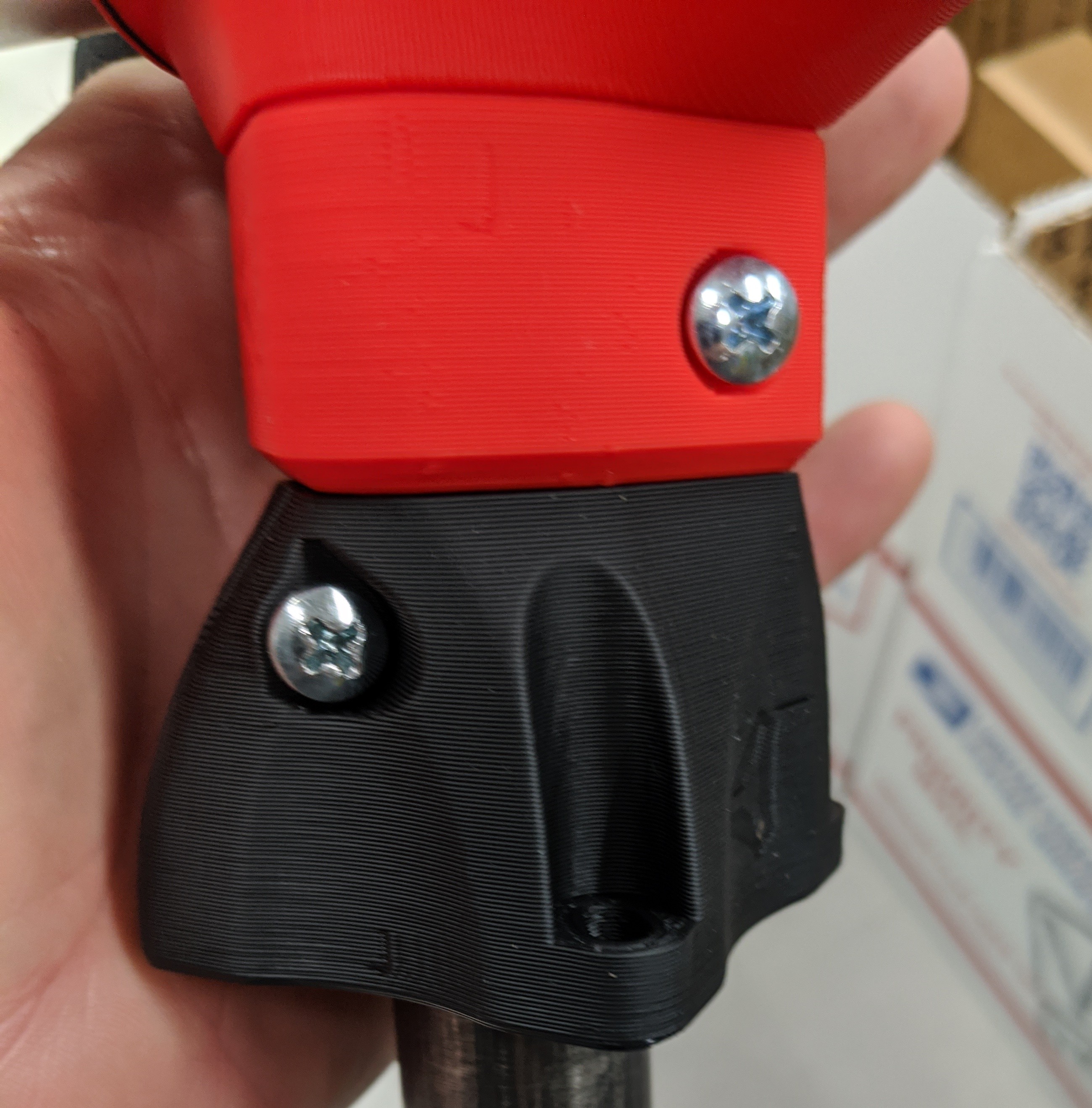

I swear this isn’t a fetish of mine, but… that foot looks sexy.

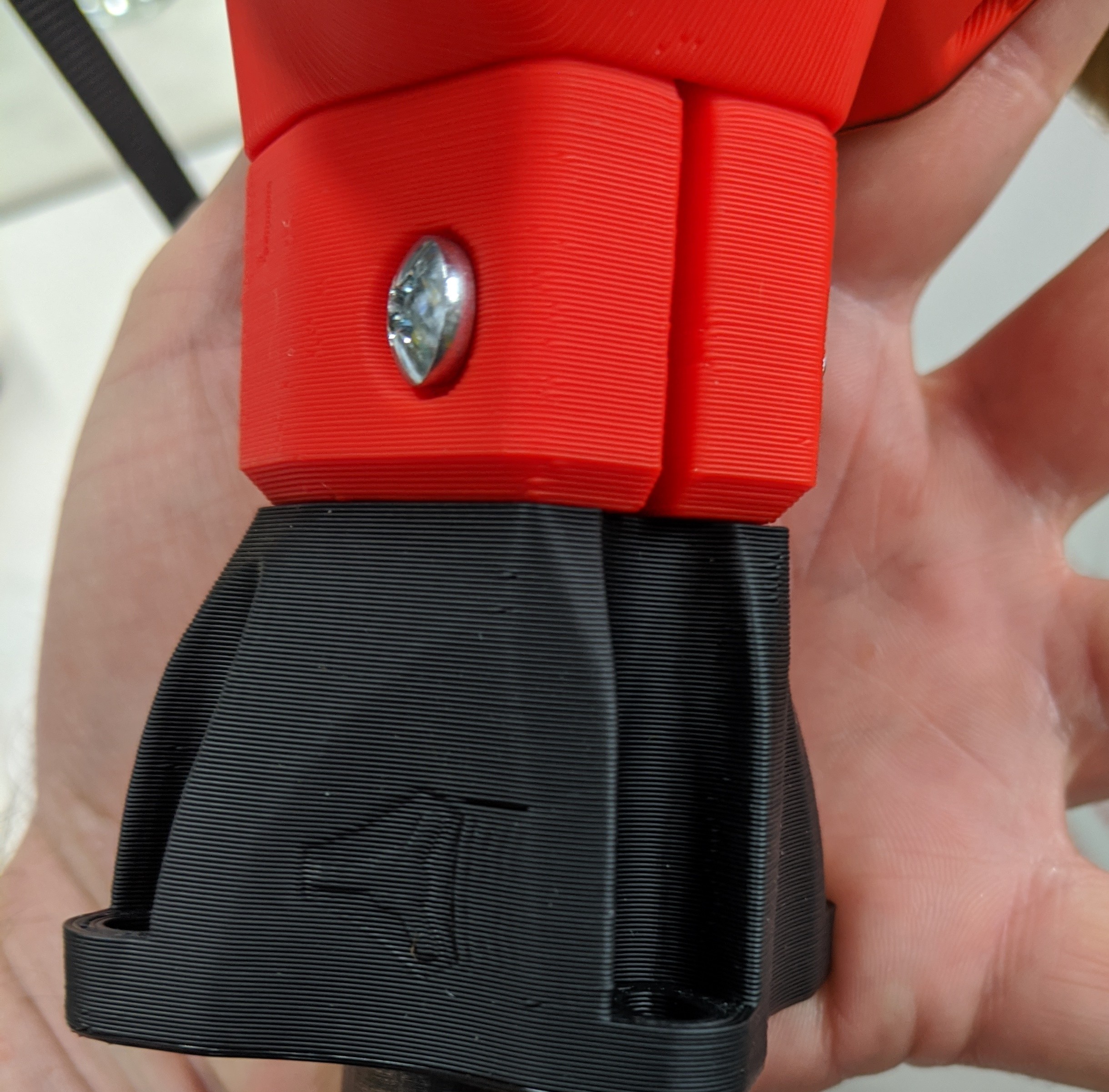

Thanks but man, I really do not like the look of that screw slot that goes all the way up to the lock. That foot had too much time spent on it so I am calling it good…but if I get a good Idea I will certainly change it.
The screw hold down slots are all offset by at least two layers to make them stronger and hopefully prevent layer splits.
you can see it in the lower picture the left most one is thicker than the right one, which is still thicker than the previous foot.
I would not have noticed that. Smart.
Impressive attention to detail.

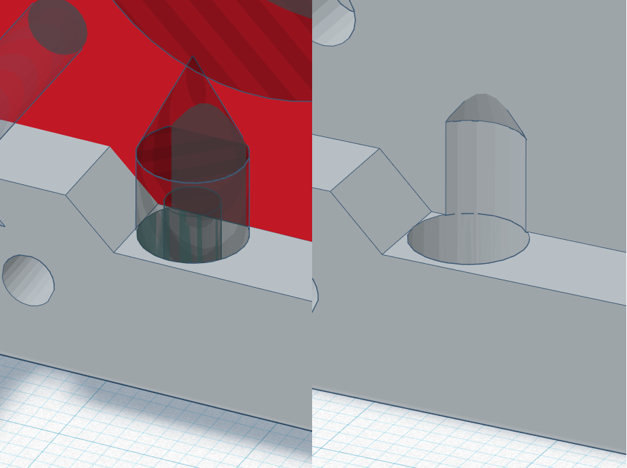

I did something similar with a slot I needed to add. Let me see if it makes sense for you.
Yeah I looked into just making it shorter like that but getting a screwdriver in there would have been tricky.
That what socket head screws and ball-end allen wrenches are for… :wink:

The bridging on color change is genius!!
