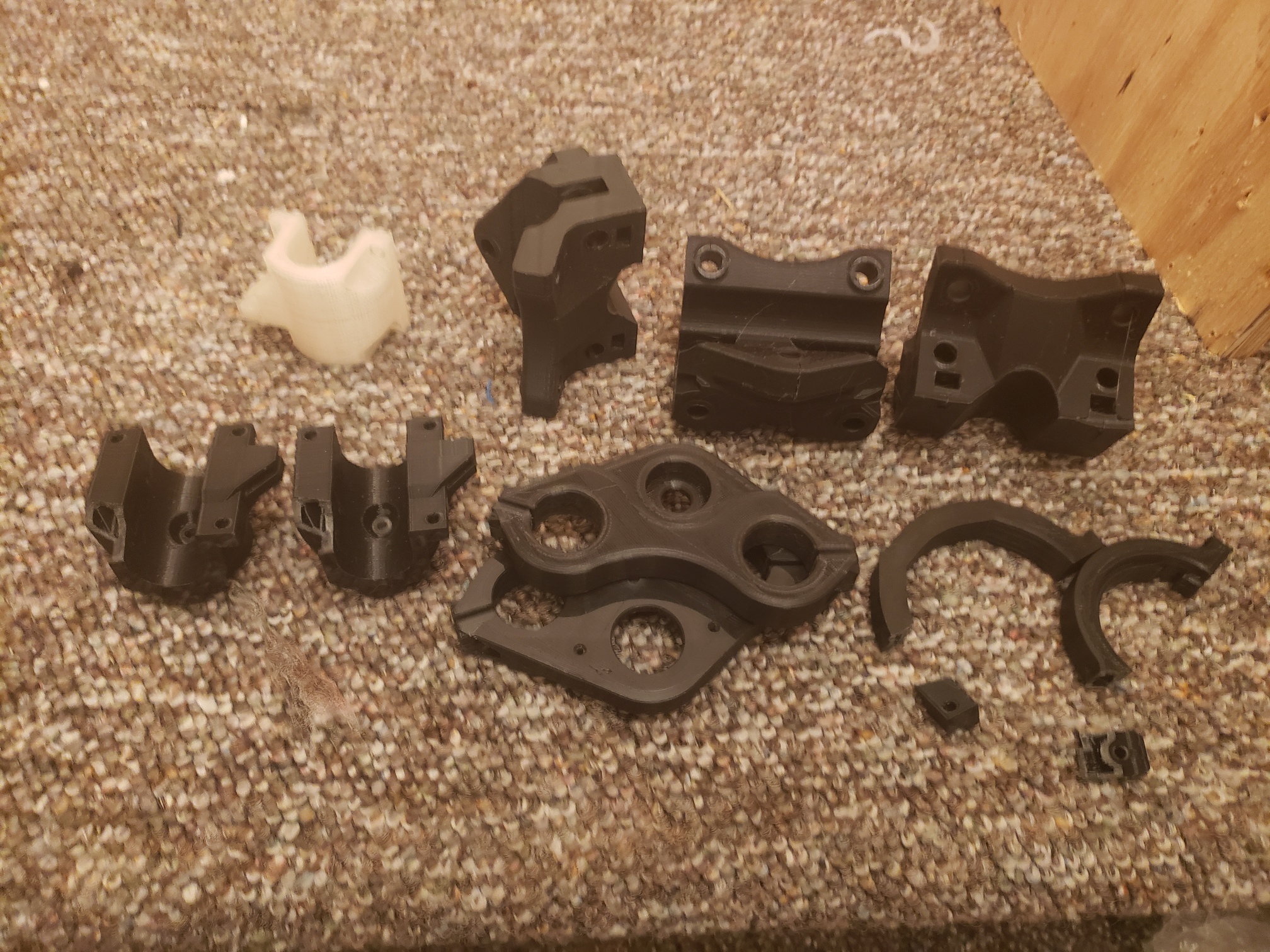

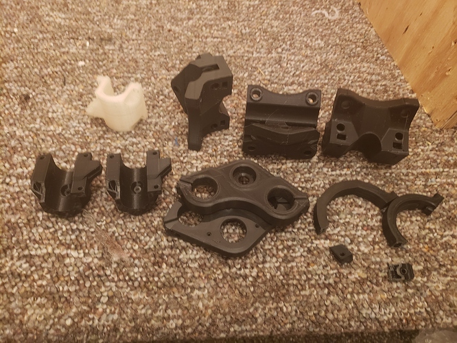

In order to do this I stripped it all the way back down to the atomic components, and when I did, I found a bunch of cracked parts.
I mainly place the blame on the cheap Inland PLA+ I used being more brittle than conventional PLA. However, on top of that, I did also utilize the gorilla hand technique that Tim mentioned.
Not really trying to make a particular point, just adding my data points to the discussion about brittle failures.
I love inland, works pretty good for me.
Looks like your parts all have zero infill to me.
All mine is Inland PLA too. Annoying to keep track of PLA vs. PLA+ and not all the same recommended temperature, but otherwise it’s pretty ok. And yes it looks like very low infill.
Another Inland fan here as well. Was the first filament I bought, and haven’t found a reason to switch.
Plus one for Inland. At $16.99 per roll, and a Microcenter near where I work, I’d be hard pressed to find a better value.
