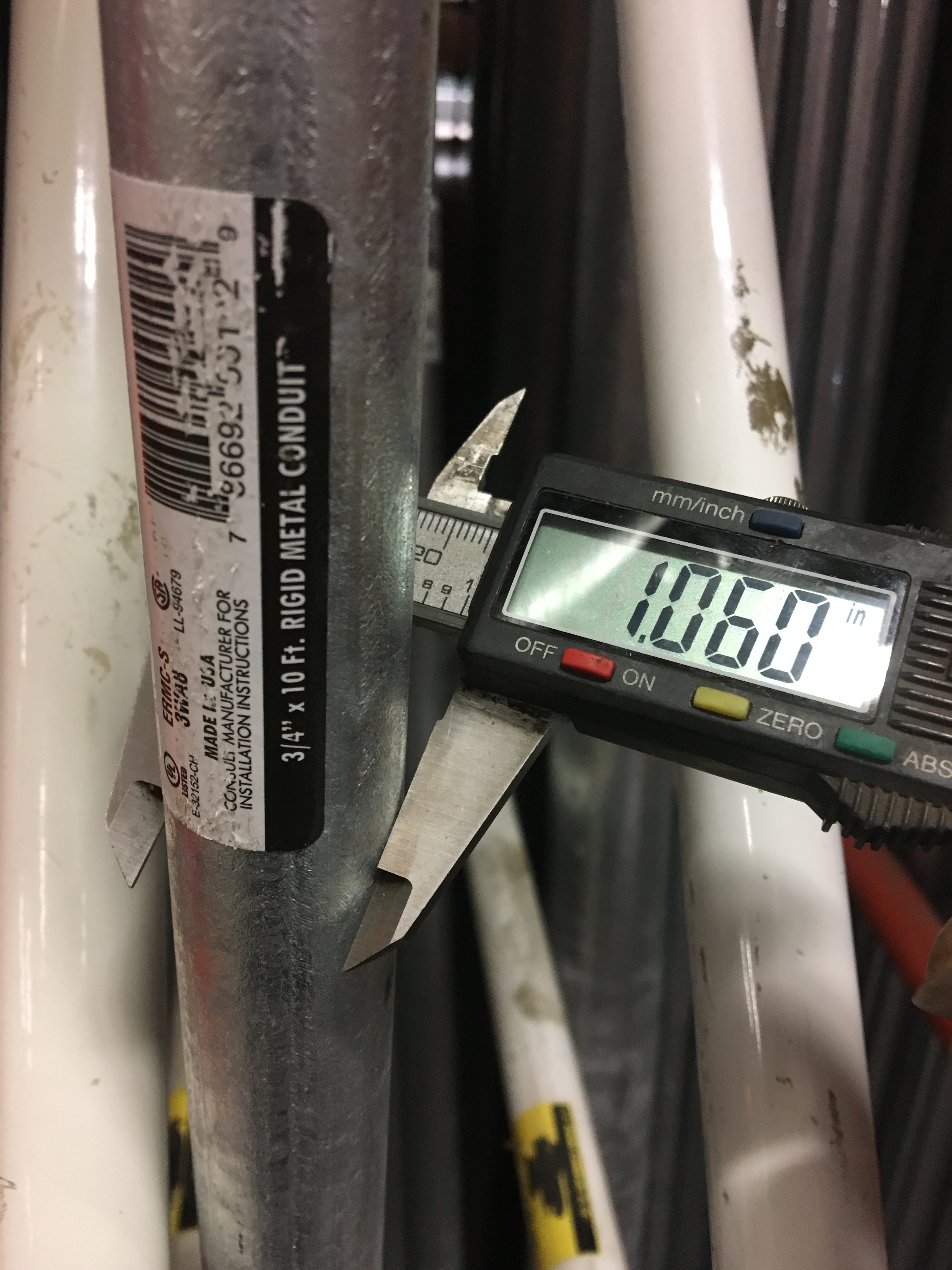

Since you’re working on the EMT version last, and scaling up is easier than down, have you considered using rigid conduit instead? 3/4" rigid is more expensive than emt (3x approximately) but significantly cheaper than stainless where I am anyway. It’s outer dimension is 26.7mm so slightly larger than your existing builds, but only slightly. 3/4" emt is 6.7lb per 10ft, and 3/4" rigid is 10.9lb, so it would add a couple lbs to the structure but double the wall thickness and increase rigidity. (0.107 in for rigid vs 0.049 in for emt)
That is a solid idea!
The surface finish on the rigid conduit i saw at home depot looked like 30 miles of bad road.
Pretty sure I have some here, I will have to take a look, pretty sure I had a few reasons not to use it.
edited to stop confusion from faulty explanation and brain disconect
3/4 pipe or HD conduit? Black pipe is the same size OD(edit as Galvanized pipe not EMT ) but smoother( edit no galvanizing ) again heavier sorry I just got confused with the order of questions
the galvanizing wears off right a way anyway so It should not be any problem
Sorry Ryan got 2 things run together
I just had a section of the 3/4 inch rigid in my hand measuring in our maintenance shop. I tossed it back as soon as I saw it was larger than I wanted.
Honestly EMT rarely looks much better. The galvanization is pretty soft and smooths out with a few cycles on the EMT, probably same for rigid. Only thing to watch for is the seam is turned away from a bearing.

+1 for black pipe, very easy to source locally from orange or blue stores, no specialty stores needed.
Not saying it would be better just easier to source but heavier than stainless I think what we have is perfectly perfect because when is enough enough?

YOU want 3/4 EMT conduit
1 inch O/D stainless 25.4 mm OD
ni the USA
or 25 mm OD in most Metric places
Someone might have already mentioned this, but an “old” MPCNC could be scavenged by using really short rails for more rigidity and small projects and the new MPCNC, being more rigid, could use your old, likely longer, rails.
