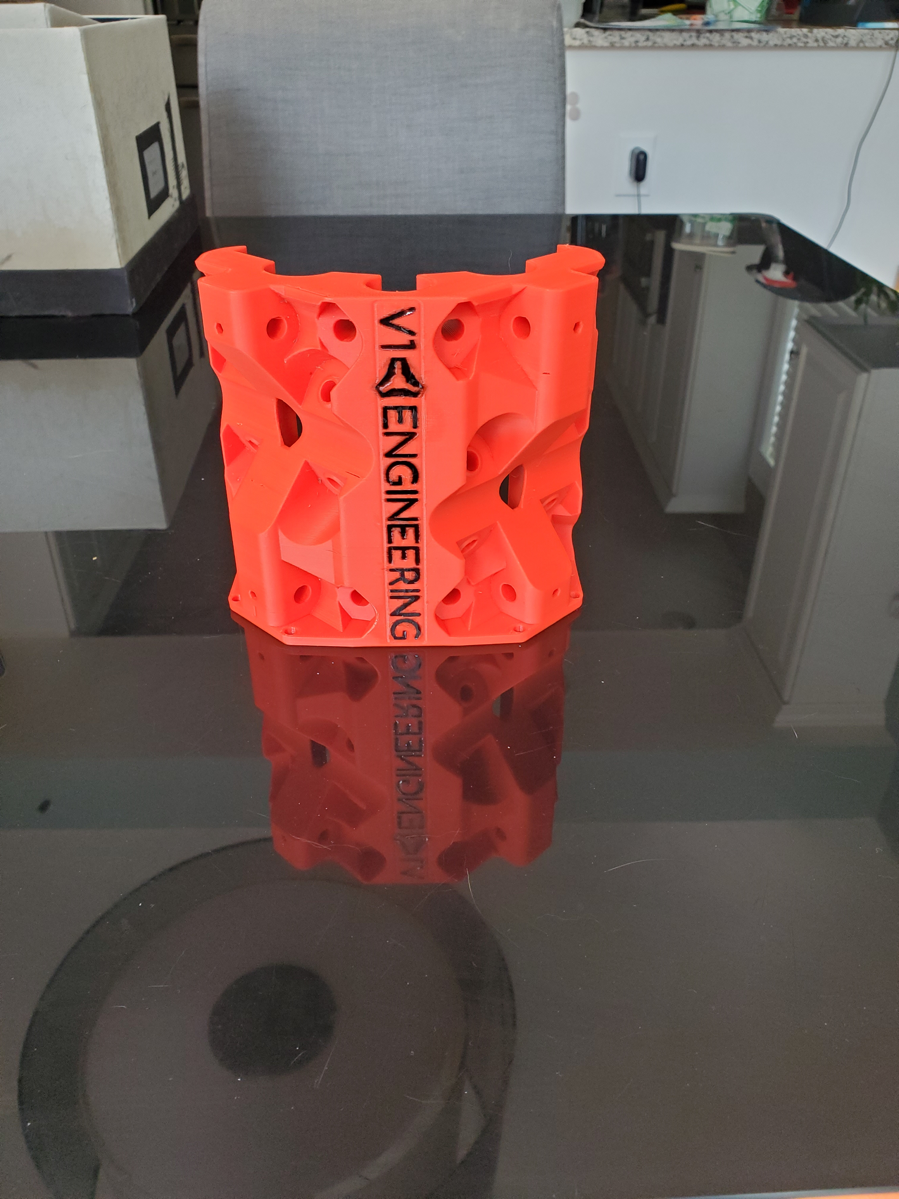

What are the chances of doing this and filling with resin/epoxy? Would make for a very stiff Core indeed!
@j1mbo That would be hard, and possible messy. They’re not always water tight. Also would probably warp from the heat.

Well I can tell you they definitely aren’t water tight or at least epoxy tight. I wanted to add a little extra to the core since it’s kinda the jewel of the whole thing and I didn’t like filament changes in it so I tried to infill the logo. When the epoxy was first mixed and thin it seeped between layers and I wasn’t very happy with the results. The middle was great then by the end it started to set up so much it was hard to work with. Kind of a fail, but once its dirty you wont notice nearly as much!
Epoxy also has an exothermic reaction when it sets, so it would probably get hot enough to melt some of the plastic.
Epoxy can be thickened with micro-balloons to keep it from seeping. Used to do this to create fillets when building boats.
